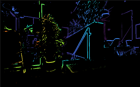

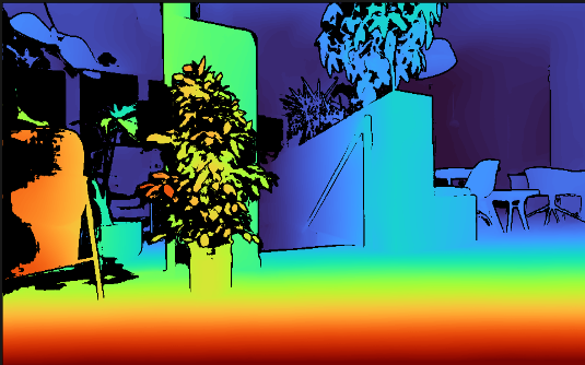

  • confidence_threshold: Filters out depth points with low confidence, primarily removing unreliable measurements around object edges. This helps prevent objects that are close together from appearing “linked” in the depth map.
  • texture_confidence_threshold: Filters out depth points in regions with low image texture (uniform or featureless areas), where depth estimation is less reliable due to insufficient visual information.
Since ZED SDK 5.6, the default confidence_threshold also removes many more of the flying pixels of the NEURAL depth modes: the “curtains” of points left floating between an object and the background, most visible behind plants, around people and around screens. A small share of the removed points were valid depth along object edges; to keep them, set confidence_threshold to 98 or above.

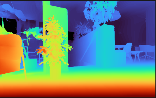

ImageOriginal Depth
RGB image of officeDepth map of office
confidence_threshold set to 50texture_confidence_threshold set to 50
Depth with confidence thresholdDepth with texture confidence threshold
