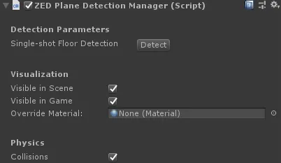

  • Add the ZEDPlaneDetectionManager component to it.
With ZEDPlaneDetectionManager in the scene, you can now click on any surface in the Game view and the plugin will instantly create a GameObject that fits that surface. You can also click the “Detect” button to make a plane representing the floor.

  • With the scene still running, select the Plane Detection Manager object, and in the Inspector, click “Detect”. The floor should turn blue.
  • Uncheck “Visible in Game” to hide the plane in the Game view.

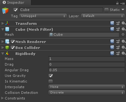

  • Add a Rigidbody component to the cube.
The Rigidbody component adds gravity. When you add it, it’ll fall down and land on your real-world floor.
