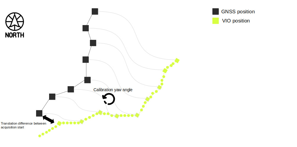

The differences between the VIO and GNSS trajectories of the same moving agent are illustrated in the following figure. It is important to note that these trajectories have different origins, highlighting the need for alignment between the VIO and GNSS systems. Please also note that synchronized GNSS / VIO data pairs are linked by a thin gray line.

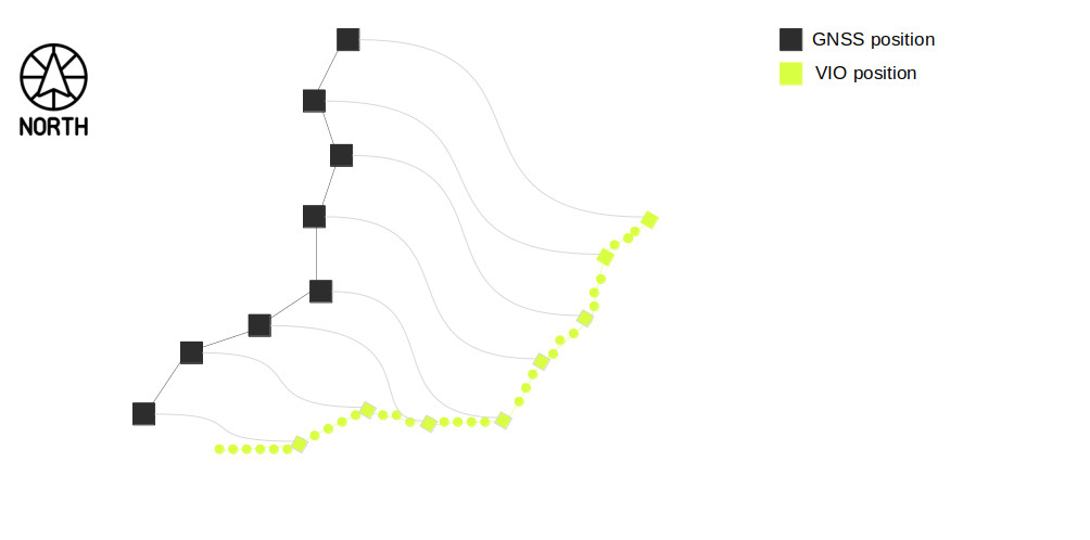

The VIO path sent for fusion is consistently aligned with gravity. As illustrated in the following figure, aligning the VIO and GNSS systems requires determining 4 parameters:
  • The yaw rotation (1 parameter) between the GNSS coordinate system and the VIO coordinate system.
  • The translation (3 parameters: X-Y-Z) difference between the start of VIO acquisition and the start of GNSS acquisition.

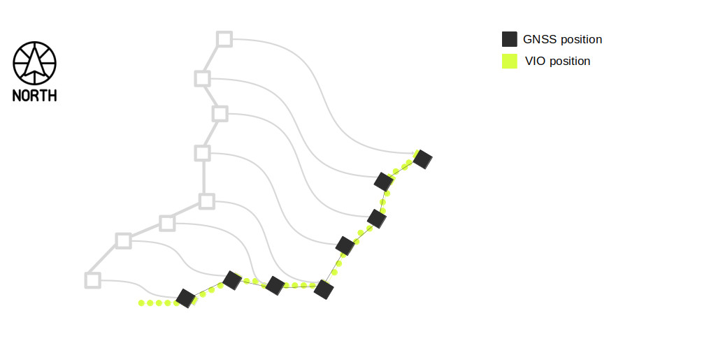

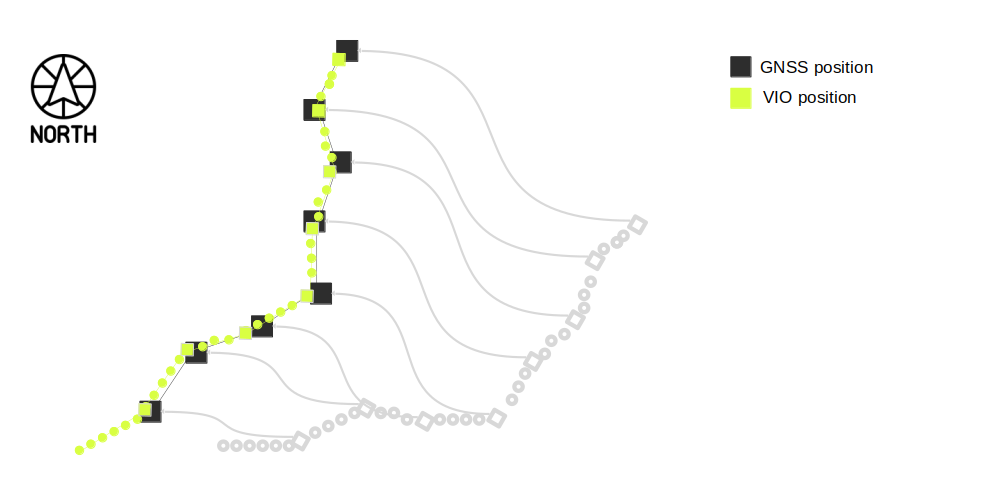

Once calibrated our fusion module is able to project the GNSS into VIO or vice versa. The left figure illustrates GNSS projected on VIO and the right figure illustrates VIO projected on GNSS.

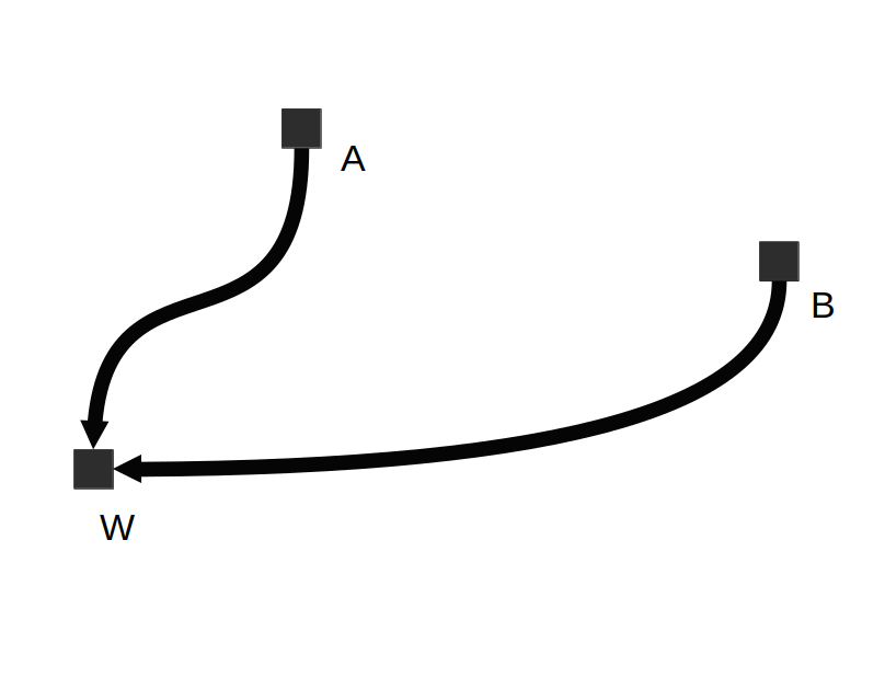

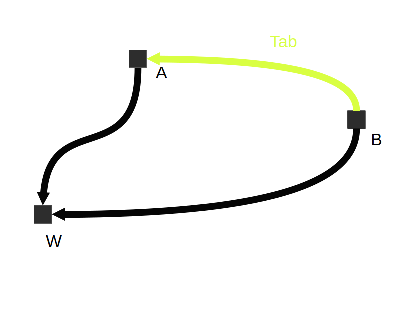

In all our schematics, the transformations are expressed in a coordinate-basis form. Let’s explain this. Let’s suppose that you have two coordinate systems A and B. The two coordinate systems can be related to each other through another coordinate system named W, as shown in the schematic below:
The transformation matrix that allows a coordinate system change between B and A can be defined as Tab = inverse(A) x B:

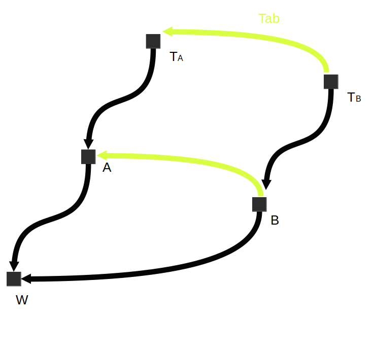

Let’s now consider a transformation expressed in coordinate system A, noted Ta, and the same transformation expressed in coordinate system B, noted Tb, following the schematic below. The link between these transformations can be noted as:
Tb=Tab1×Ta×TabT_b = T_{ab}^{-1} \times T_a \times T_{ab}
and
Ta=Tab×Tb×Tab1T_a = T_{ab} \times T_b \times T_{ab}^{-1}

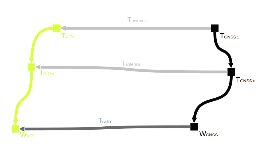

Following our definitions above, we can define the VIO and GNSS coordinate systems and establish the link between them. This is expressed in the schematic below. The Tcalib transformation is what is estimated by GNSS / VIO calibration. It can be retrieved using the getGeoTrackingCalibration method.
On the other hand, the Tantenna transformation is provided through the gnss_antenna_position parameter. If it is not specified, it will be set to identity.
With the help of the schematic above, we can define the link between GNSS and VIO:
TVIOprojectedinGNSS=Tcalib×TVIO×TantennaT_{VIO-projected-in-GNSS} = T_{calib} \times T_{VIO} \times T_{antenna} TGNSSprojectedinVIO=Tcalib1×TGNSS×TantennaT_{GNSS-projected-in-VIO} = T_{calib}^{-1} \times T_{GNSS} \times T_{antenna}

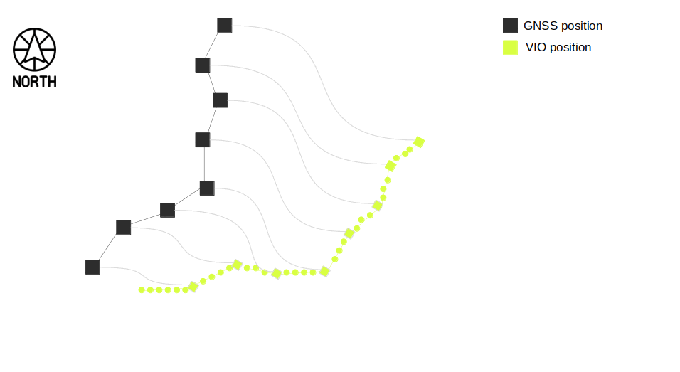

The GNSS/VIO calibration process halts based on calibration uncertainty according to stopping criteria. Put simply, calibration concludes when a significant level of confidence in the T_calib transformation is obtained. The following figure shows this principle in 2D.
