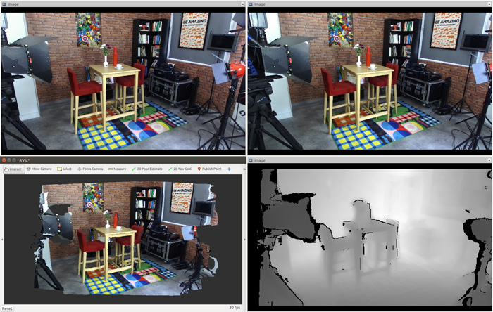

Displaying ZED data
Using RViz 2
RViz 2 is a useful visualization tool in ROS 2. With RViz 2, you can visualize the left and right images acquired by the ZED cameras, the depth image, and the 3D colored point cloud, plus other useful information.
Launch the ZED wrapper along with RViz 2 by using the following command (installing the packages included in the zed-ros2-examples repository is required):
ros2 launch zed_display_rviz2 display_zed_cam.launch.py camera_model:=<camera model>
If you haven’t yet configured your own RViz 2 interface, you can find a detailed tutorial here.
Using RViz 2 on NVIDIA® Jetson™ devices is not recommended for heavy tasks such as processing point clouds and full-resolution images; doing so may slow down the system and affect the reliability of the ZED nodes.

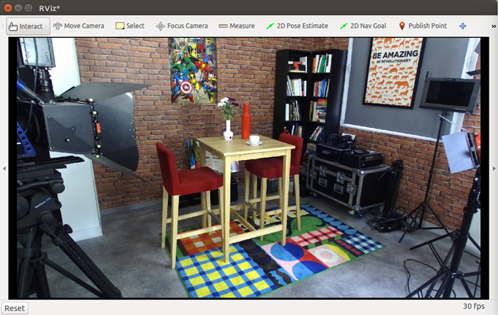

Displaying Images
The ZED node publishes both original (raw) and stereo-rectified (aligned) left and right images. In RViz 2, select a topic and use the image preview mode.
Here is a list of the main available image topics (more image topics are available):
  • rgb/color/rect/image: Color rectified image (left image by default)
  • rgb/color/raw/image: Color unrectified image (left image by default)
  • right/color/rect/image: Color rectified right image
  • right/color/raw/image: Color unrectified right image
  • left/color/rect/image: Color rectified left image
  • left/color/raw/image: Color unrectified left image
  • confidence/confidence_map: Confidence map
For a step-by-step tutorial on configuring an RViz 2 session to display only the video data you need, see Using Video Capture with ROS 2.

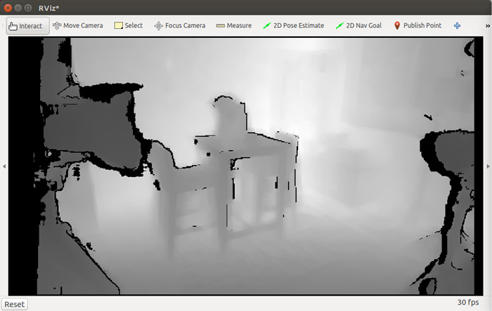

Displaying Depth
The depth map can be displayed in RViz 2 by subscribing to the following topic:
  • depth/depth_registered: 32-bit depth values in meters. RViz 2 normalizes the depth map to 8 bits and displays it as a grayscale depth image.
  • image/depth_image: Colorized depth image, for visualization only. It is published when the depth.publish_depth_image parameter is set to true (since v5.6.0 of the ROS 2 Wrapper).
An OpenNI compatibility mode is available by modifying the config/common_stereo.yaml file. Set depth.openni_depth_mode to true to get depth in millimeters with 16-bit precision, then restart the ZED node.
To learn how to fine-tune the depth and point cloud configuration and set up a dedicated RViz 2 session, see the Using Depth Perception with ROS 2 tutorial.

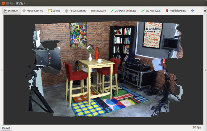

Displaying the Point cloud
A 3D colored point cloud can be displayed in RViz 2 by subscribing to the point_cloud/cloud_registered topic.
To display it, add a PointCloud2 display in RViz 2 and set its topic to point_cloud/cloud_registered.

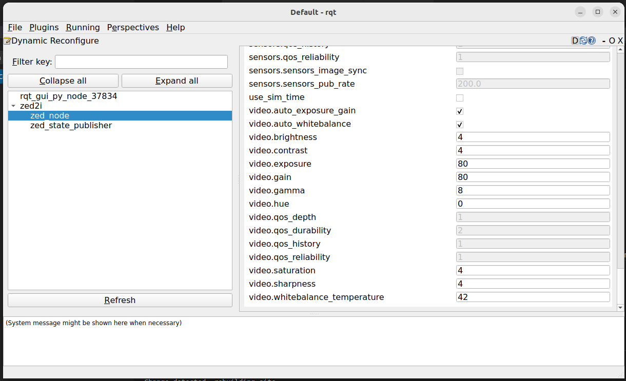

Dynamic reconfigure
You can dynamically change many configuration parameters during the execution of the ZED node. All the parameters that can be dynamically changed while the node is running are marked as [DYNAMIC] in the YAML configuration files. For a full description of each parameter please read the complete guide.
To discover which parameters the node exposes, list them first:
# List all parameters of the ZED node
ros2 param list /zed/zed_node
You can set the parameters by using the CLI command ros2 param set, e.g.:
ros2 param set /zed/zed_node depth.depth_confidence 80
If the parameter is set successfully, you will get a confirmation message:
Set parameter successful
If you try to set a parameter that’s not dynamically reconfigurable, or if you provided an invalid value, you will get this type of error:
ros2 param set /zed/zed_node depth.depth_confidence 150
Setting parameter failed: Parameter {depth.depth_confidence} doesn't comply with integer range.
You can also use a GUI to set dynamic parameter values:
rqt
select Plugins -> Configuration -> Dynamic Reconfigure

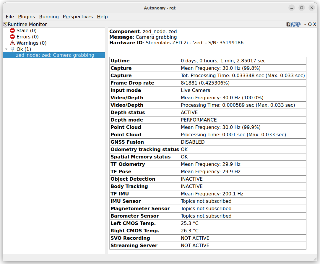

Node Diagnostics
The ZED ROS 2 node publishes useful diagnostic information aggregated into the /diagnostics topic using the diagnostic_updater package.
These diagnostics report the health and the real-time performance of the node, including the camera grabbing frequency, the processing time of each enabled module (depth, positional tracking, object detection, etc.), the publishing rate of the main topics, and the camera temperature when available. Monitoring this information is the recommended way to verify that the node is running at the expected frequency and to detect performance bottlenecks on your hardware.
Diagnostic information can be analyzed and parsed by using ROS 2 tools, like for example the Runtime Monitor plugin of rqt.
If the node is not running at the expected frequency, refer to the Stereo Node Frequency Tuning guide to learn how to balance the processing load across the modules.
