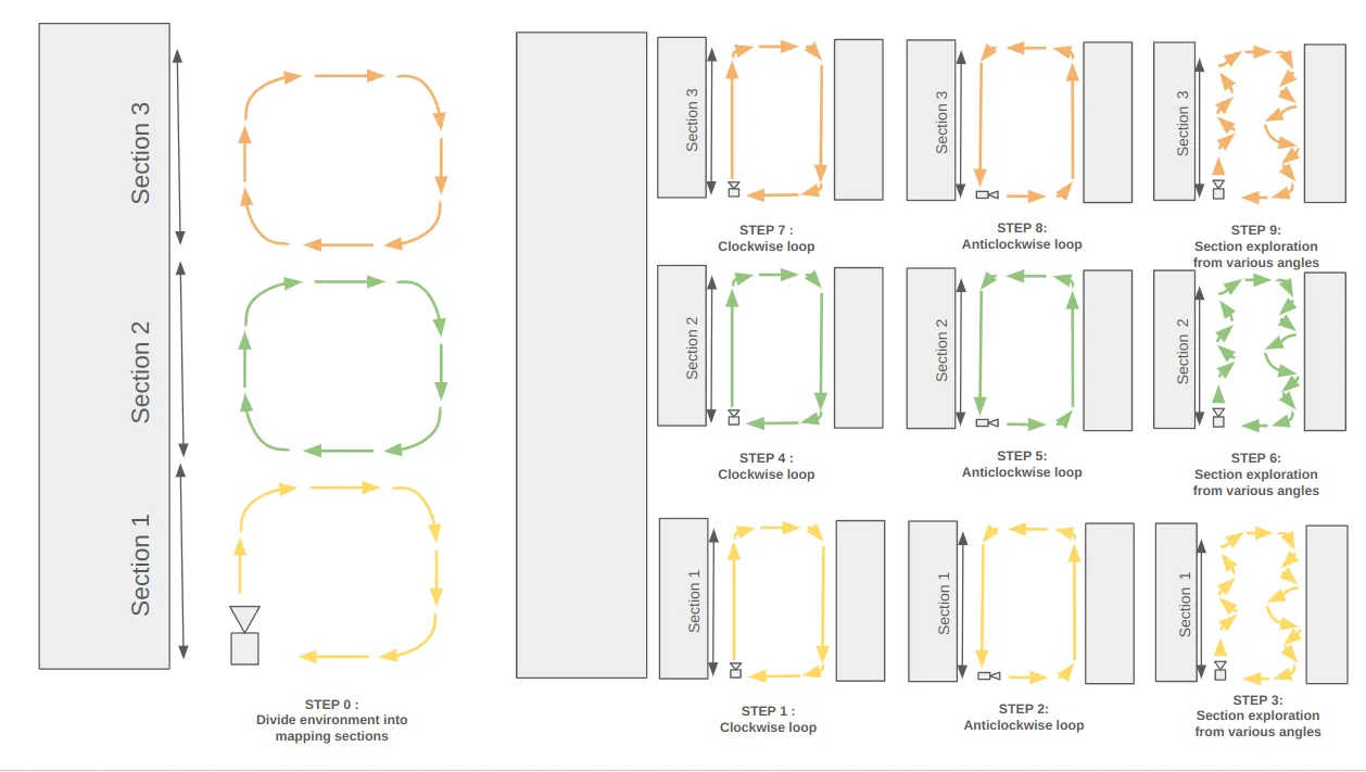

The goal is to manually move the mapping camera through the environment, ensuring it captures as much of the area as possible. As the camera moves, positional drift naturally accumulates. To counter this, it is recommended to explore the environment in successive loops, forcing the mapping trajectory to revisit previously seen regions and detect loop closures to correct the drift. Whenever a loop closure is detected, the Spatial Memory status briefly switches to LOOP_CLOSED before returning to MAP_UPDATE. This transition confirms that the system successfully recognized a previously visited location, resulting in a more accurate and consistent map.
To build the most accurate map graph possible, single-loop trajectories should not exceed roughly 20 m. As a result, large environments should be divided into several mapping sections.
For example:
  • Typical office environment: Offices can be large environments with several smaller rooms. Each room can be considered a mapping section. Large open space areas can be divided into multiple mapping sections.
  • Typical Warehouse environment: Warehouses are generally filled with narrow but long aisles. Divide each aisle into several mapping sections.
The goal is for the camera to capture as much as possible of the environment, from various angles. For each mapping section, follow the instructions below:
  • Clockwise closed loop segment - Begin at a designated starting point and proceed to examine the perimeter of the section in a clockwise loop direction, following its boundary until returning to the original position.
  • Anti-clockwise closed loop segment - From the same starting point, turn 180 degrees and examine the perimeter of the section in an anti-clockwise loop direction, following its boundary until returning to the original position.
  • Exploration from various angles - From the same starting point, explore the section and capture it from multiple angles with several turns. Make sure all the static features of the environment (e.g., tables, walls, furniture) are captured. These features will enhance relocalization within feature-rich environments. This step must be longer in featureless environments or with repetitive patterns. We recommend doubling the number of loops in such areas to help build a stronger map graph.
  • Drive to the next mapping section starting point and restart the process.
At certain times, mapping issues may temporarily reduce tracking reliability. In these cases, the Spatial Memory status may briefly switch to LOST before returning to MAP_UPDATE once tracking stabilizes or a loop closure is detected. When this happens, any accumulated drift is automatically corrected.
Example of an environment exploration with three distinct mapping sections:
