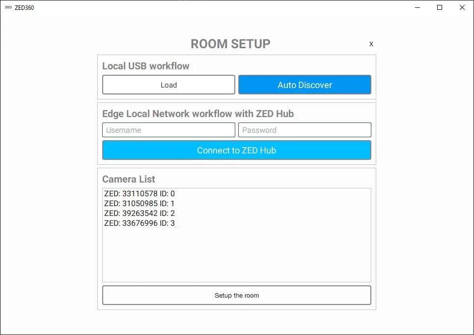

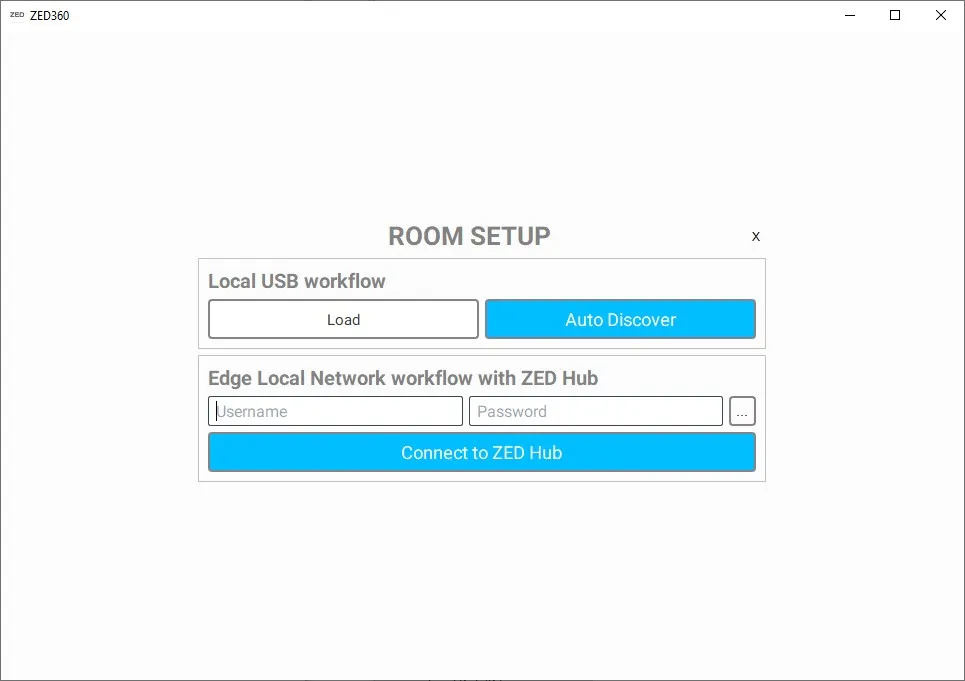

To connect your cameras with the Local Workflow in ZED360:
  • Click on Auto Discover: ZED360 will find all of the ZED cameras currently connected to the host machine. Click on Setup the room under the list to load them into ZED360.
  • Load: Load a configuration file describing your setup, see Fusion configuration files.

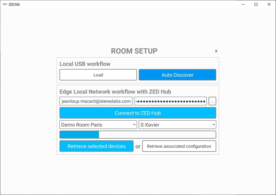

To connect your cameras with the Network Workflow:
  • Enter your ZED Hub credentials to access your ZED Hub workspaces
  • Select a workspace

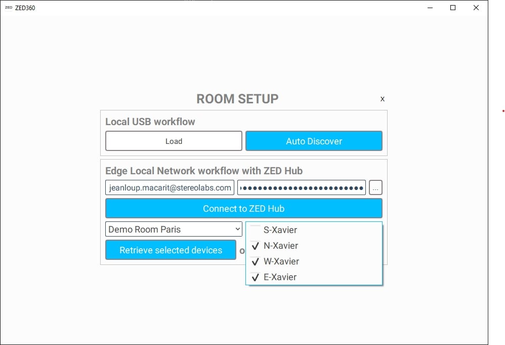

  • Select the devices to be calibrated together
  • Click on Retrieve the selected devices
    • Alternatively, if a configuration already exists for the selected workspace, it can be retrieved by clicking the “Retrieve the existing configuration” button. You can check the configuration in the next steps without starting the calibration again.

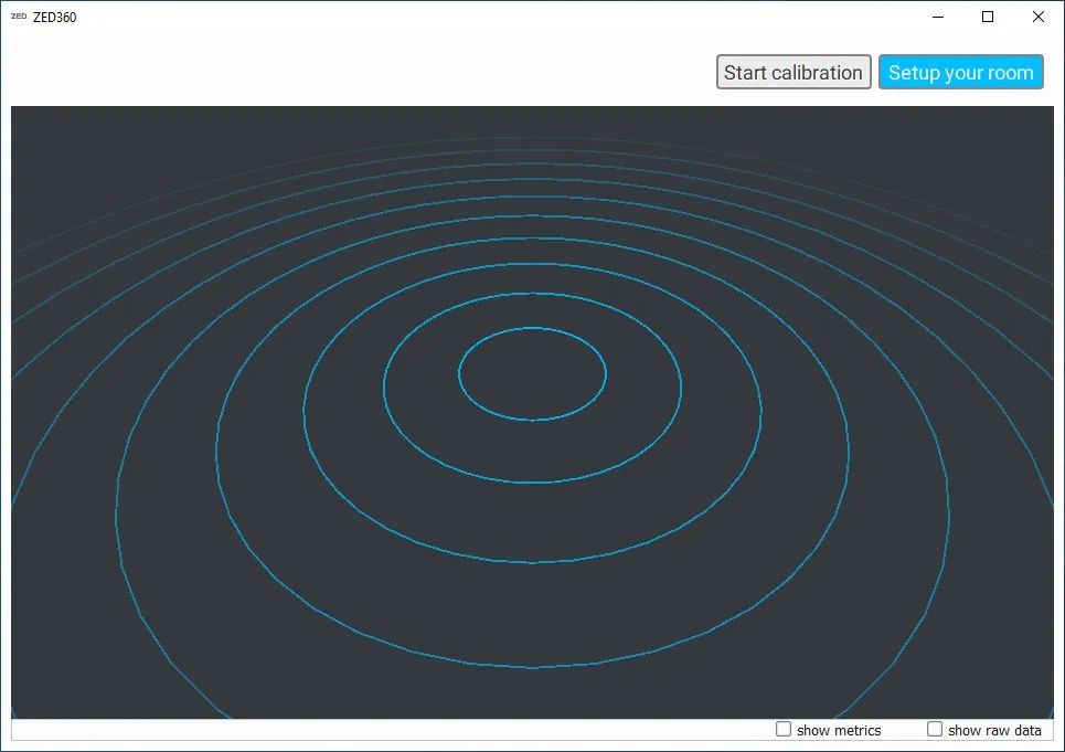

After clicking on Setup the room, you should see the cameras with their serial numbers on the screen, all positioned at the center of the scene. At this stage, only their rotation data, provided by their IMU, is visible.
Here are the main rules to process the calibration:
  • Each camera of the setup should have a minimal overlap (enough to let a person be seen at the same time by different cameras).
  • Each camera should see one and only one person at a time.
Start the calibration process
Here are step-by-step instructions for calibrating your camera array with ZED360:
  1. Begin by having a person move around the entire space of the desired area. It’s important to cover the whole space during this step, as the calibration may be inaccurate in areas where no person was detected.
  2. The person should walk slowly to allow for the iterative optimization process to run. Every ~10 seconds, an optimization loop will be performed, and you should see the cameras moving and the detected body starting to align with each other.
  3. Continue to walk across the space, as the more you move, the more optimization steps will occur, resulting in better calibration.
  4. At some point, the detected bodies should be well aligned. Once this point is reached, you can stop the calibration process by clicking on Finish calibration.
