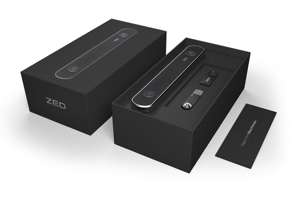

What’s in the Box?
Let’s review the items you have received:
ZED 2iZED Mini
A brand new ZED 2i Stereo cameraA brand new ZED Mini camera
A 1.5m and a 4m external USB 3.0 cable
