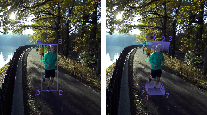

Getting 3D Bounding Boxes
Each detected object contains two bounding boxes: a 2D bounding box and a 3D bounding box. The 2D bounding box is defined in the image frame while the 3D bounding box is provided with the depth information.
The 2D bounding box is represented as four 2D points starting from the top left corner of the object. The 3D bounding box is represented by eight 3D points starting from the top left front corner, as follows:
The 2D and 3D bounding boxes are accessible in sl::ObjectData:
vector<sl::uint2> object_2Dbbox = object.bounding_box_2d; // Get the 2D bounding box of the object
vector<sl::float3> object_3Dbbox = object.bounding_box; // Get the 3D bounding box of the object
