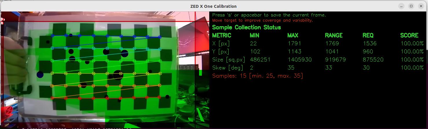

The calibration runs in two phases:
  1. Data acquisition: Move the checkerboard in front of the camera and press Spacebar or S to capture each frame. The tool enforces quality checks (sharpness, diversity) and provides real-time feedback on X/Y coverage, size range, and skew.
  2. Calibration computation: Computation triggers automatically once all metrics reach 100% with the minimum number of samples, or when the maximum sample count is reached.
When complete, the tool writes two files:
  • mono_calibration_SN<serial_number>.yml: OpenCV format containing the camera matrix (K) and distortion coefficients.
  • SN<serial_number>_mono.conf: ZED-compatible format covering all supported resolutions.

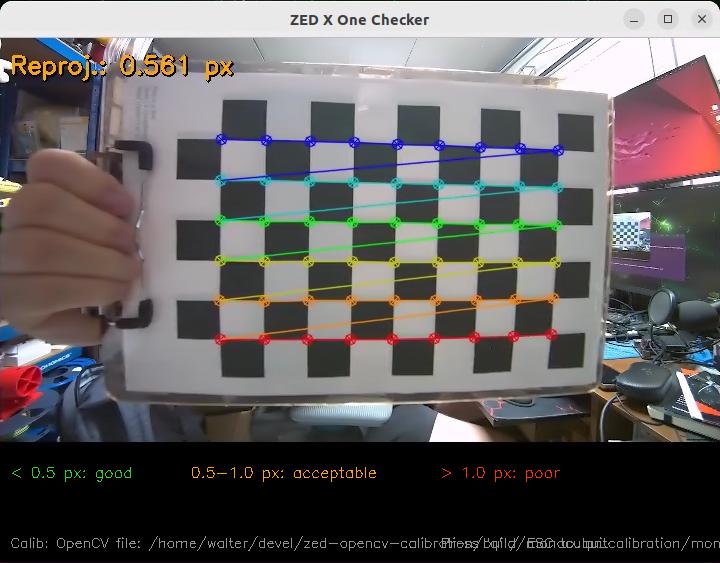

Validate the calibration with zed_mono_checker
After calibrating, use the zed_mono_checker tool to verify the result. It measures the reprojection error in real time against the detected checkerboard corners, giving you immediate feedback on calibration quality.
cd build/monocular_checker/
./zed_mono_checker
By default, the checker uses the camera’s internal calibration. To validate a specific calibration file, pass it with --calib_opencv:
./zed_mono_checker --calib_opencv mono_calibration_SN12345678.yml
The checker accepts the same camera, checkerboard, and lens parameters as the calibration tool, plus:
ParameterDescription
--calib_opencv <file>Path to a custom calibration YAML file to validate
The reprojection error is displayed and color-coded:
  • Green: below 0.5 px (good)
  • Orange: 0.5–1.0 px (acceptable)
  • Red: above 1.0 px (poor; recalibration recommended)
If the error is consistently in the red range, run zed_mono_calibration again, taking care to cover the full field of view with diverse checkerboard poses.
