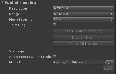

For more details on Spatial Mapping parameters, read this section. We recommend using the following set of parameters:
  • Resolution = MEDIUM
  • Range = MEDIUM
  • Filtering = LOW

  • Press the Start Spatial Mapping button to launch the mapping. Move the ZED around to capture a mesh of your environment - a blue wireframe will indicate which areas you have scanned.
  • When finished, click on Stop Spatial Mapping to stop updating the mesh and start mesh filtering.

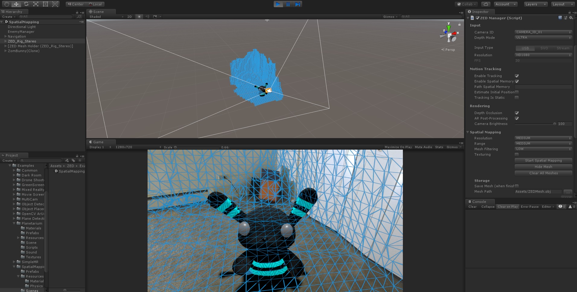

  • Play the scene, start mapping a large area and when you press Stop Spatial Mapping, the NavMesh is generated and the Bunny character appears in the scene.
The ZomBunny prefab you dragged over is set up with Unity’s NavMeshAgent script. This allows a Unity GameObject to move around a NavMesh while constrained as expected - it can only walk on flat surfaces that are wide enough for it, can walk up ramps and stairs provided they are not too steep, etc.
However, the traditional way of using NavMeshes is to create them before you run a scene. Since we’re building the NavMesh at runtime, the EnemyManager script will disable the ZomBunny at the start and re-enable it once there’s a valid NavMesh present. The ZomBunny prefab also has a custom script called NavMeshAgentController which moves it to a random location on the NavMesh once activated.

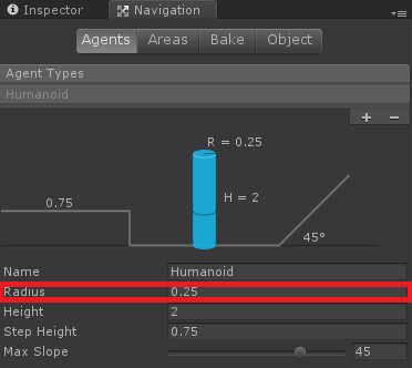

You may notice that the NavMesh is smaller than expected. This is because the default “Humanoid” agent in Unity is built for a larger creature than our bunny. We can tweak that in Unity’s Navigation window.
  • Click on Window -> AI -> Navigation
  • In the new Navigation tab, click on Agents at the top.
  • Change the Radius value from 0.5 to 0.25.
Depending on your environment, you may also wish to adjust the slope and maximum step height to allow the bunny to walk along more surfaces. Complete documentation on Unity agent parameters is available here.
