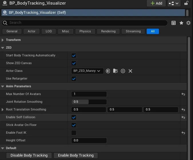

BP_BodyTracking_Visualizer
This blueprint manages the whole avataring process, from enabling body tracking to sending the skeleton data to the animation blueprint.

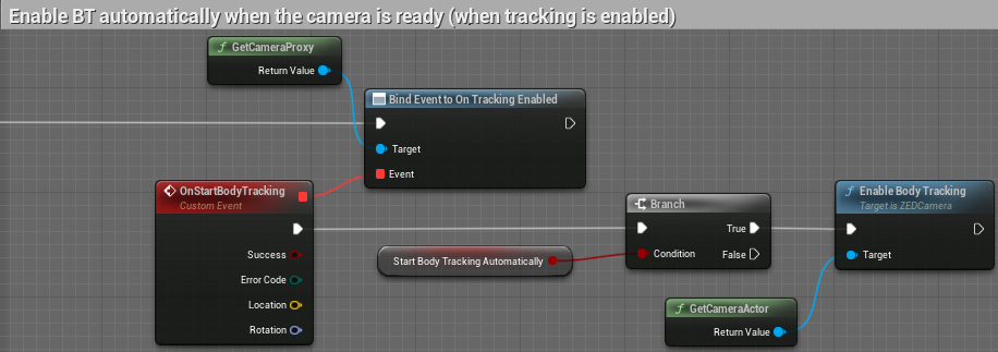

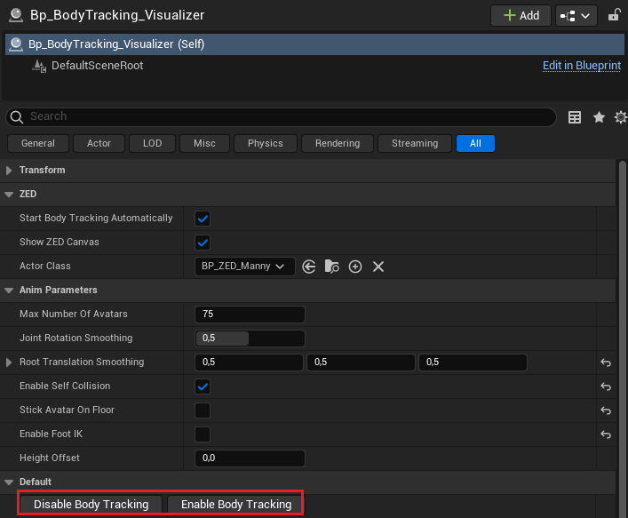

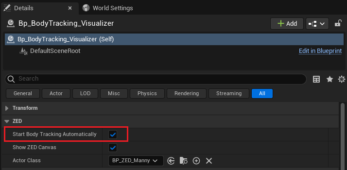

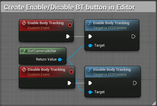

  • Enabling the Body Tracking:
  • Automatically: If the “Start Body Tracking Automatically” option is ticked, the body detection will start as soon as the ZED camera is ready.
  • Manually: If it is not ticked, it can be started in the details panel manually.

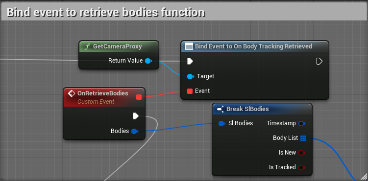

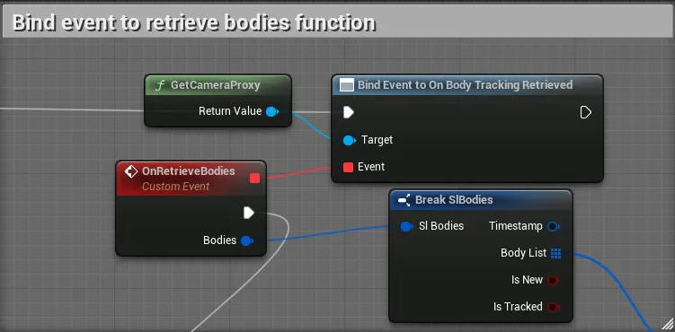

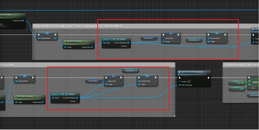

  • Watch for the retrieve bodies callback

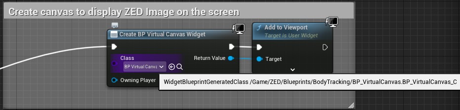

  • Put a small viewport with the image from the ZED Camera / SVO file in the main viewport.

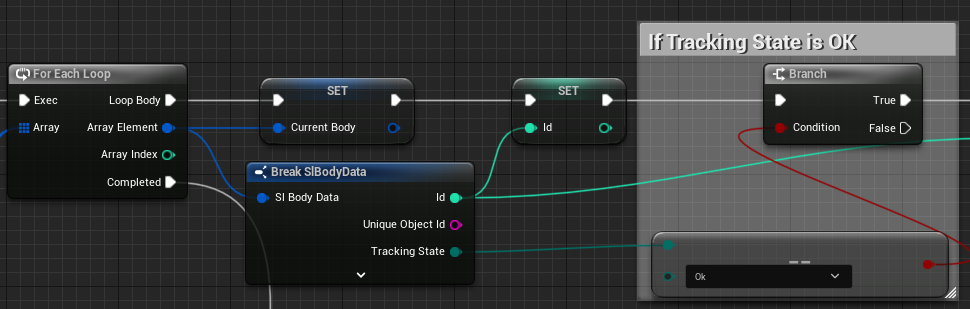

  • Loop on each retrieved body and check its tracking state.

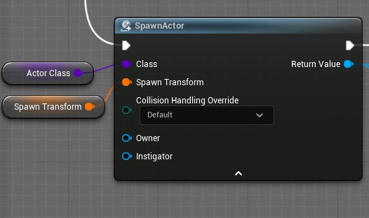

  • If it is a new detection, spawn an avatar.

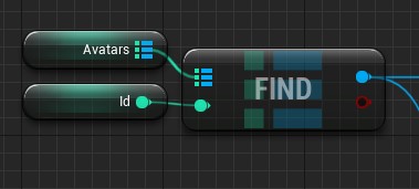

  • If it is an already tracked skeleton, find the avatar in question in the Avatars actor map.

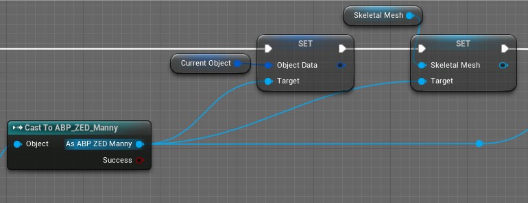

  • Set Animation Blueprint’s Body Data and Skeletal Mesh variables (see AnimNode_ZEDPose.cpp below.)

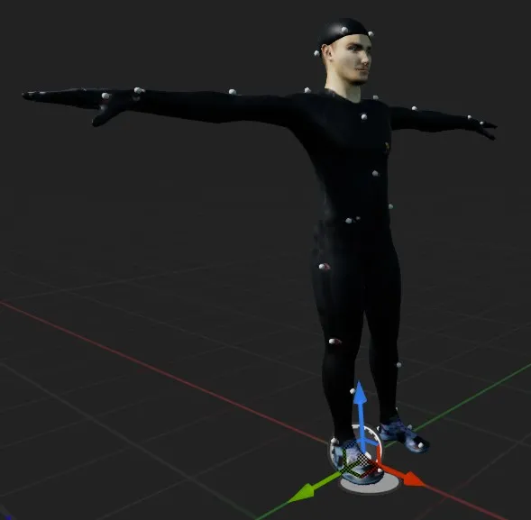

For now, the skeleton used must be in T-Pose to achieve the most accurate correspondence of the movements possible.

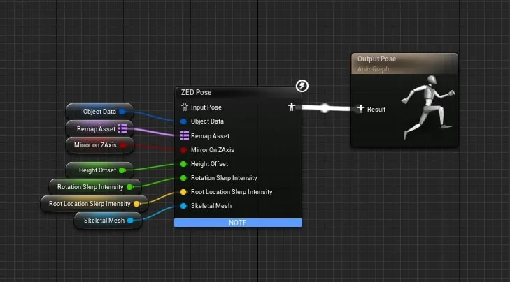

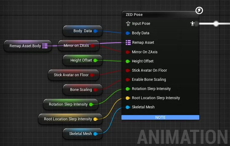

ZED Pose - Animation Blueprint node
This node is generated by the AnimNode_ZEDPose.cpp file, do not hesitate to take a peek at it. This is the core of the avataring, it applies the rotations of the bones of the SDK skeleton to the Unreal avatar bones (using the remap asset).
  • Body Data: SlBodyData structure used to retrieve the location and orientations of key points and bones from the SDK. It must be set externally (e.g. from the BP_BodyTracking_Visualizer). Explore StereolabsBaseTypes.h for more details on this structure.

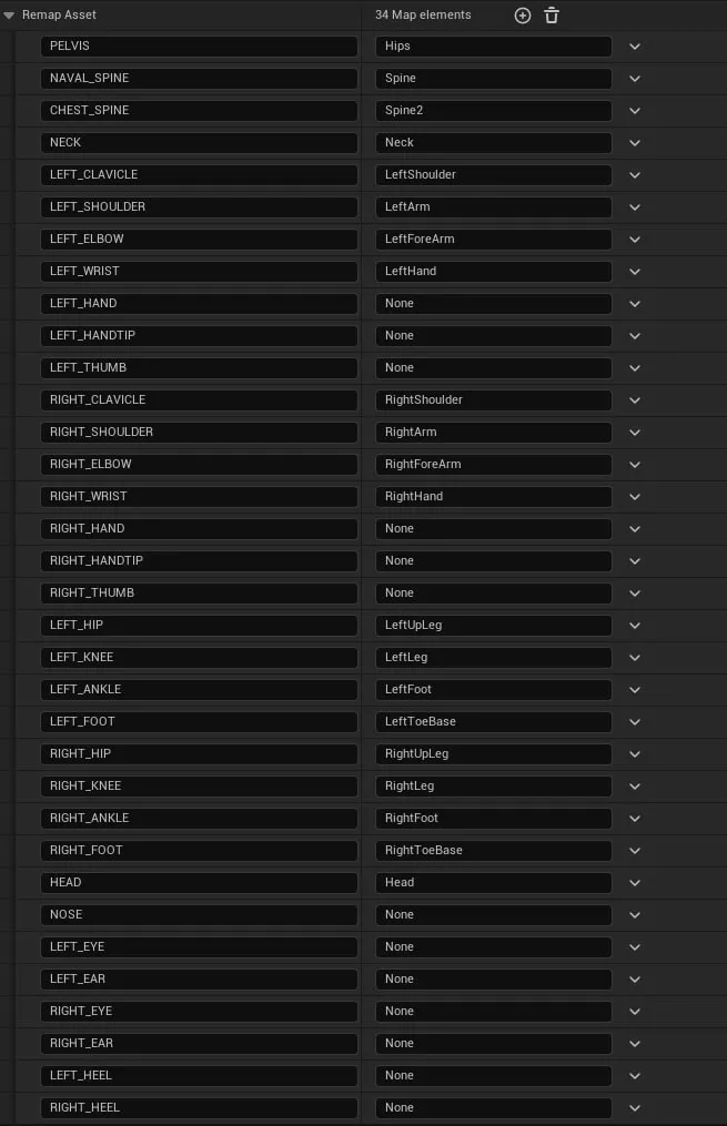

  • Remap Asset: This map of names is used to make the correspondence between the bones’ names in the SDK and the ones of the avatar.
  • Mirror on Z Axis: Enable mirror-mode for the avatar. If you raise your right hand, it will raise its left.
  • Height Offset: Can be used to apply an external offset to the character Z location (height).
  • Rotation Slerp Intensity: Intensity of the smoothing applied to the avatar movements. Adjust it to balance movement latency against jittering.
  • Root Location Lerp Intensity: Intensity of the smoothing on the location of the root of the skeleton. Used to avoid sudden displacement which can happen in case of unstable data from the camera.
  • Skeletal Mesh: Used to give the skeletal mesh to the C++ script, which then manipulates its Pose.

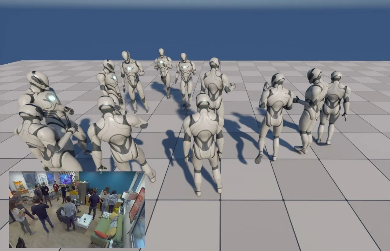

What is Body Tracking?
Body Tracking is very similar to the Object Detection module but uses another highly optimized AI model to detect people’s 3D skeletons, expressed as keypoints. It can detect up to 38 keypoints on a single person. For more details about the Body Tracking feature, please take a look at the Body Tracking documentation page.
In Unreal, we will use this 3D keypoint information (more precisely, the orientation of each keypoint) to animate a 3D humanoid avatar based on a person’s movement in real time.

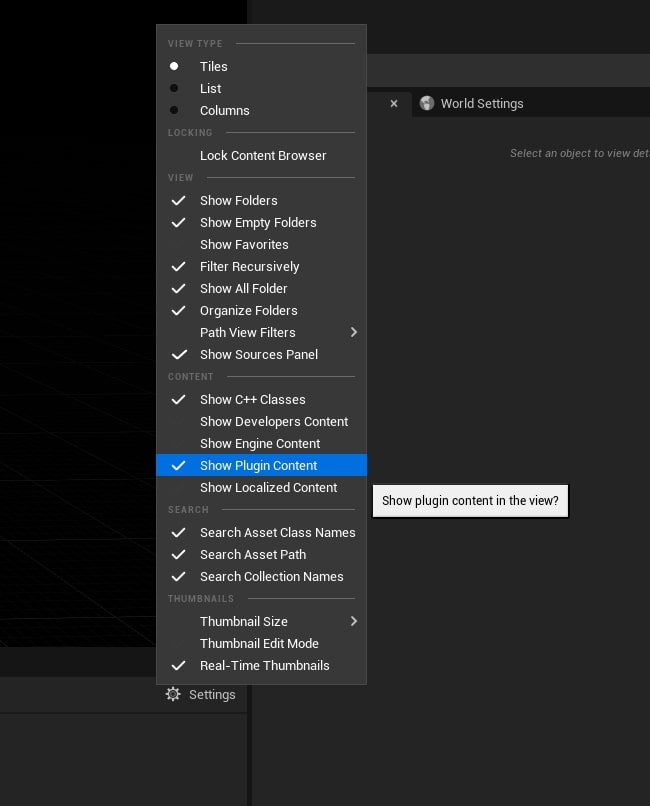

Now we’ve got to add a Blueprint from the ZED plugin. But by default, Content from plugins is hidden. To fix this, click on View Options at the bottom right of the Content Browser and enable Show Plugin Content.

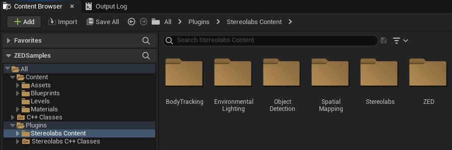

Now click on the folder icon beside Content and click on Stereolabs Content to switch to the plugin’s content folder.
In the Content Browser, go to Plugins -> Stereolabs Content -> ZED -> Blueprints and drag a BP_ZEDCamera into the scene. This is the object that sets up your camera and handles communication with your app.

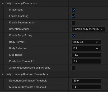

Open the ZED / Body Tracking section of the BP_ZEDCamera.
Choose the Body Tracking Model you want, depending on your accuracy/performance needs.
Three body formats are available, you can refer to the Body Tracking Documentation.
Multiple settings are available:
  • Enable Tracking: If enabled, the ZED SDK will track bodies between frames, providing more accurate data and giving access to more information, such as velocity.
  • Enable Body Fitting: The fitting process takes the history of each tracked person to deduce all missing keypoints thanks to the human kinematic constraints used by the body tracking module. It is also able to extract local rotation between a pair of neighbor bones by solving the inverse kinematic problem.
  • Body Selection: Sets the keypoints that will be given by the ZED SDK. Full: all keypoints of the body format. Upper body: Only the keypoints from the hips up (arms, head, torso)
  • Max Range: Defines an upper depth range for detections (in centimeters).
  • Prediction Timeout: Duration during which the SDK will predict the position of a lost body before its state is switched to SEARCHING.
  • Allow Reduced Precision Inference: Allows inference to run at a lower precision to improve runtime and memory usage.
  • Person Confidence Threshold: Sets the minimum confidence value for a detected person to be published. Ex: If set to 40, the ZED SDK needs to be at least 40% confident that a detected person exists.
  • Minimum Keypoint Threshold: Minimum number of detected keypoints required to consider a person detected. Can be useful to remove partially occluded detection.
  • Skeleton Smoothing: Amount of smoothing applied at the body fitting phase in the Body Tracking module of the ZED SDK. Bigger values mean more latency and smoother movements, and lower values lead to a crisper animation with less interpolation, which is better for quick movements.
Go to Stereolabs Content -> Samples -> Blueprints -> BodyTracking and add BP_BodyTracking_Visualizer into the scene as well. This object will manage the avataring of the 3D models in the scene.
Body Tracking Visualizer Settings
Use Retargeter
Check this if you’re using a retargeted avatar. It prevents the base avatar from becoming visible during the animation.
Max Number of Avatars
This setting allows you to choose the maximum number of avatars that will be spawned in the scene.
Movement Smoothing
These are interpolation values used to smooth the rotations of the limbs. The default values allow filtering the occasional jittering that can occur in the SVO data when the target is standing still.
Enable Self-Collision
This setting allows the virtual limbs to collide with the virtual body. This prevents the arms/legs from passing through the chest or each other. This feature uses the colliders provided by the Physics Assets corresponding to the skeleton.
Stick Avatar On Floor
If this is enabled, a dynamic height offset will be applied to the avatar to stick the lower foot on top of the ground in the virtual scene.
Enable Foot IK
This setting allows the Control Rig in the ABP_ZED_Manny to take effect and compensate for small gaps between the feet and the floor when the feet are near the floor, effectively sticking them in place.
In the current version, if Stick Avatar On Floor is enabled, the Foot IK will not be applied. Using both together leads to undesired behavior like the avatar crouching more and more over time. If you want to experiment with this or just enable both, you can modify the check in the animation blueprint ABP_ZED_Manny.
Height Offset
This value is applied as a flat height offset to the skeletons managed by the AnimZEDPose node.
Unexpected behavior can occur if “Stick Avatar On Floor” is ticked, as “Height Offset” is a manual solution to fix a floor detection issue, when “Stick Avatar On Floor” is the automatic counterpart.

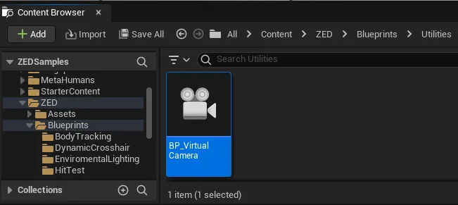

Changing the Camera point of view
By default in the scene, the virtual camera will follow the ZED camera’s position and orientation. However, in some cases, you may want to see the scene from a different point of view.
For that, add a BP_VirtualCamera actor in the scene. This camera will automatically be set as the main camera at the start.

The first step is to import your rigged mesh into Unreal. If you can, import a character in T-Pose, facing X, or tick “Force Front X Axis” in the import options. The full process to import a mesh is described above.
Having the avatar face X and be in T-Pose is not mandatory, as the pose will be adjusted later in the retargeting process anyway. However, it does make the setup process easier.

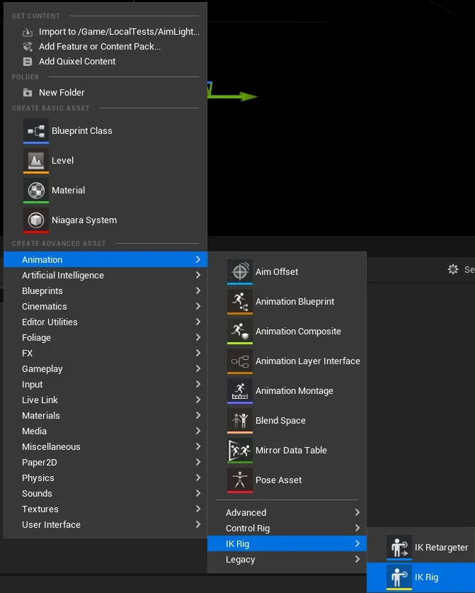

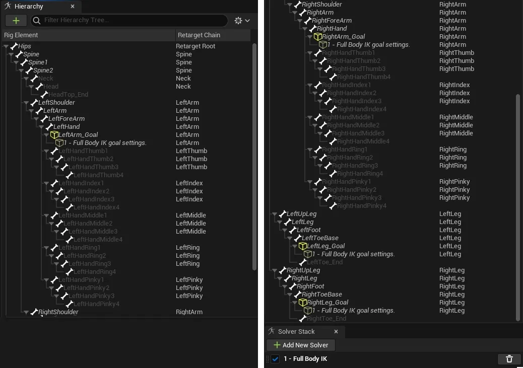

Create an IK Rig

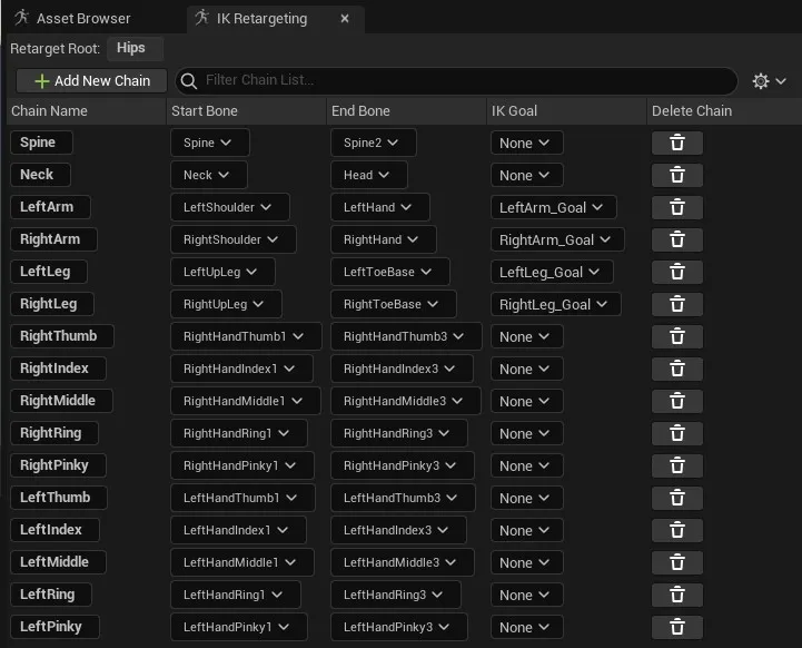

Once the new avatar is imported, create an IK Rig targeting its skeletal mesh.
The ZED avatar uses the Mixamo rig. The Retarget Chains of the new avatar should match the ZED’s ones as closely as possible:
  • Spine: from the pelvis to the upper torso. Do not include the Retarget Root bone.
  • Neck: from the neck to the head bone (not the top of the head)
  • LeftArm/RightArm: from the clavicle to the wrist
  • LeftLeg/RightLeg: from the hip to the bottom of the foot
  • Left/RightThumb, Index, Middle, Ring, Pinky: from the base of the finger to the last phalange. Do not include the tip of the finger or the metacarpal.
image image

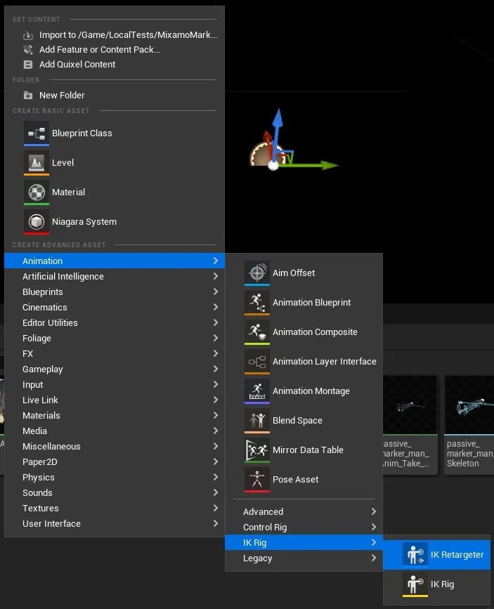

Setup of the retargeter
Create an IK Retargeter from the ZED avatar.

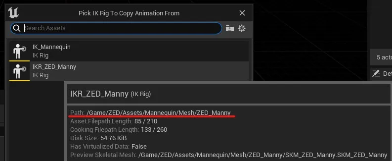

Choose IKR_ZED_Manny as the source IK Rig. If it does not exist in your project, create it first from the SKM_ZED_Manny skeletal mesh located in Stereolabs Content/Samples/Assets/Mannequin/Mesh/ZED_Manny, following the same procedure as for your custom mesh.

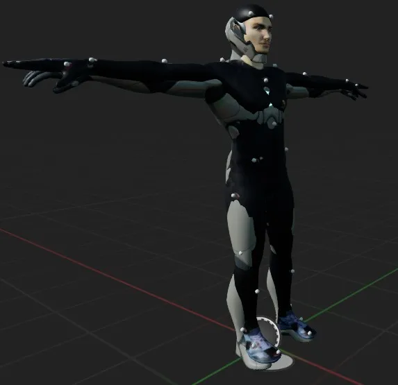

Correct the pose of the new avatar to match the one of the ZED Avatar.
You can test the accuracy of the retargeting and adjust the retargeter settings by playing any Mixamo animation.

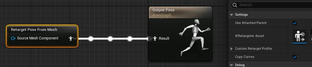

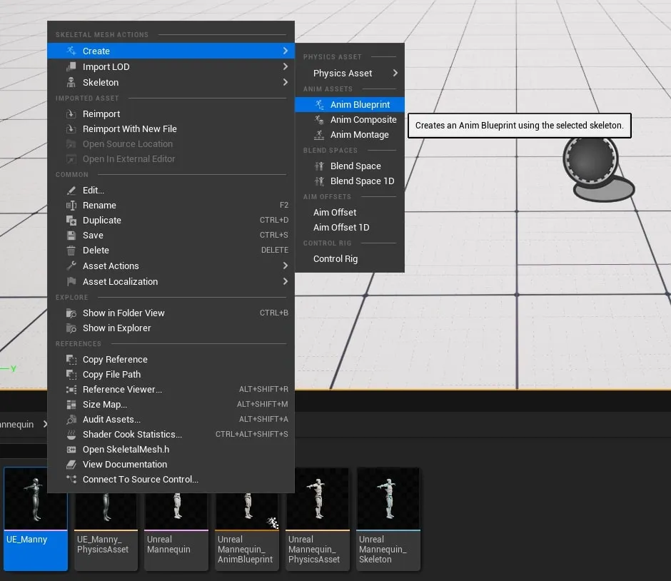

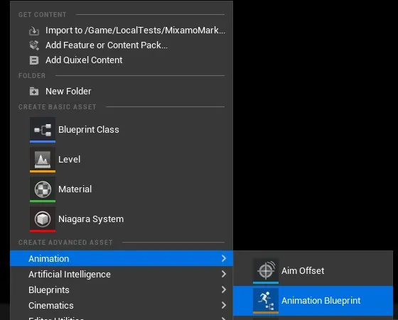

Create an animation blueprint
The creation of the animation blueprint to make the new avatar move should be fairly simple. First, create an animation blueprint targeting the skeleton of the new avatar.
Add a Retarget Pose From Mesh node, referencing the IK Retargeter created above. The “Source Mesh Component” can be left empty, as the new avatar’s mesh will be a child of the ZED avatar’s mesh. However, ensure that the “Use Attached Parent” option is ticked in the node Details.

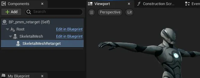

Create an actor
Create a child actor to BP_ZED_Manny, the ZED avatar. Add a child “Skeletal Mesh Component” to its Skeletal Mesh Component.
Set the mesh of this child to the mesh of the new avatar, and the Anim Class to the one just created. Check that the meshes overlap correctly, then set the “Visible” setting of the parent mesh to false and ensure that Visibility Based Anim Tick Option is set to “Always Tick Pose and Refresh Bones” on the parent mesh.

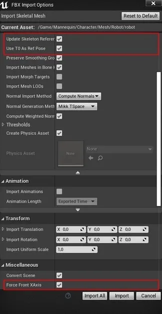

  6. Import to Unreal, checking the following settings:
    • Skeletal Mesh
    • Convert Scene
    • Force Front XAxis
    • If you’re using a T-Pose which is not the rest pose of your rig (e.g. from Mixamo):
      • Update Skeleton Reference Pose
      • Use T0 As Ref Pose
Creating an Animation Blueprint
Once you imported the avatar, the next thing to do is to create an Animation Blueprint. For that, Right click on the Skeletal Mesh you just imported, and select Create -> Anim Blueprint.
Now, you need to configure this Anim Blueprint to receive the skeleton data from the ZED SDK and to apply it correctly onto the avatar.
  • Open the Anim blueprint and add a ZED Pose component.
  • Create a variable for each input of this component and link it to the Output Pose node.
Setting up the Remap Asset
Your avatar’s joints probably don’t have the same names as the ones given by our plugin. The Remap Asset variable is used to match the joints from the ZED SDK with the joints of your avatar, exactly as the Live Link Remap asset.
  • Select the Remap Asset variable and, for each of the joints from the ZED SDK, add its matching name from your avatar.
For example, “LEFT_SHOULDER” is mapped to “LeftForeArm”, or “LEFT_KNEE” to “LeftLeg”.

Setting up the Body Tracking Manager
Now, you need to configure the Body Tracking Manager so it will create a new instance of your Actor blueprint for each new detection in the scene and share the keypoint data with its anim blueprint.
  • Click on Edit BP_BodyTracking_Visualizer in the world hierarchy
  • In the Event Graph, modify the parts of the blueprint highlighted in the following screenshot with your own Instance of AnimBlueprint.
  • It will share the skeleton data from the ZED SDK to the ZED Pose node of the Anim blueprint for preprocessing.
  • Then, the preprocessed data will be used to animate your Avatar in real time.
Run the Scene
After a short initialization period, the app will pause for a few seconds as the body tracking module loads.
Once it does, you should see an Avatar imitating your movements in real time.
To see a similar scene already built, check out the L_BodyTrackingSingle and L_BodyTrackingMulti levels. There are also plenty of other scenes for getting started that will show you the basics of camera tracking, spatial mapping and more.
