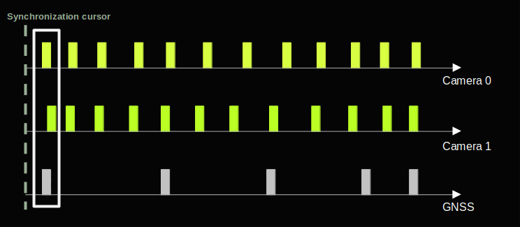

The fusion process involves synchronizing data from multiple ZED cameras and GNSS for accurate processing. In order to achieve this, it is necessary to group together data with closely matched timestamps. The diagram below shows sample data that needs synchronization. Each colored bar represents data that needs to be synchronized.
Then synchronization is performed by grouping data together based on the provided timestamp. Data are synchronized based on the current synchronization cursor. The figure below illustrates this:

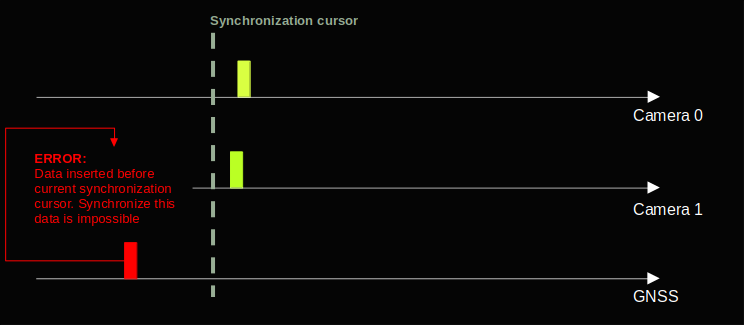

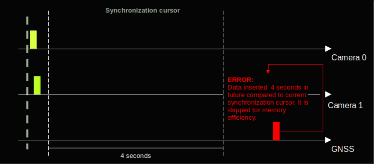

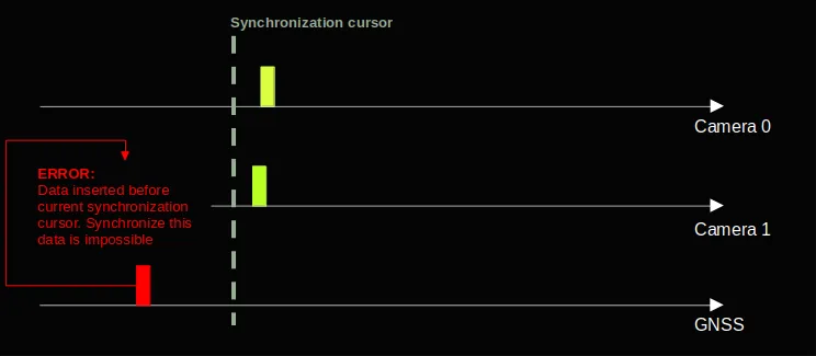

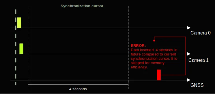

The error INVALID_TIMESTAMP happens when your ingested data timestamp is invalid. Especially, this error happens when:
  • The ingested data timestamp is equal to zero (field not set).
  • The ingested data timestamp is in the past, as illustrated below:
  • The ingested data timestamp is far from the current synchronization cursor, as illustrated below:

The fusion will ignore this data since it could not be synchronized. To resolve this, please check your sl::GNSSData timestamp before ingesting it. The current synchronization cursor timestamp can be retrieved using the getCurrentTimeStamp method of sl::Fusion.
