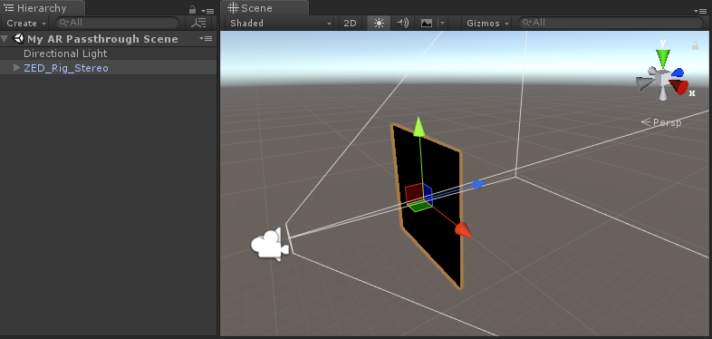

Add the Stereo Rig
  • Follow the steps described in the Build Your First AR/MR App tutorial.
  • In your Hierarchy, delete the ZED_Rig_Mono prefab you added in the last tutorial.
  • In the Project window, go to the Packages -> ZED SDK -> Prefabs folder. Click and drag the ZED_Rig_Stereo prefab into the Hierarchy window.

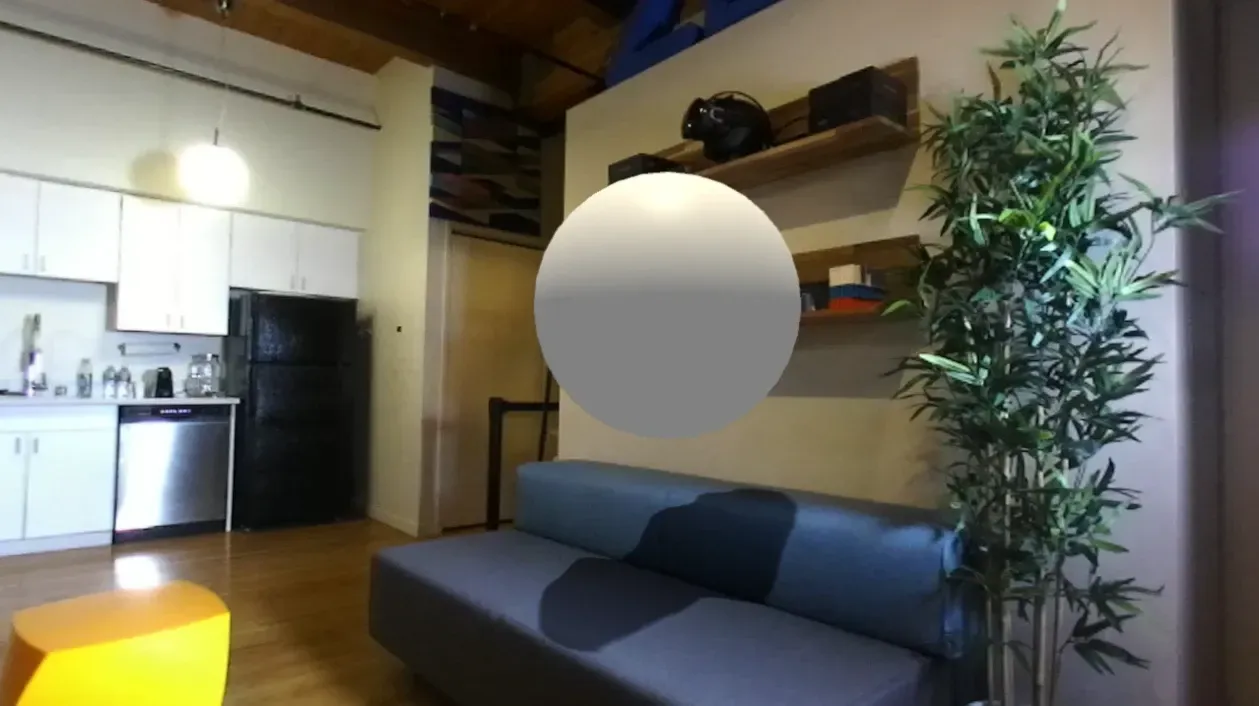

Run the Scene
Run the scene and put on your headset. Take a look at the sphere and the shadow beneath it. Walk around it, put your hand over and under it. You can also move the sphere in the Scene window and watch it fly across your room. You’ve built your first ZED Mini AR app!
