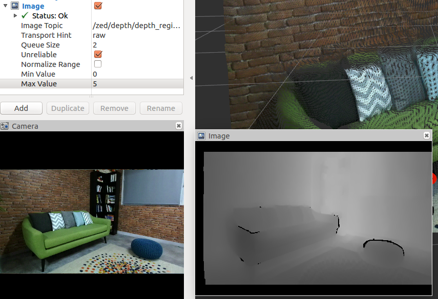

Depth image
To visualize a depth image, you can use the simple Image plugin since the depth data are published on topics of type sensor_msgs/Image (see Video with RViz). It differs from a “normal” image in that the data is encoded in 32-bit (floating point) not 8-bit.
RViz Depth
The parameters are the same as for Image, with three additions:
  • Normalize range: Since a floating point image is not directly rendered, it is converted to an 8-bit grayscale image. Enabling this field means the normalization range is automatically calculated
  • Min value: If Normalize range is unchecked, you can manually set the minimum depth range in meters
  • Max value: If Normalize range is unchecked, you can manually set the maximum depth range in meters
Manually setting the normalization range is useful if you know the maximum value measured for the depth and you want to keep the image scale static.

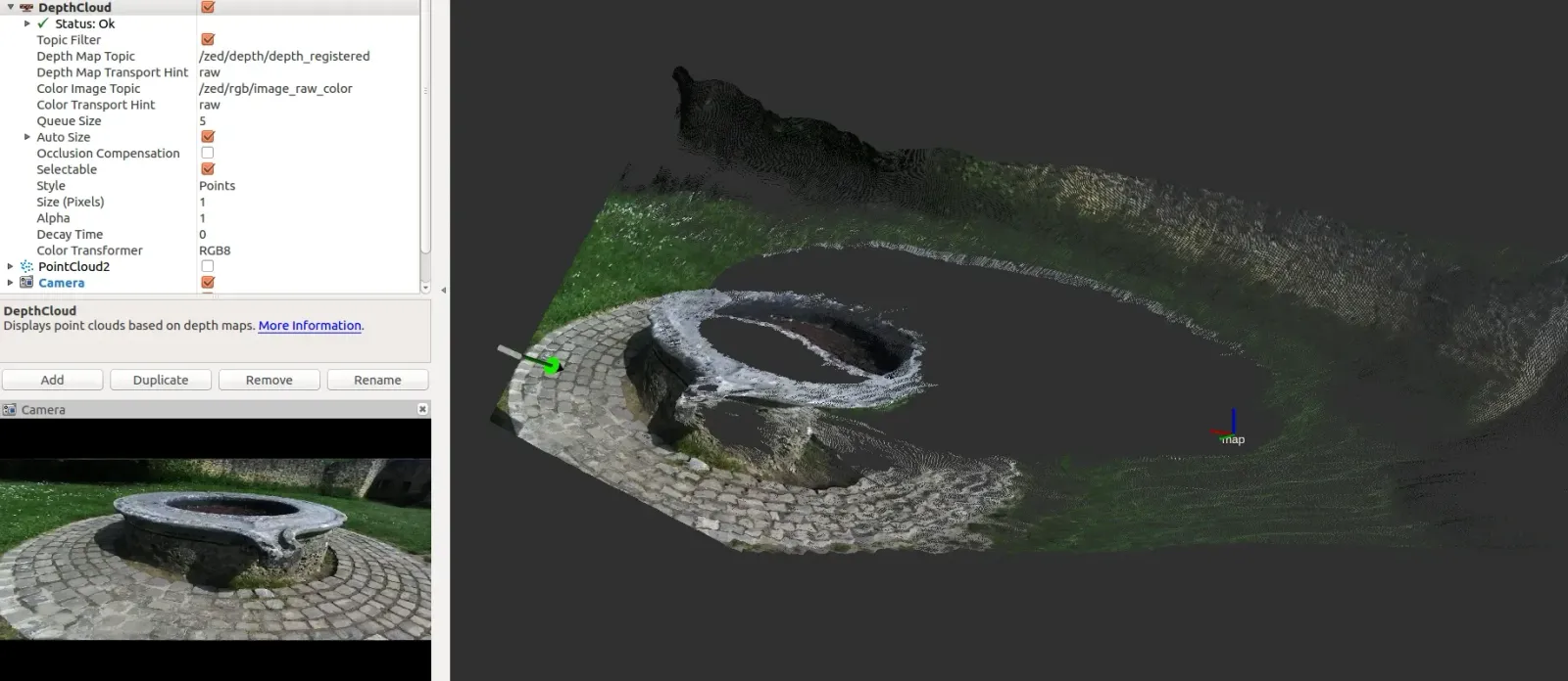

Depth cloud
The Depth Cloud plugin is the first method to visualize the registered point cloud generated by the Depth and Video data streams. This plugin takes a depth image and an RGB image (both published in the same frame_id) and automatically generates a 3D RGB point cloud.
Depth Cloud
Key parameters:
  • Depth map topic: Selects the depth image topic to visualize from the list of available images in the combo box (check Topic filter to select only image topics with a name that recalls a depth image)
  • Color image topic: Selects the RGB image topic to associate with the depth image from the list of available images in the combo box
  • Style: The style used to render each point. Use Points and Size=1 to maximize FPS
  • Color transformer: Selects how points are colored. Use RGB8 to match the color image pixels to the corresponding depth pixels. Use Axis color to use a color proportional to the value of the Axis value (e.g. Z to use a color scale proportional to the distance from the floor or X to use a color proportional to the distance from the camera)

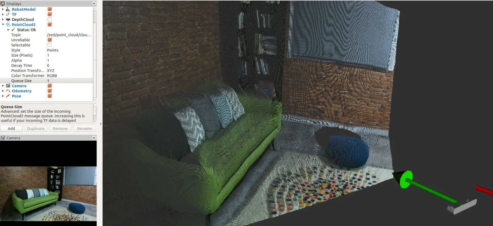

Pointcloud
To directly visualize a topic of type sensor_msgs/PointCloud2 you can use the PointCloud2 plugin.
Point Cloud
Key parameters:
  • Topic: Selects the topic to visualize from the list of available point cloud messages
  • Unreliable: Check this option to reduce the bandwidth required to subscribe to pointcloud2 topics. The subscriber will use the UDP protocol and will receive messages according to the available bandwidth
You can change the rendering style and the color transformer as explained above for the Depth Cloud plugin.
If mapping is enabled (see the mapping/mapping_enabled parameter), the PointCloud2 plugin is also used to visualize the fused point cloud produced by the mapping process, by subscribing to the topic /zed/zed_node/mapping/fused_cloud.

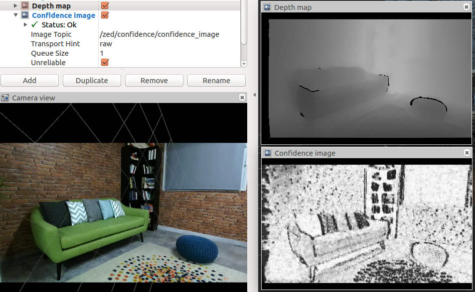

Confidence
To visualize the Confidence Map as an image, you can use the Image plugin subscribing to the topic /zed/zed_node/confidence/confidence_map.
Confidence
The confidence values range from 0 (high confidence) to 100 (low confidence): the lighter a pixel, the less reliable its corresponding depth value is.

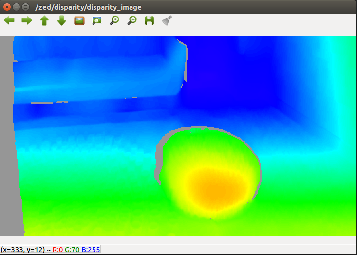

Disparity
A plugin for RViz to visualize a disparity message on the topic of type stereo_msgs/Disparity is not available, but you can use the disparity_view node available in the image_view package.
Launch the Disparity Viewer to visualize the disparity image that is published on the topic /zed/zed_node/disparity/disparity_image:
rosrun image_view disparity_view image:=/zed/zed_node/disparity/disparity_image
