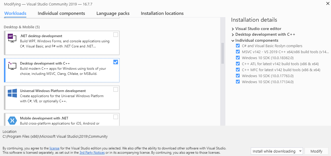

On Windows, building an application with the ZED SDK requires CMake 3.5.0 or higher and Visual Studio 2019 or 2022 (the ZED SDK requires a C++17 compiler since version 5.1). Applications must be compiled for 64-bit.
When installing Visual Studio, make sure to select the Visual C++ option.

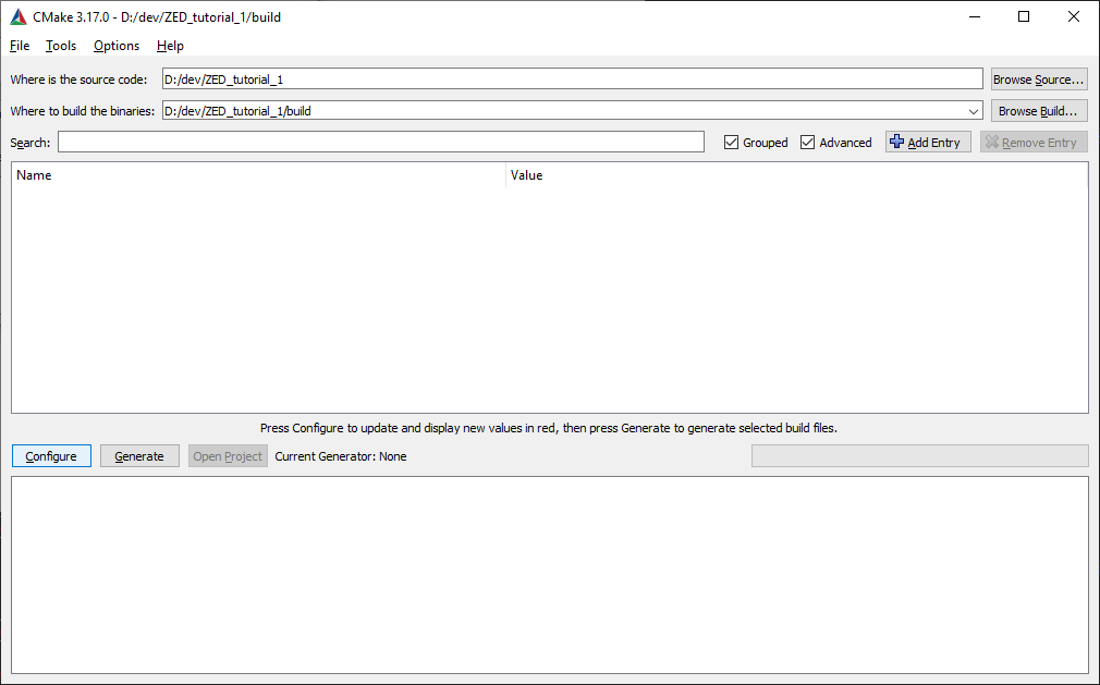

  • Open cmake-gui.
  • In “Where is the source code“, enter the path of the project folder where the CMakeLists.txt is located. Here we created a project folder “ZED_Tutorial_1” in Documents.
  • In “Where to build the binaries“, enter the previous path and add: /build.

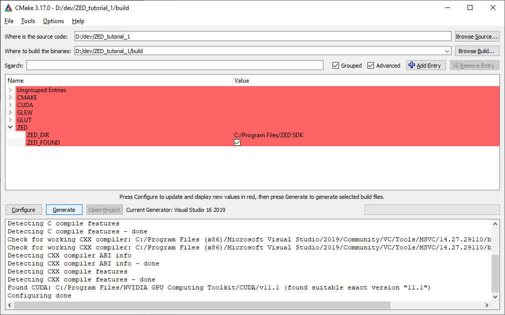

  • Click on [Configure].
  • A dialog window asks you if CMake can create the “build” folder. Say yes.

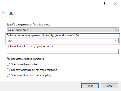

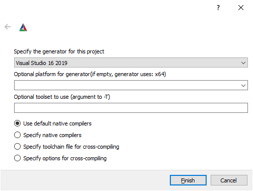

  • Another dialog window will ask you to specify a generator for your project. Choose Visual Studio in Win64 and click on [Finish].
CMake needs to define the target platform as x64. On newer versions it is set by default; if not, you can set it manually.
  • CMake may take a few seconds to configure the project.
  • Click on [Generate] to build the Visual Studio project files.

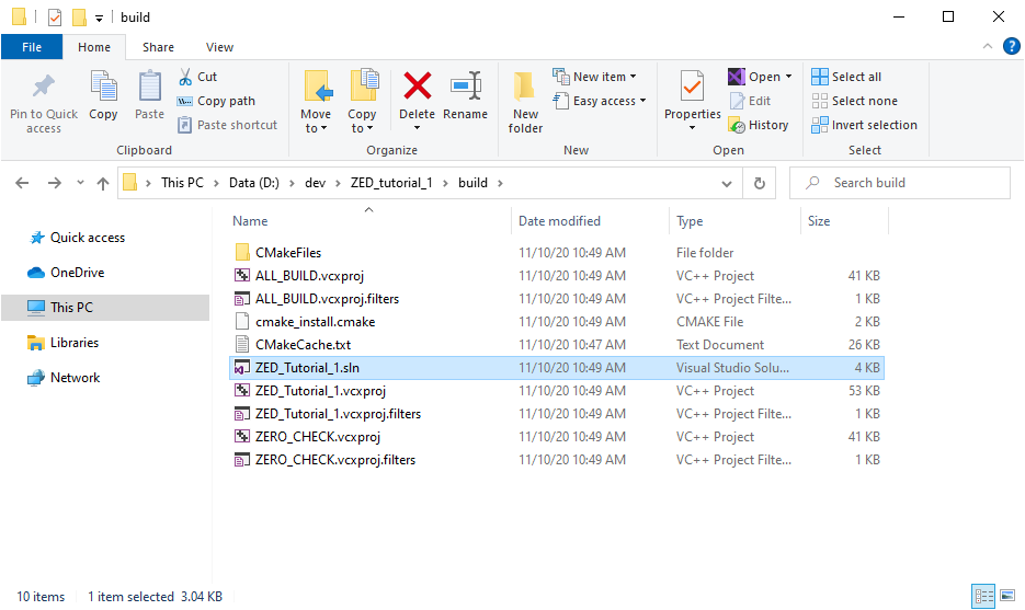

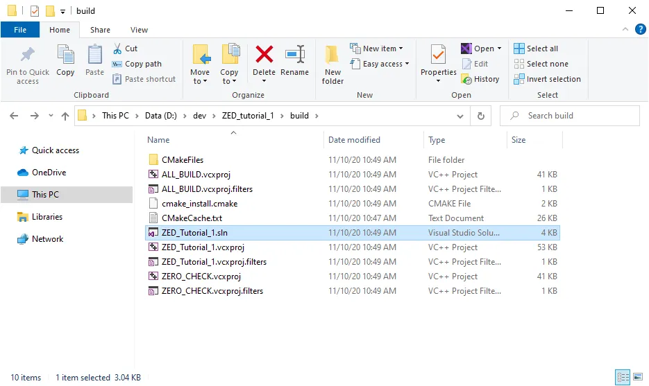

  • CMake has now generated your project in the build directory. You can directly open the solution by clicking on [Open Project] or by closing the cmake-gui window and opening the build folder.

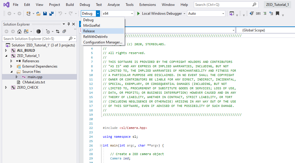

  • A Visual Studio solution has been generated. Open ZED_Tutorial_1.sln and set it in Release mode.

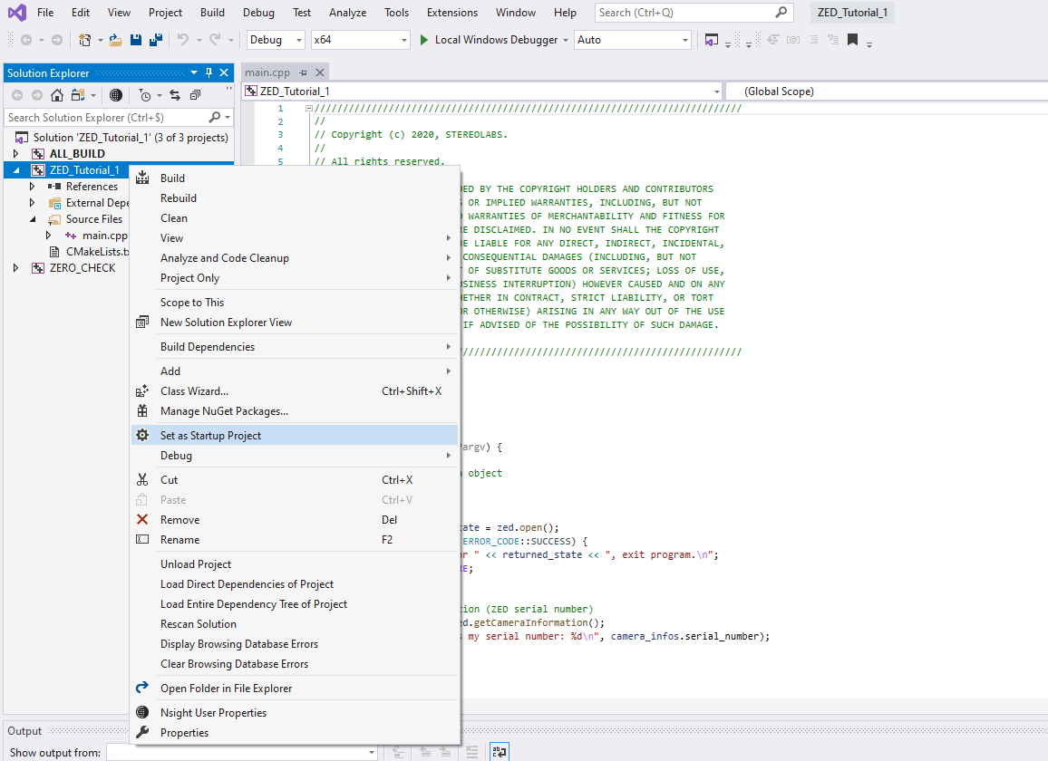

  • To run the builds from the Build menu or from keyboard shortcuts, set the ZED_Tutorial_1 target as the startup project.

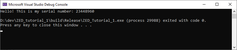

  • You can now edit and compile your program in the Visual Studio IDE. Hit the Ctrl+F5 key to launch the program.
