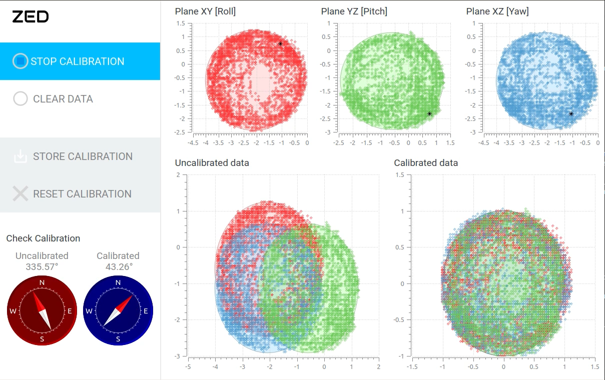

To perform a tri-axis magnetometer calibration you can use the ZED Sensor Viewer application. Select the Magnetometer sensor and click on Calibrate Magnetometer.
Calibration process
Start the calibration by pressing the button START CALIBRATION.
You can clear all the acquired data and restart the calibration process at any moment by pressing the CLEAR DATA button.
1. Initialize the plane XY
Perform a series of roll rotations. The scope of this phase is to “draw” a complete red circumference fitting the red ellipsoid in the background:
2. Initialize the plane YZ
Perform a series of pitch rotations. The scope of this phase is to “draw” a complete green circumference fitting the green ellipsoid in the background:
3. Initialize the plane XZ
Perform a series of yaw rotations. The scope of this phase is to “draw” a complete blue circumference fitting the blue ellipsoid in the background:
4. Perform a full calibration
Perform a series of mixed rotations trying to orient the camera in all the possible roll, pitch, and yaw combinations. The scope of this phase is to fill as much area inside the three ellipsoids as possible for the three planes XY, YZ and XZ:
5. Stop the calibration and verify the result
When the three ellipsoids are filled, the calibration process can be stopped by pressing the button STOP CALIBRATION.

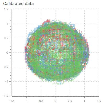

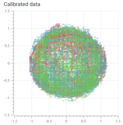

You can check the reliability of the calibration by verifying that the calibrated values for the three planes are perfectly overlapped in the Calibrated data chart, and that they fit (with some outliers) the unitary ellipsoid displayed in the background:
On the left side of the interface, you can find two compasses. The red compass shows the heading of the camera calculated using the uncalibrated magnetic field values, the blue compass shows the heading of the camera calculated using the calibrated magnetic field values. Place the camera horizontally and rotate it around the vertical axis. If the calibration is done well, the blue compass should display the correct camera orientation with respect to the North Magnetic Pole. You can use a “real” compass to compare the values.
