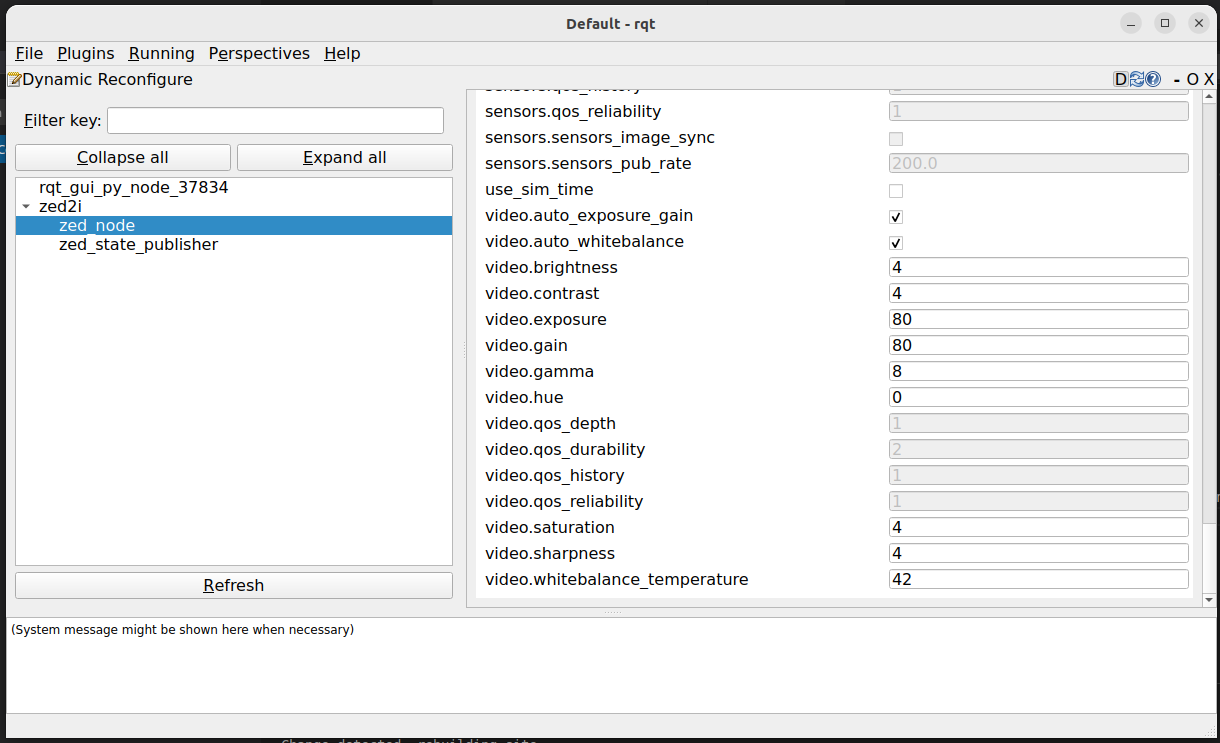

Dynamic parameters
The ZED node lets you reconfigure many parameters dynamically during the execution of the node. All the dynamic parameters are indicated with a * in the list above and with the tag [DYNAMIC] in the comments of the YAML files.
You can set the parameters using the CLI command ros2 param set, e.g.:
ros2 param set /zed/zed_node depth.depth_confidence 80
If the parameter is set successfully, you will get a confirmation message:
Set parameter successful
In the case you tried to set a parameter that’s not dynamically reconfigurable, or you specified an invalid value, you will get this type of error:
ros2 param set /zed/zed_node depth.depth_confidence 150
Setting parameter failed: Parameter {depth.depth_confidence} doesn't comply with integer range.
You can also use the Configuration -> Dynamic Reconfigure plugin of the rqt tool to dynamically set parameters by using a graphic interface.

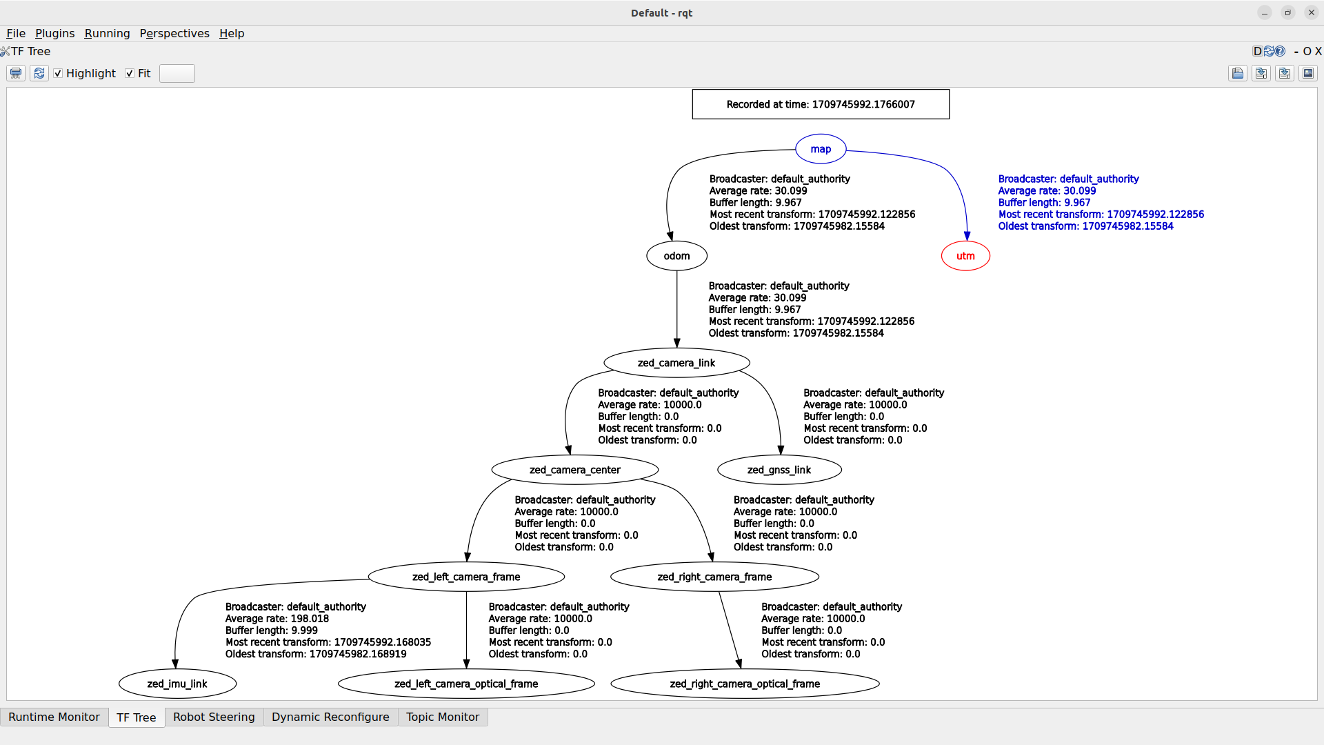

Transform frames
The ZED ROS 2 wrapper broadcasts multiple coordinate frames that each provides information about the camera’s position and orientation. If needed, the reference frames can be changed in the launch file.
  • <camera_name>_camera_link is the current position and orientation of the ZED base center. It corresponds to the bottom central fixing hole.
  • <camera_name>_camera_center is the current position and orientation of ZED middle baseline, determined by visual odometry and the tracking module.
  • <camera_name>_right_camera_frame is the position and orientation of the ZED’s right camera.
  • <camera_name>_right_camera_frame_optical is the position and orientation of the ZED’s right camera optical frame.
  • <camera_name>_left_camera_frame is the position and orientation of the ZED’s left camera.
  • <camera_name>_left_camera_frame_optical is the position and orientation of the ZED’s left camera optical frame.
  • <camera_name>_imu_link is the origin of the inertial data frame (not available with ZED).
  • <camera_name>_mag_link is the origin of the magnetometer frame (ZED2/ZED2i only).
  • <camera_name>_baro_link is the origin of the barometer frame (ZED2/ZED2i only).
  • <camera_name>_temp_left_link is the origin of the left temperature frame (ZED2/ZED2i only).
  • <camera_name>_temp_right_link is the origin of the right temperature frame (ZED2/ZED2i only).
For RViz 2 compatibility, the root frame map_frame is called map. The TF tree generated by the zed_wrapper reflects the standard described in REP105. The odometry frame is updated using only the “visual inertial odometry” information (loop closure is not applied). The map frame is updated using the Positional Tracking algorithm provided by the StereoLabs SDK, fusing the inertial information from the IMU sensor, and applying loop closure information.
map_frame (`map`)
└─odometry_frame (`odom`)
└─camera_link (`<camera_name>_camera_link`)
└─camera_frame (`<camera_name>_camera_center`)
└─left_camera_frame (`<camera_name>_left_camera_frame`)
| └─left_camera_frame_optical (`<camera_name>_left_camera_frame_optical`)
| └─imu_frame (`<camera_name>_imu_link`)
└─right_camera_frame (`<camera_name>_right_camera_frame`)
└─right_camera_frame_optical (`<camera_name>_right_camera_frame_optical`)
When the Geo Tracking module is enabled the ZED Node TF Tree reflects the following diagram:

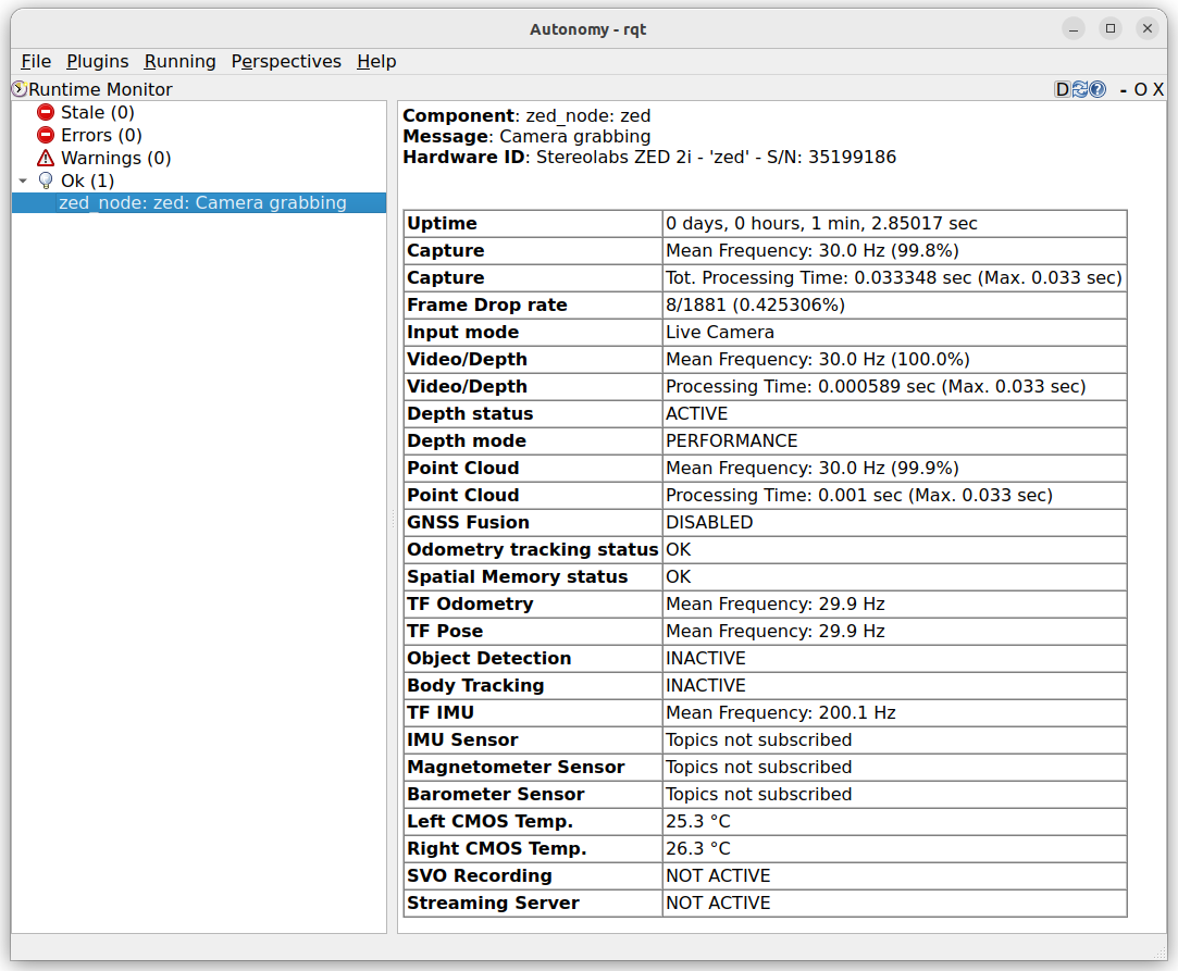

Node Diagnostic
The ZED ROS 2 node publishes useful diagnostic information aggregated into the /diagnostics topic using the diagnostic_updater package.
Diagnostic information can be analyzed and parsed by using ROS 2 tools, like for example the Runtime Monitor plugin of rqt.
Available information:
  • Uptime
  • Grab frequency and processing time
  • Frame drop rate
  • Input mode
  • Video and Depth publishing rate and processing time
  • Depth Mode
  • Point Cloud publishing rate and processing time
  • GNSS Fusion status
  • Odometry and Localization status
  • Pose confidence: the [0,100] quality metric of the positional tracking. It requires ZED SDK >= 5.4 and POSITIONAL_TRACKING_MODE::GEN_3, and is reported as N/A otherwise
  • TF broadcasting rate
  • Object Detection status and publishing rate
  • Body Tracking status and publishing rate
  • IMU TF broadcasting rate
  • Sensor data publishing rate
  • Camera Internal temperatures
  • Scene Illuminance (ZED X family)
  • Camera health status: image quality, lighting, depth reliability, motion sensors reliability and, with ZED SDK >= 5.5 and zed_msgs v5.5, duplicated images
  • SVO playback status
  • SVO recording status, including the PAUSED state
  • Streaming server status
The diagnostic goes to WARN and names the issues while any camera health check is raised. It reports DISABLED when general.enable_image_validity_check is off.
