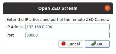

The following window will open. Enter the IP of the NVIDIA® Jetson™ device, as well as the port used by the sender (by default: 30000).
Depth Viewer connect modal
After a few moments, you should have a live view of the ZED camera streaming from the device!
