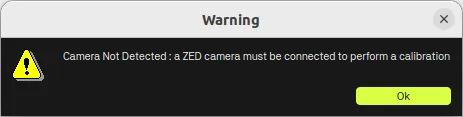

  1. Connect the ZED Camera: Ensure your ZED camera is connected to your computer; otherwise, you will get this error message and the application will exit:

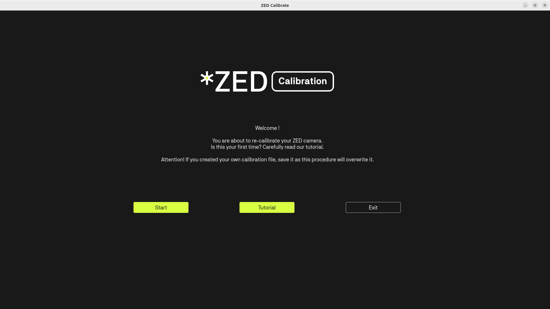

  3. [optional] Follow the Tutorial: Click on the Tutorial button to open a 7-step guide that will help you through the calibration process. This is especially useful if you are new to this tool. You will learn how to move the camera and monitor the visual feedback to ensure proper calibration.

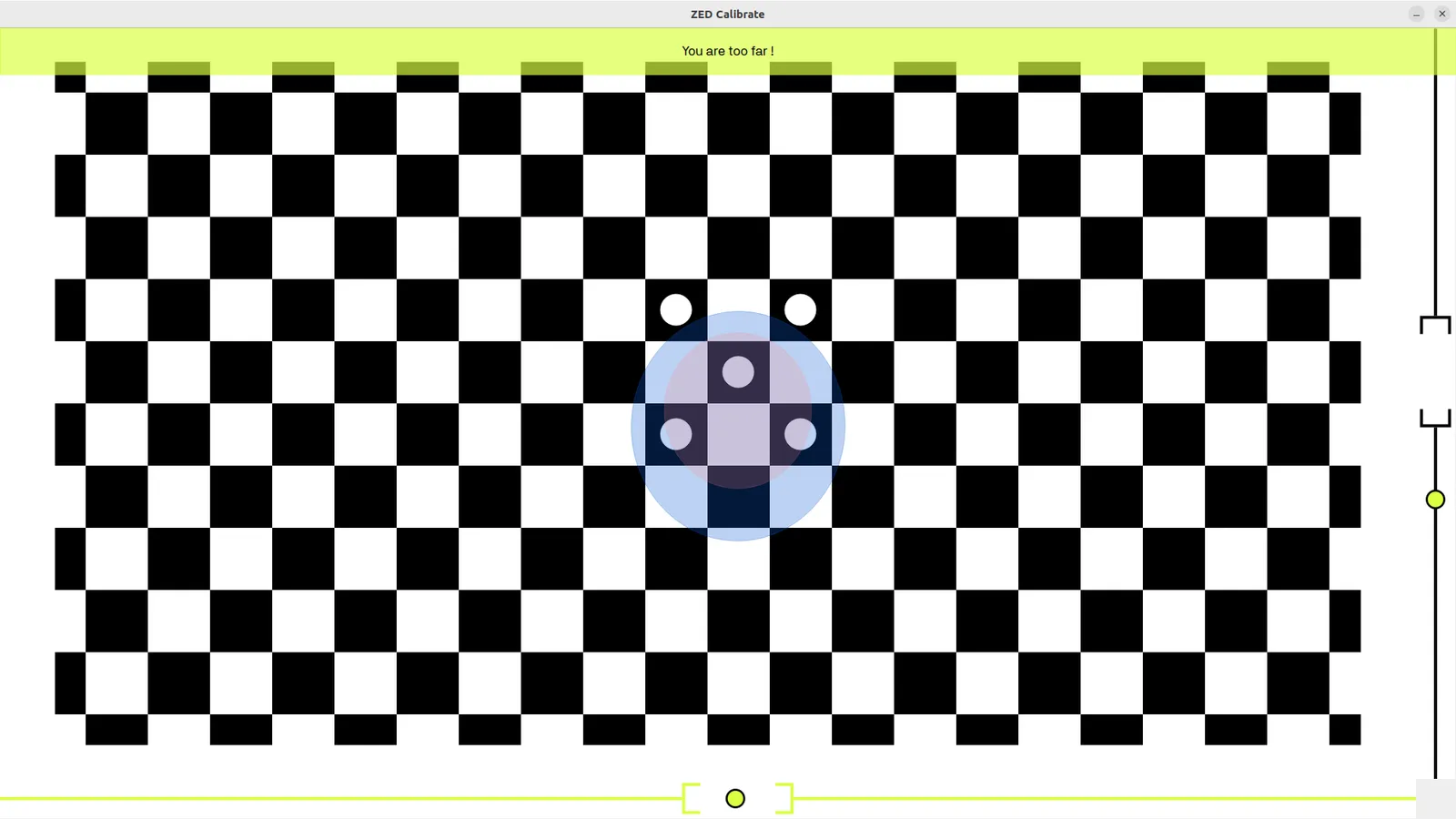

  4. Start Calibration: Click on the Start button to begin the calibration process. The tool will guide you through the steps, including moving the camera to capture different angles and positions.
  5. Calibrate the camera: Follow the on-screen instructions to adjust the camera position and orientation. The tool will provide visual feedback to help you understand how well the calibration is progressing.

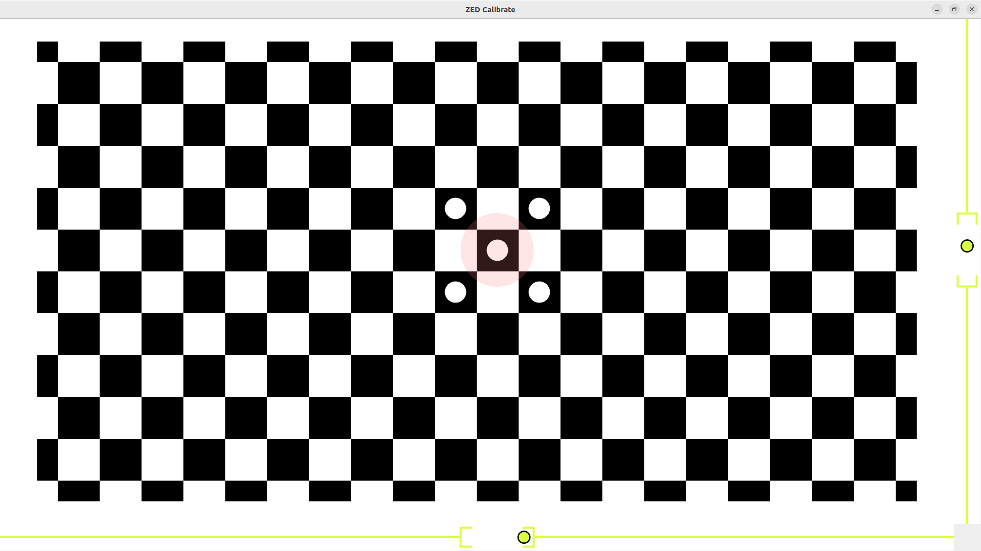

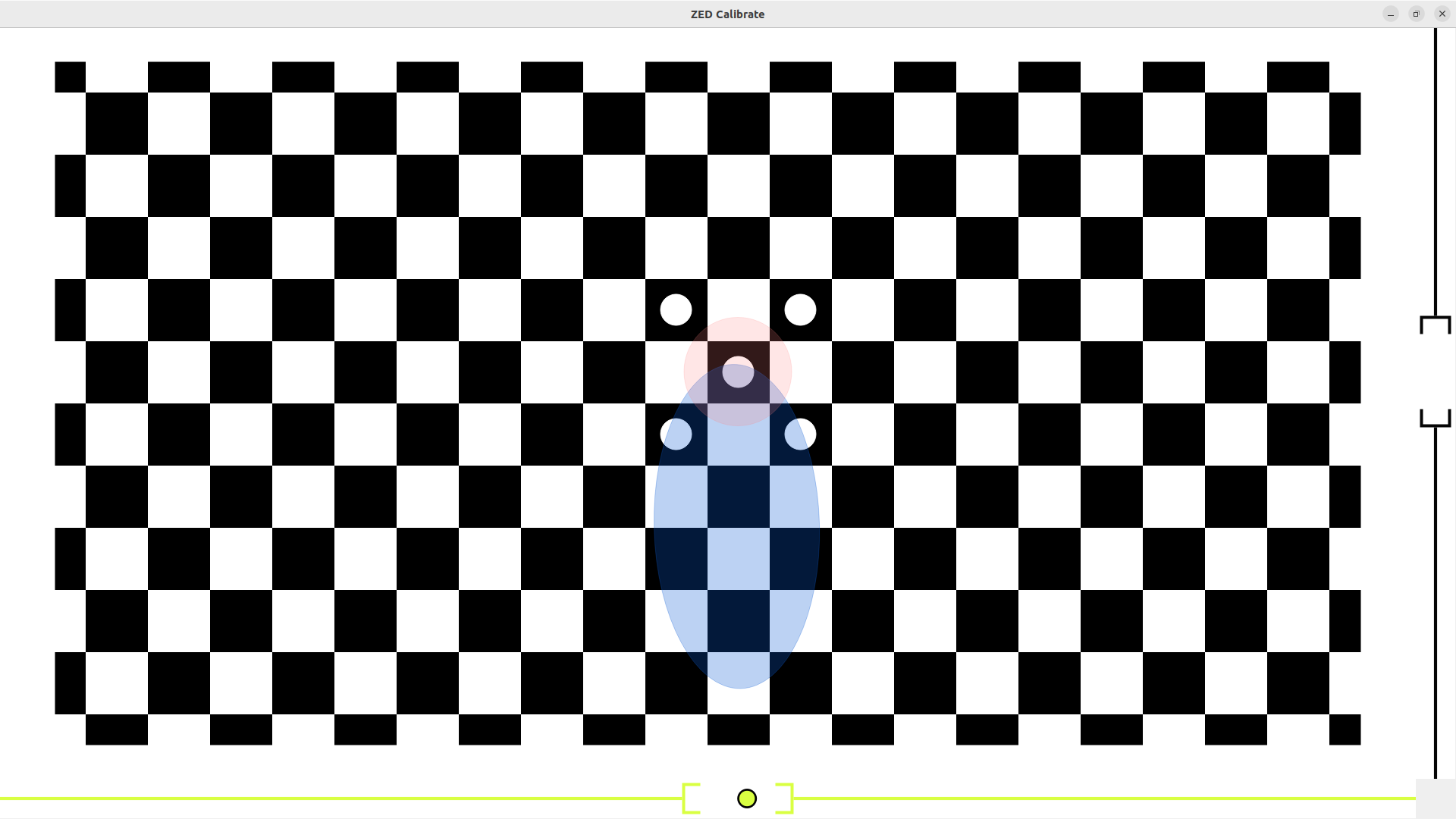

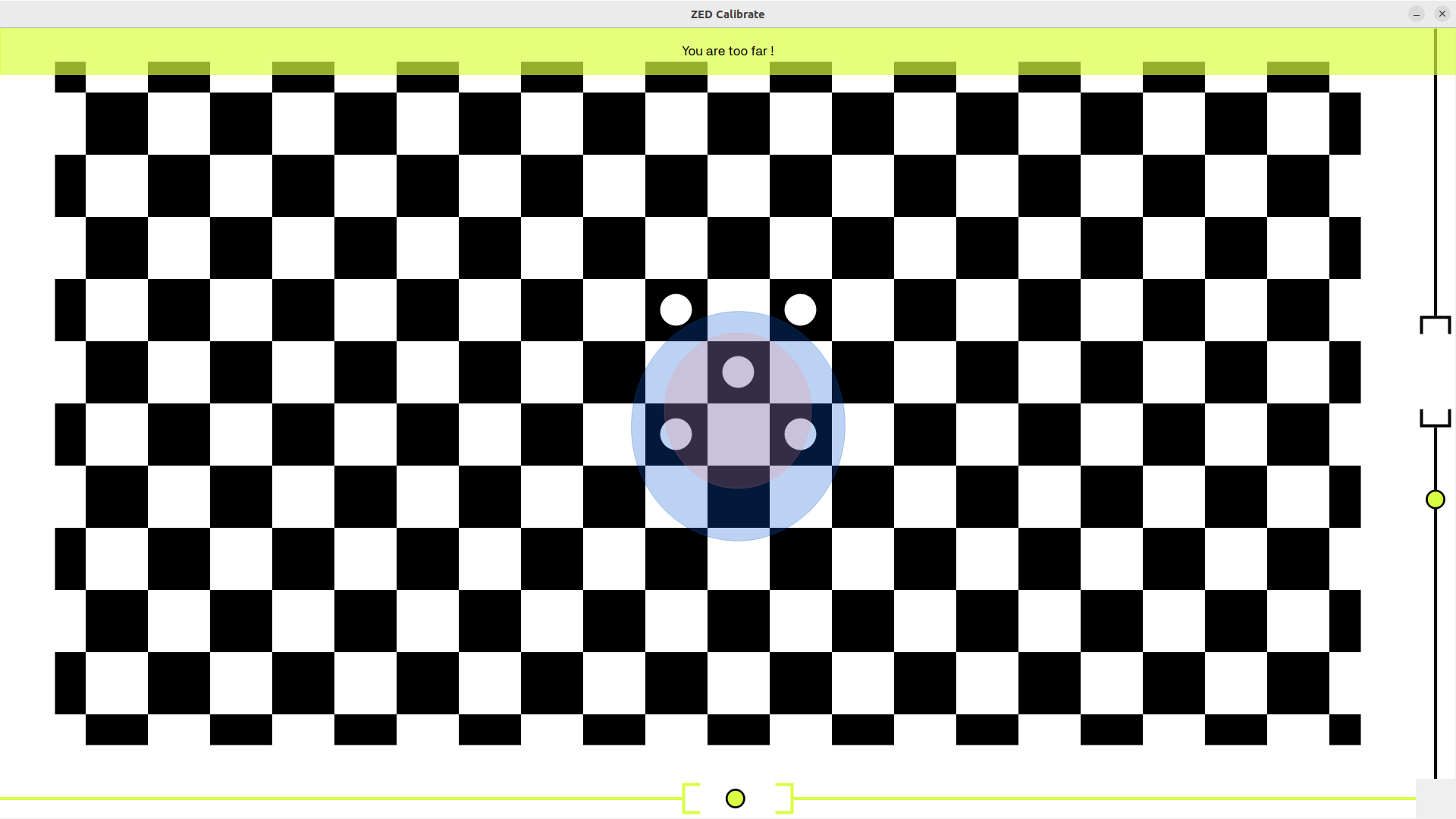

    • Move and rotate the camera so that the blue circle overlaps perfectly with each red circle that appears, matching it in size, form, and position. Think of the blue circle as a dynamic light spot whose size and shape change depending on the camera’s distance and angle relative to the screen. Aim to align the circles as closely as possible for optimal calibration accuracy.
    • Pay attention to the instruction text that may appear at the top of the screen. These messages provide real-time guidance on how to move and position the camera for optimal calibration.

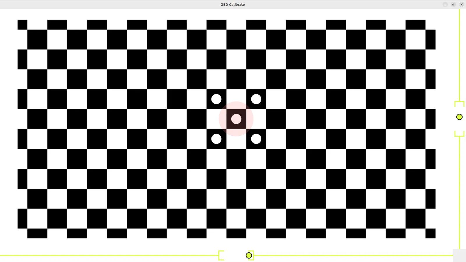

    • The side and bottom indicators help you assess the quality of your camera’s pan and tilt alignment during calibration. When the indicator point remains within the central area, your camera is correctly oriented. If the point moves outside this area, adjust the camera’s orientation to bring it back to the center for optimal calibration results.
    PanTilt
    GOODimageimage
    BADimageimage

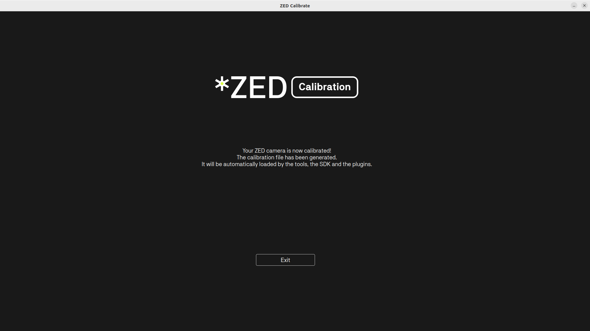

  6. Finalize Calibration: Once you have completed the calibration steps, click on the Exit button to save the new calibration parameters by overwriting the factory SNxxxxxxx.conf file. You can also choose to reset the calibration to factory settings if needed by using ZED Explorer.
