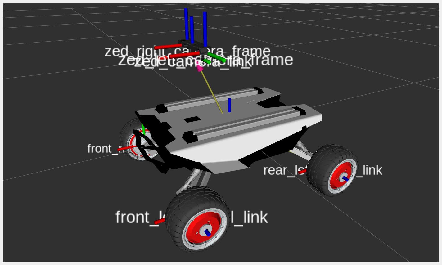

The xacro file urdf/zed_robot_mono.urdf.xacro defines the robot configuration required to obtain the result of the following picture.

Three xacro arguments are defined at the very beginning of the example zed_robot_mono.urdf.xacro file to configure the robot:
<xacro:arg name="camera_name" default="zed" />
<xacro:arg name="camera_model" default="zedx" />
<xacro:arg name="use_zed_localization" default="true" />
  • camera_name: sets the name of the camera to be used as prefix for the name of the links and joints of the camera URDF.
  • camera_model: sets the model of the camera to load the relative visual 3D mesh, set the camera dimensions, and set the bias values for the mounting points.
  • use_zed_localization: allows you to set the correct TF tree in case ZED Localization is used as the main localization engine, or an external localization engine (e.g. the Robot Localization package) is used.

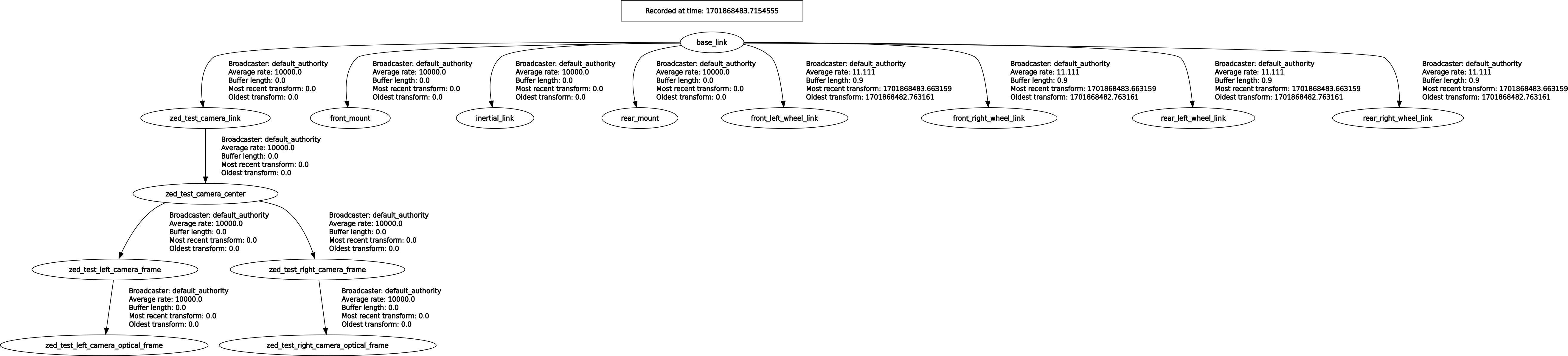

This is the TF tree generated when use_zed_localization is enabled:

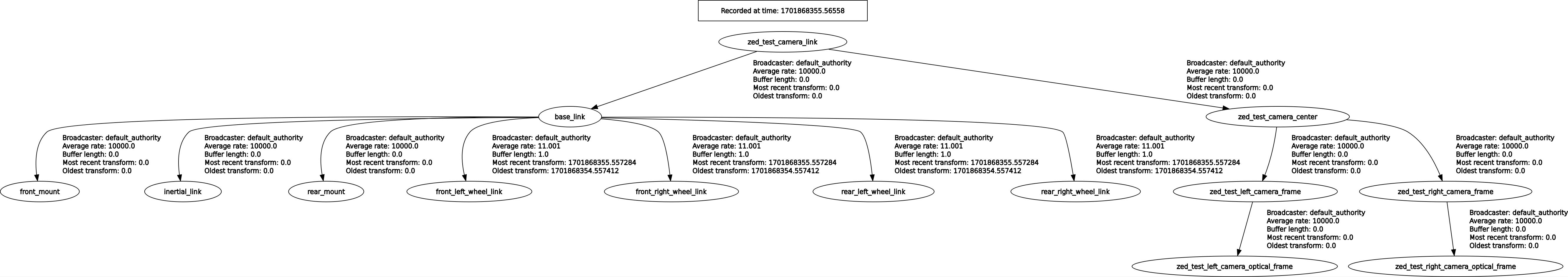

This is the TF tree generated when use_zed_localization is disabled:

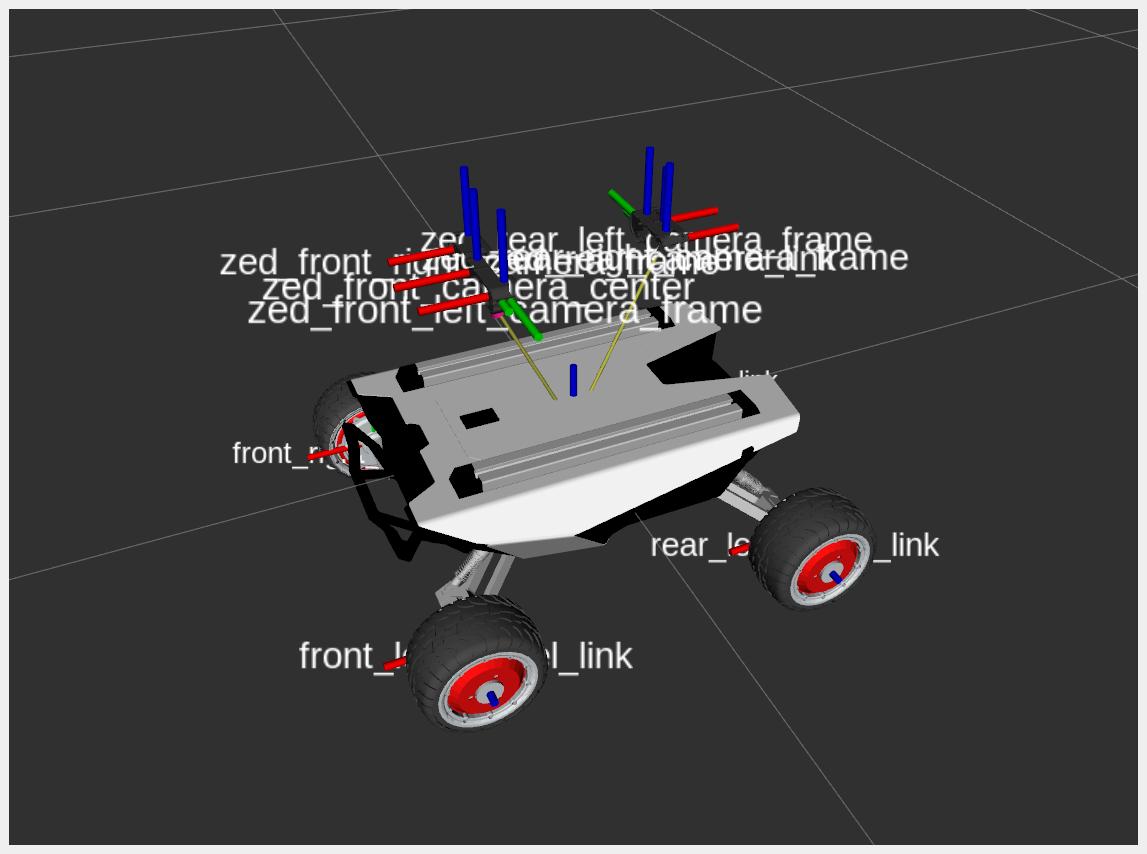

The xacro file urdf/zed_robot_dual.urdf.xacro defines the robot configuration to obtain the result of the following picture in a dual-camera configuration.

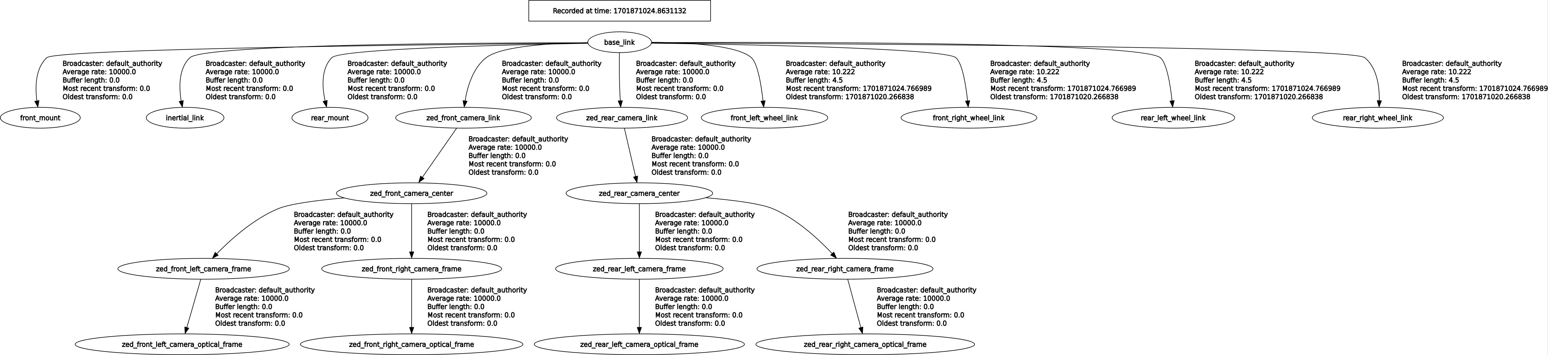

This is the TF tree when use_zed_localization is enabled:

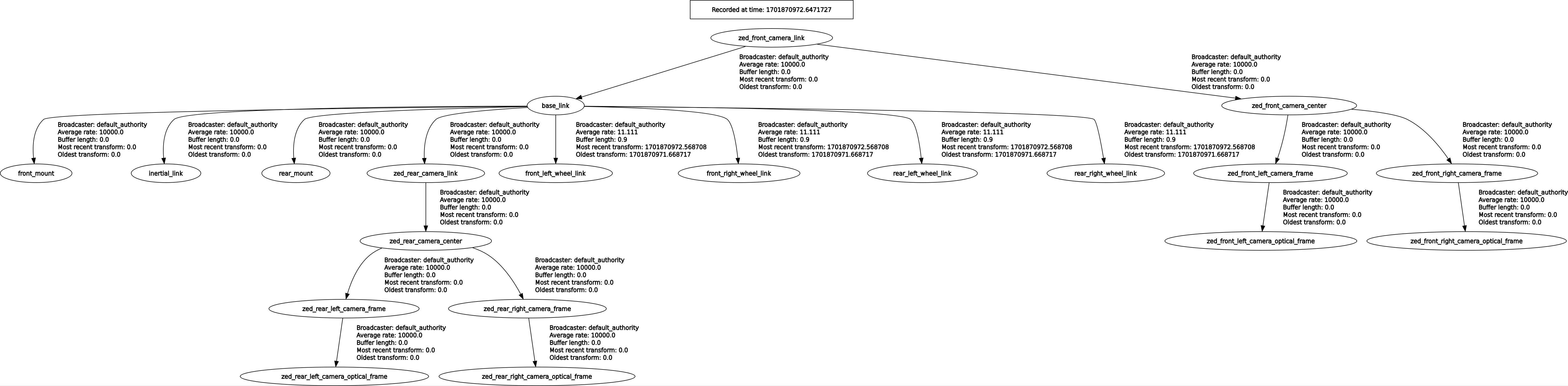

This is the TF tree when use_zed_localization is disabled:
