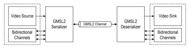

Gigabit Multimedia Serial Link (GMSL2) is a serial communication protocol that uses Analog Devices’ proprietary technology to transport high-speed, serialized data over coax or shielded-twisted pair (STP) cables for automotive camera and display applications. GMSL2 links operate at fixed data rates, including 3 Gbps or 6 Gbps on the forward channel, and 187Mbps on the reverse channel, depending on device capabilities and configuration. The figure shows a block diagram of a typical GMSL2 system.
Source: Analog Devices - GMSL2 Channel Specification User Guide - Rev 1
