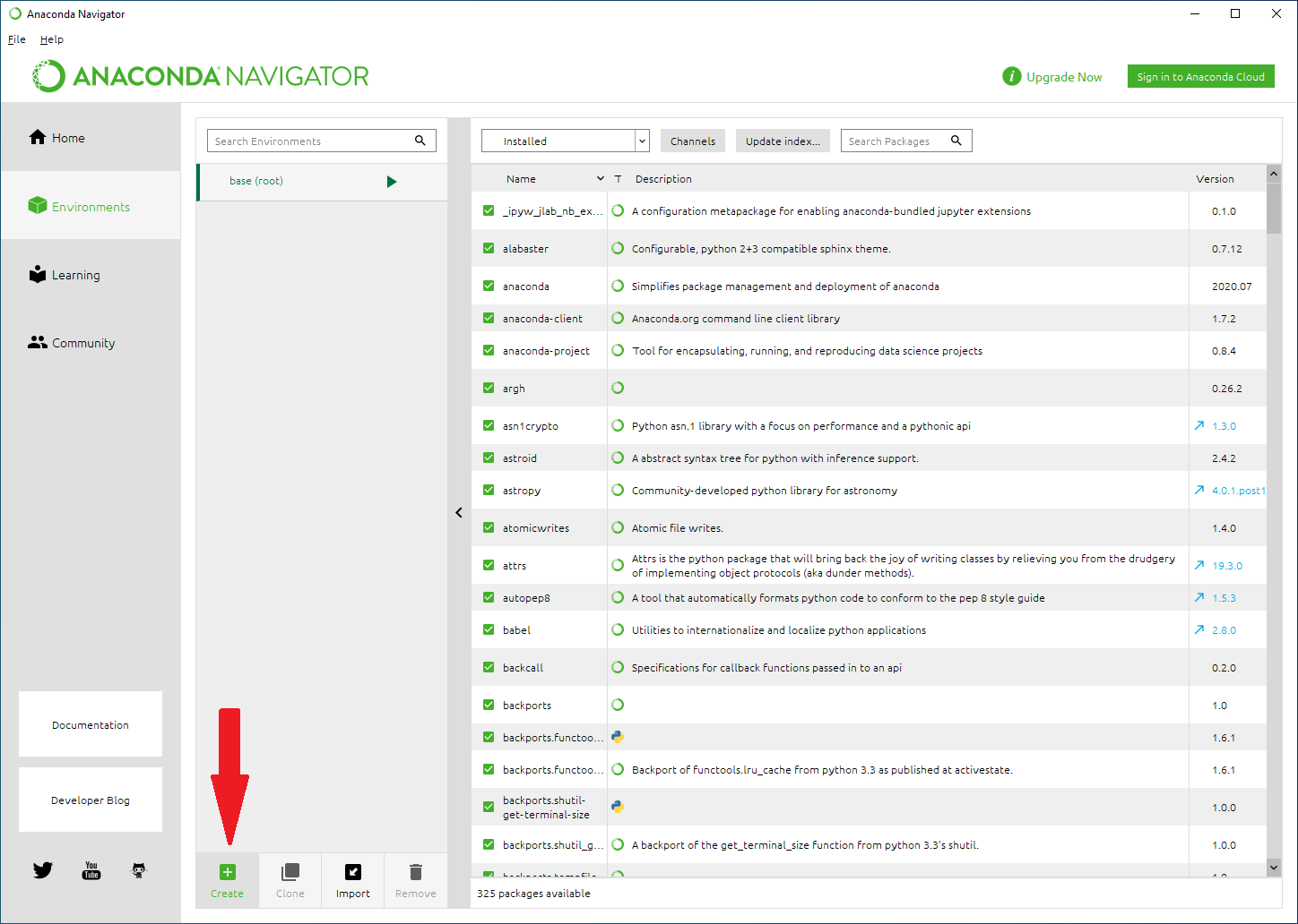

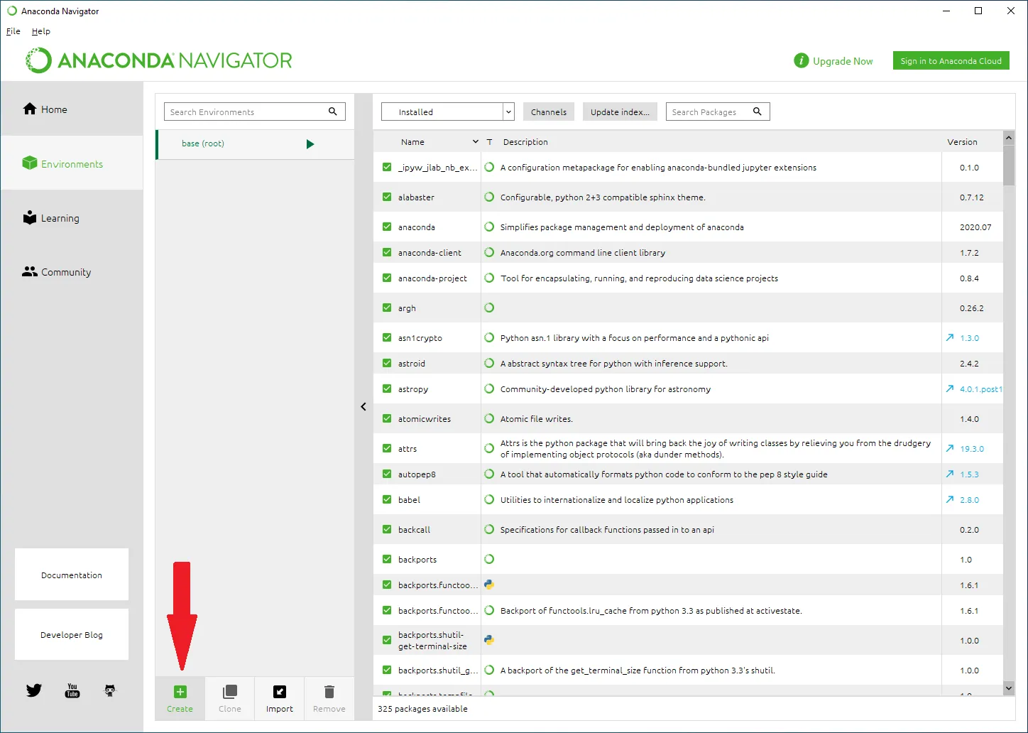

To create a new environment that enables you to use the ZED Python wrapper, select the Environments tab on the left panel and then click Create at the bottom of the page.

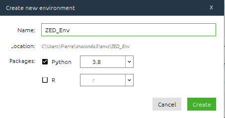

A dialog box appears. Give a name to your new environment and click Create.
Your newly created environment is now listed below the base (root) one.

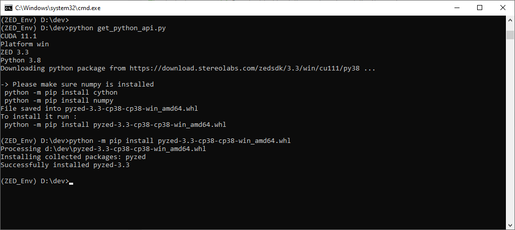

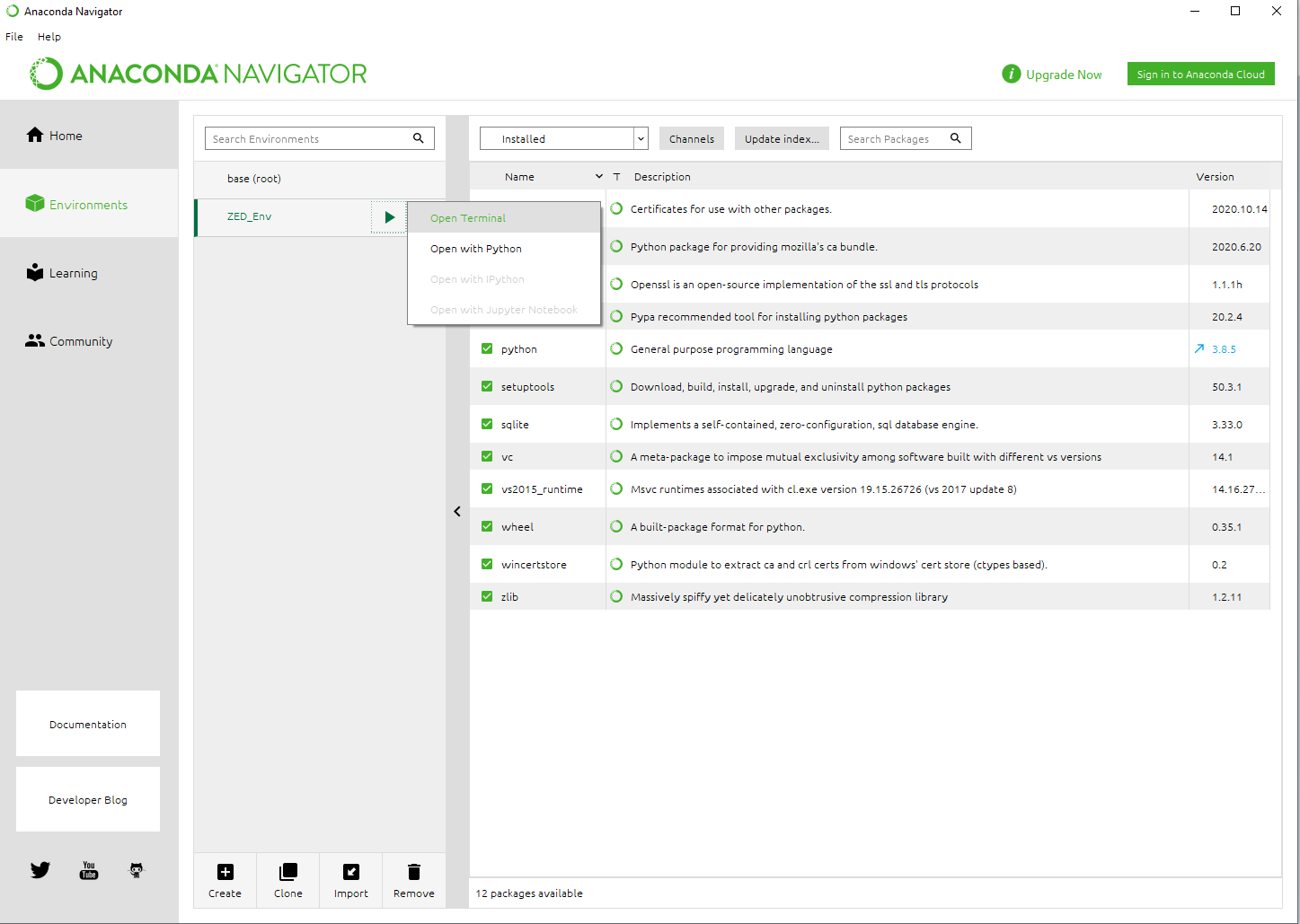

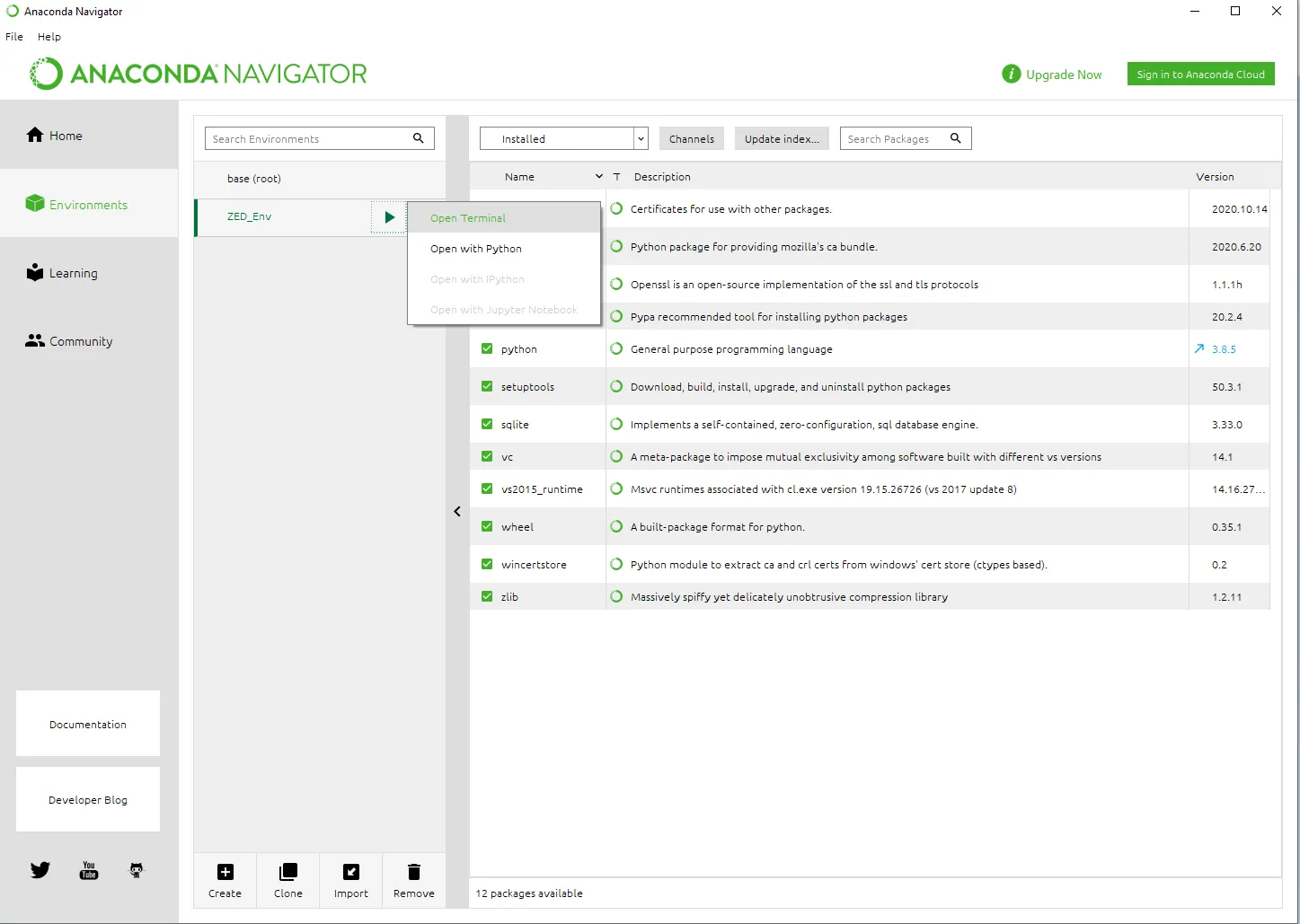

To do so, click on its name and then on the triangle icon to select Open Terminal.
As said for the ZED package installation, copy the file get_python_api.py somewhere you can execute it without permission issues and then run it.

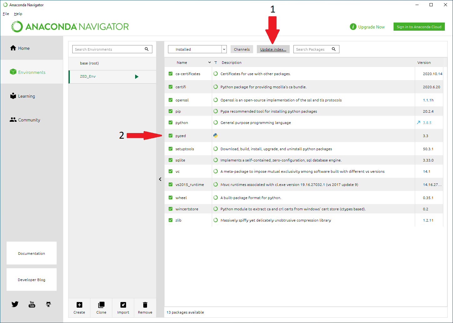

The ZED package is now installed, and you can close the Terminal. To make sure it is set up correctly, click on Update index..; the ZED package named pyzed should appear in your environment.

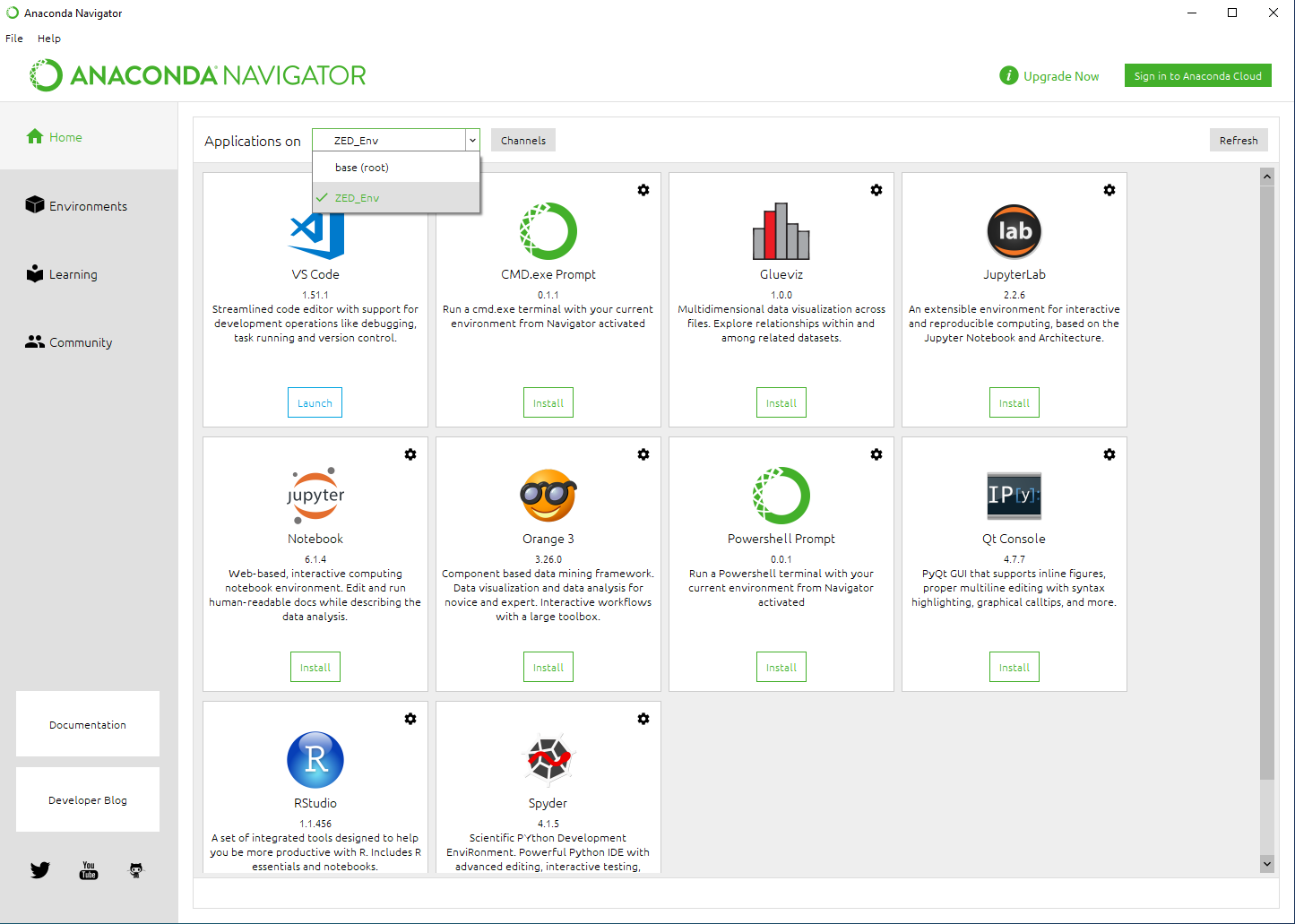

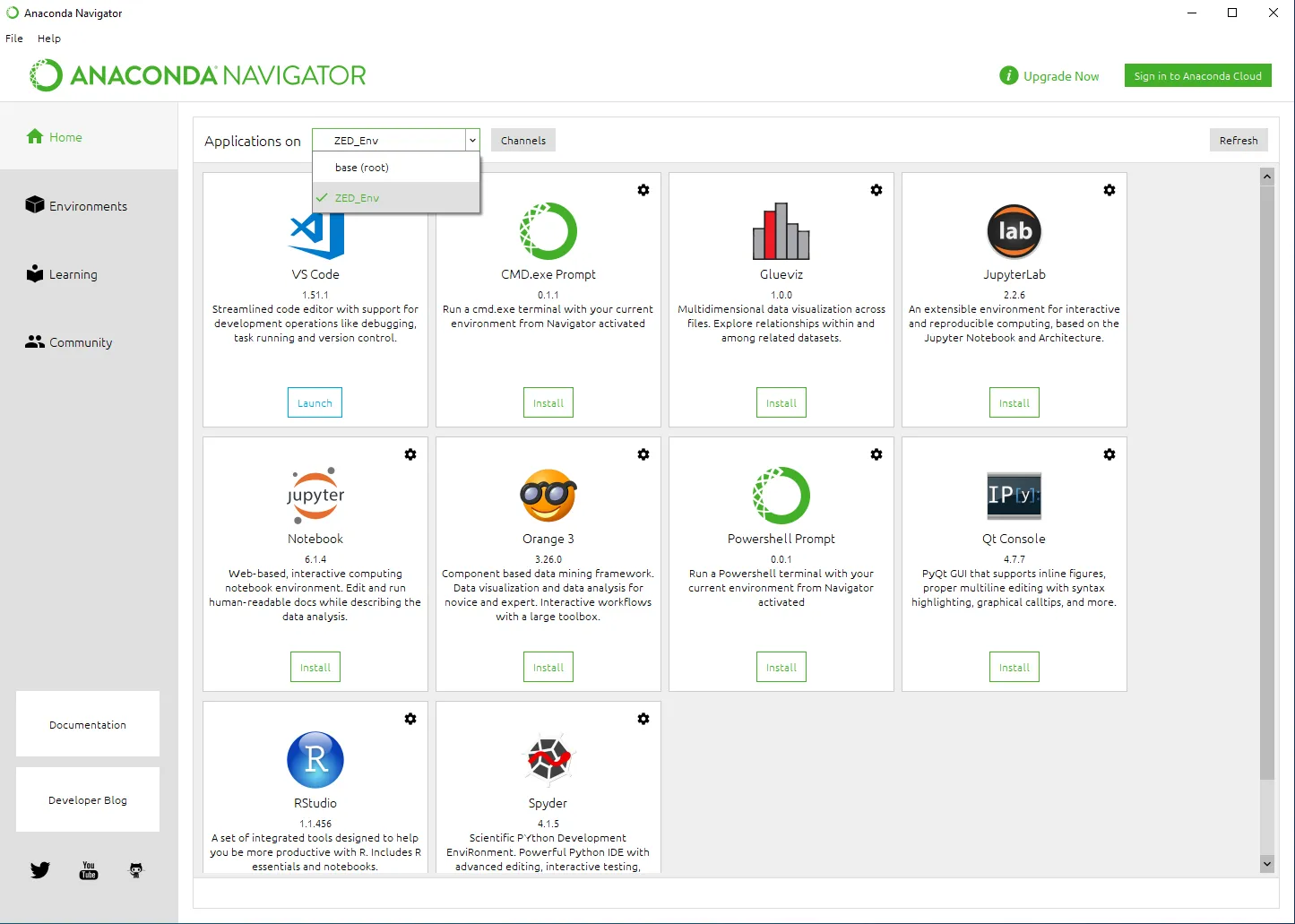

Go back to the Home tab on the left panel and select your environment.

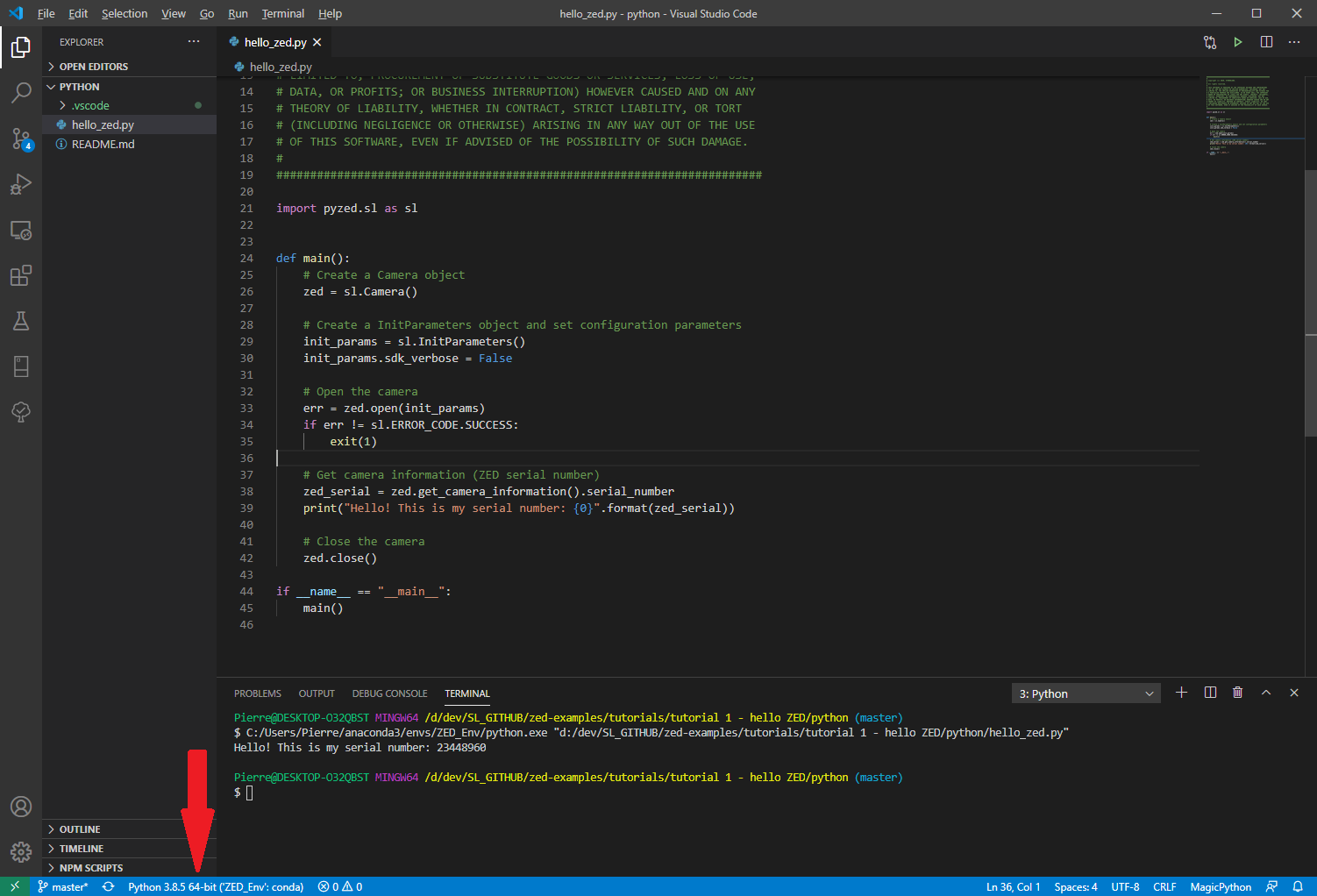

Choose your preferred IDE, open a Python sample, and make sure you are really in your virtual environment. That’s all, you can run the sample!
