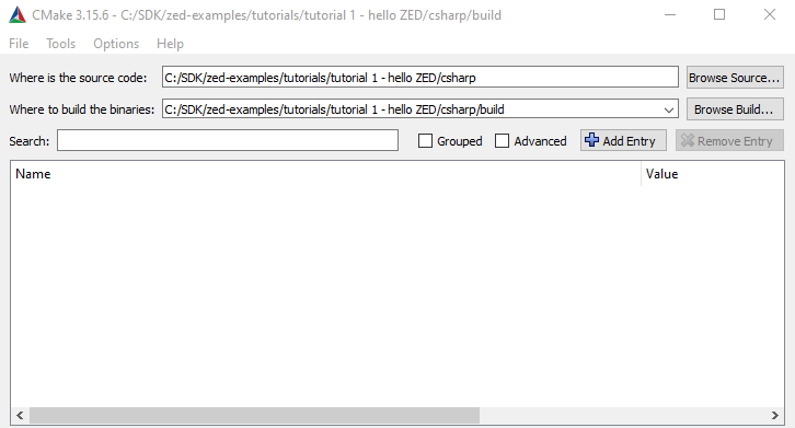

  • Open cmake-gui.
  • In “Where is the source code“, enter the path of the project folder where the CMakeLists.txt is located.
  • In “Where to build the binaries“, enter the previous path and add: /build.

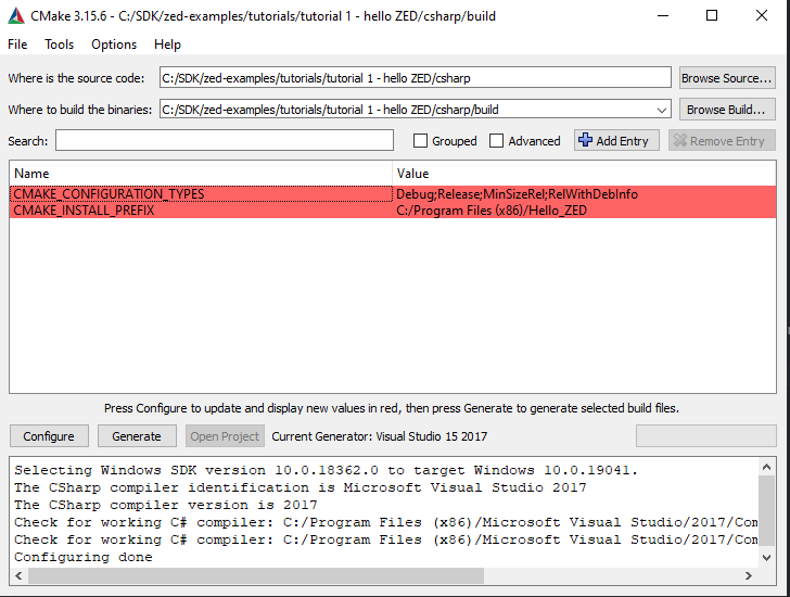

  • Click on [Configure].
  • A dialog window asks you if CMake can create the “build” folder. Say yes.

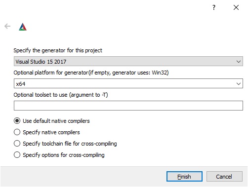

  • Another dialog window will ask you to specify a generator for your project. Choose Visual Studio in Win64 and click on [Finish].
  • CMake may take a few seconds to configure the project.
  • Click on [Generate] to build the Visual Studio project files.

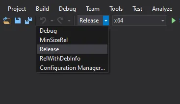

  • A Visual Studio solution has been generated. Open Hello_ZED.sln and set it in Release mode.

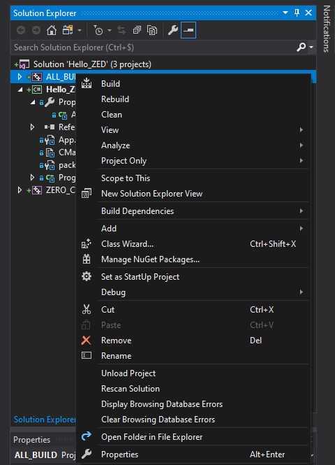

  • To run the builds from the Build menu or from keyboard shortcuts, set the Hello_ZED target as the startup project. In the Solution Explorer, right-click the Hello_ZED project and click Set As Startup Project.

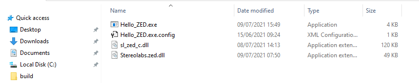

  • When the program is built, the C# interface (Stereolabs.zed.dll) and the C wrapper (sl_zed_c.dll) are automatically added to the build folder, next to the executable file.
  • When deploying the application, make sure that sl_zed_c.dll and Stereolabs.zed.dll are packaged with the executable files, and shipped on a target PC that has the proper ZED SDK version installed.
