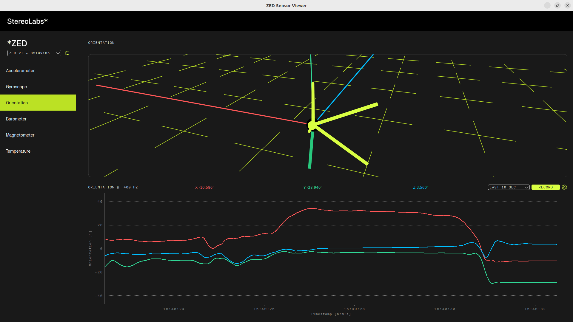

The interface of ZED Sensor Viewer is divided into three main sections:
  • Sensor selection: Allows you to select the sensor data you want to visualize:

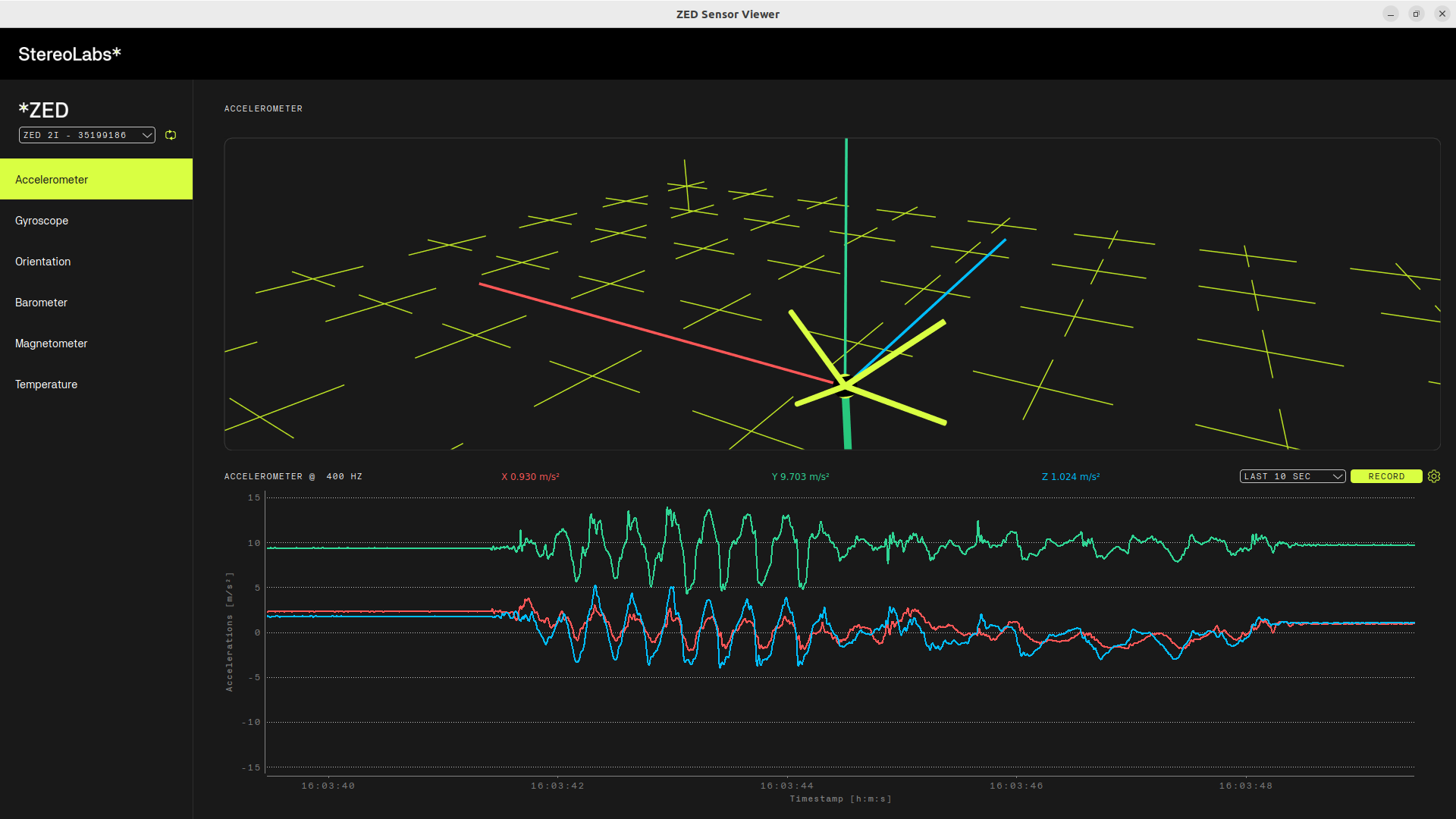

    • Accelerometer: Displays the accelerometer data in 3D space, showing the acceleration along the X, Y, and Z axes.
    • Gyroscope: Displays the gyroscope data in 3D space, showing the rotation around the X, Y, and Z axes.
    • Orientation: Displays the camera’s orientation data in 3D space, showing the roll, pitch, and yaw angles.
    • Barometer: Displays the barometer data, showing the atmospheric pressure and altitude (only available for ZED 2 and ZED 2i).
    • Magnetometer: Displays the magnetometer data in 3D space, showing the magnetic field strength along the X, Y, and Z axes (only available for ZED 2 and ZED 2i).
    • Temperature: Displays the camera’s internal temperature, which can be useful for monitoring the camera’s performance and health.
  • Camera Orientation: Displays the camera’s orientation data in the space with a 3D model of the camera, allowing you to visualize how the camera is positioned in space with respect to the gravity vector.
  • Data Plot: Displays the real-time data from the selected sensor in a graphical format, allowing you to visualize changes over time.

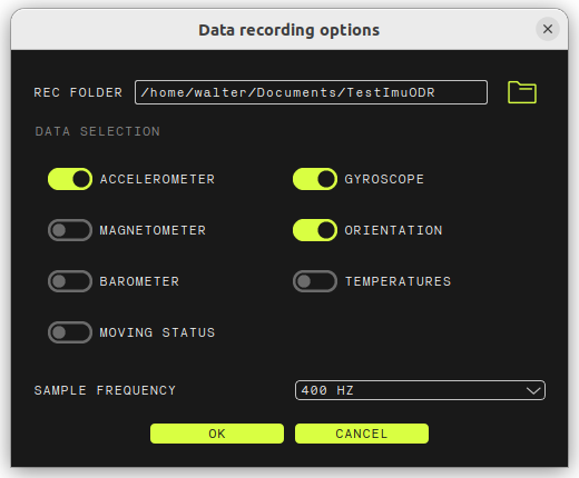

You can also select the destination folder, what data to save, and the data frequency by clicking on the gear icon on the right of the RECORD button. This opens the Data Recording Settings dialog, where you can select the data to save and the destination folder.

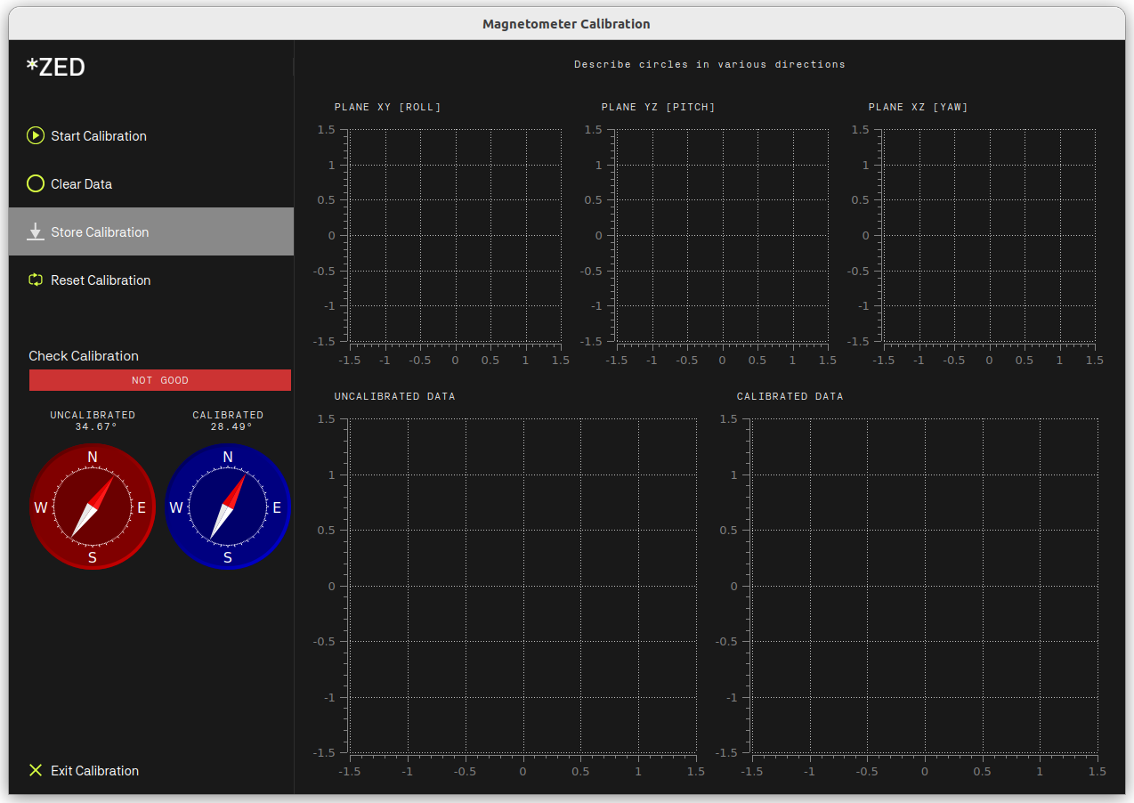

Calibrate the Magnetometer (ZED 2 and ZED 2i only)
When you select the Magnetometer sensor, a new button appears in the bottom left corner of the interface: Calibrate Magnetometer. This button allows you to calibrate the Magnetometer sensor on the ZED 2 and ZED 2i models.
The calibration process is described in detail in the Magnetometer Calibration section.
