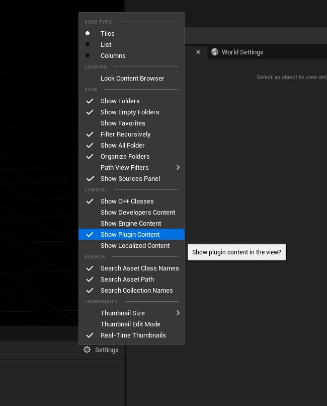

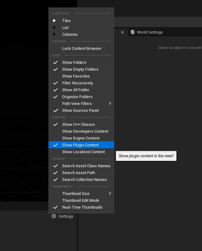

Now we’ve got to add a Blueprint from the ZED plugin. But by default, Content from plugins is hidden. To fix this, click on View Options at the bottom right of the Content Browser and enable Show Plugin Content.

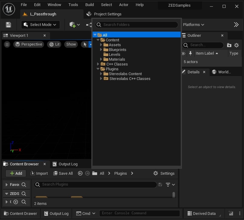

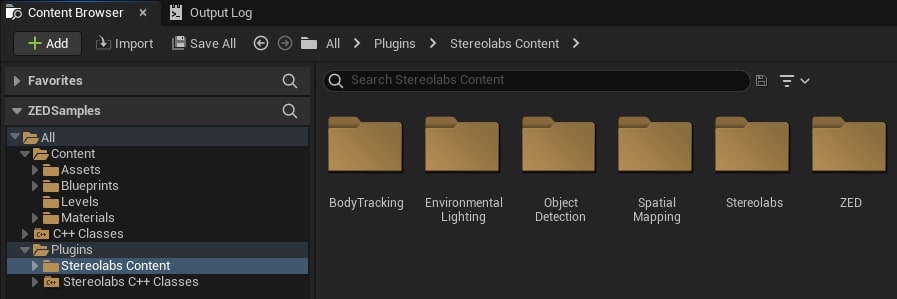

Now click on the folder icon beside Content and click on Stereolabs Content to switch to the plugin’s content folder.
image image
In the Content Browser, go to Plugins -> Stereolabs Content -> ZED -> Blueprints and drag a BP_ZEDCamera into the scene. This is the object that sets up your camera and handles communication with your app.

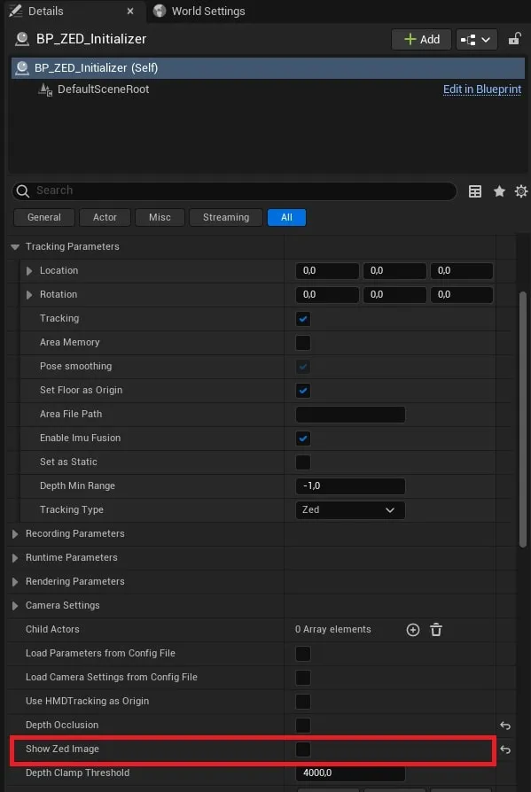

  • Select the BP_ZEDCamera blueprint, and in the ZED section, uncheck the Show Zed Image parameter. This parameter has to be disabled so we can see the 3D scene and not the ZED’s image in fullscreen.

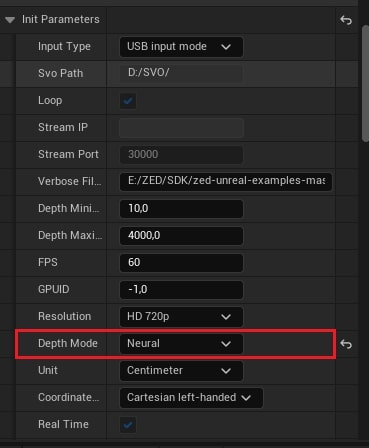

  • In the Init Parameters section, set Depth Mode to NEURAL. This mode is mandatory in order to have accurate background subtraction.
The NEURAL depth mode is AI-based, therefore the AI model has to be downloaded and optimized when using this mode for the first time. If it has not been optimized yet, the plugin will start the optimization itself. It can take some time so we recommend using the ZED Diagnostic tool to optimize it beforehand.

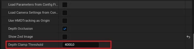

  • Using the Depth clamp Threshold parameter. This parameter will discard all the pixels of the image with a depth higher than the threshold. It is useful when the virtual background is a 3D scene placed farther away than the real background.
This parameter can also be modified at runtime, on the ZEDCamera actor, attached at runtime to the ZEDPawn, letting you adapt the threshold in real time.
