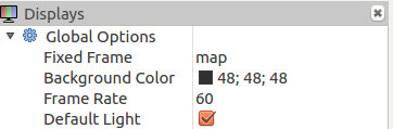

Global options
To be able to visualize the information published by the ZED camera, it is necessary to correctly configure the Global Options:
Global
Key parameters:
  • Fixed frame: Indicates the name of the frame used as the reference for all the other frames. You can select any frame available in the combo box. map or odom are the best choices.
  • Frame rate: The maximum frequency used to update the 3D view. 30 or 60 FPS are good values. Available computational power should guide your decision.

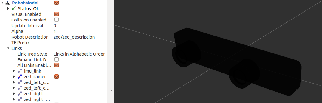

Robot model
This plugin allows you to visualize the Robot Model according to its description from the URDF model. The ZED wrapper generates the camera model from the zed_descr.urdf.xacro file, according to the camera_model launch argument (zed, zedm, zed2, zed2i, zedx or zedxm).
Model
Key parameters:
  • Visual enabled: Enable/disable the 3D visualization of the model
  • Robot description: The parameter containing the robot description. The ZED launch files load it as <camera_name>_description (for example zed_description with zed.launch)
By expanding the Links item, you can see the whole model tree, with all the joints and the links available and the relative position and orientation in the space relative to the fixed frame.

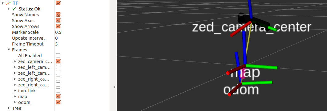

TF
This plugin allows you to visualize the position and orientation of all the frames that compose the TF hierarchy.
TF
Key parameters:
  • Show names: Enable/disable the 3D visualization of the names of the links
  • Show axes: Enable/disable the 3D visualization of the axes of the frames
  • Show arrows: Enable/disable the 3D visualization of the arrows that connect the various frames
  • Update interval: The update time in seconds. Leave at 0 to see each update
Critical to using this plugin is the ability to enable/disable visualizing individual frames. This allows you to concentrate only on the parts that are most important for your current task.
