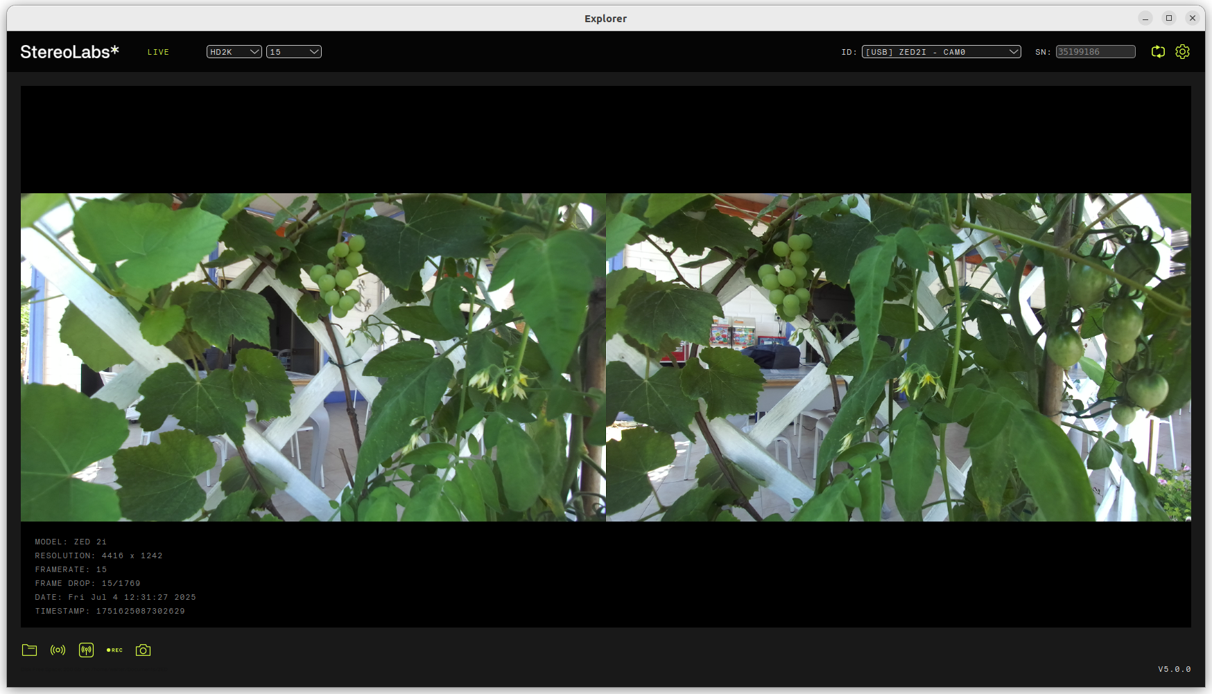

After connecting your camera and installing the ZED SDK, you can run ZED Explorer to visualize the camera feed and test its features.
ZED Explorer is an application for ZED live preview and recording. It lets you change video resolution, grab frequency, camera parameters, and capture high-resolution snapshots and videos.
Under Windows, you can find ZED Explorer in the Start menu under the ZED SDK folder. You can also run it from the command line by navigating to the ZED SDK installation directory: C:\Program Files (x86)\ZED SDK\tools\ZED Explorer.exe.
Under Ubuntu, you can run ZED Explorer from the terminal by typing ZED_Explorer or by navigating to the ZED SDK installation directory: /usr/local/zed/tools/ZED_Explorer.
Select the camera
When you launch ZED Explorer, it automatically detects all connected ZED cameras and opens the first available. You can select the camera you want to use from the dropdown menu at the top right of the window.
You can click on the arrows icon on the right side of the dropdown menu to refresh the dropdown content after unplugging and replugging one camera.
You can click on the gear icon on the right side of the serial number text field to open the Camera and Application Settings dialog.

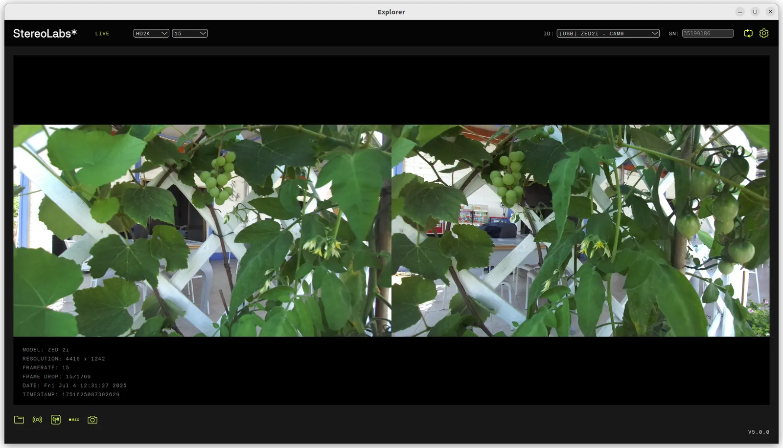

Select the video mode
You can select the resolution and framerate from the dropdown menus at the top left of the window. The available video modes depend on the camera model and its capabilities.
By default, the camera opens at the AUTO resolution, which resolves to the best default for the camera model (for example HD720 for USB cameras and HD1200 for GMSL cameras), consistent with the sl::InitParameters defaults. The ZED X One 4K opens in HD4K (15 FPS) by default (ZED SDK 5.5.1 and later). A resolution passed on the command line takes precedence.
Between the StereoLabs logo and the video mode dropdown, you can see the current playback mode: LIVE, SVO PLAYBACK, or STREAMING (NETWORK).
Monitor the Stream status
Under the video feed, you can see the camera status information, including:
  • Camera Model: The model of the connected ZED camera.
  • Resolution: The current video resolution.
  • Framerate: The current video framerate.
  • Frame Drop: The number of frames dropped during the current session.
  • Date and Time: The current date and time for live video feeds or the time of recording for SVO playback.
  • Timestamp: The timestamp of the current frame in nanoseconds.
For GMSL cameras, ZED Explorer also displays the physical GMSL port each camera is connected to, in the GUI and in the command line output (ZED SDK 5.2 and later).
Since ZED SDK 5.6, after a short USB disconnection, the camera reopens on its own within a few seconds and keeps its settings.

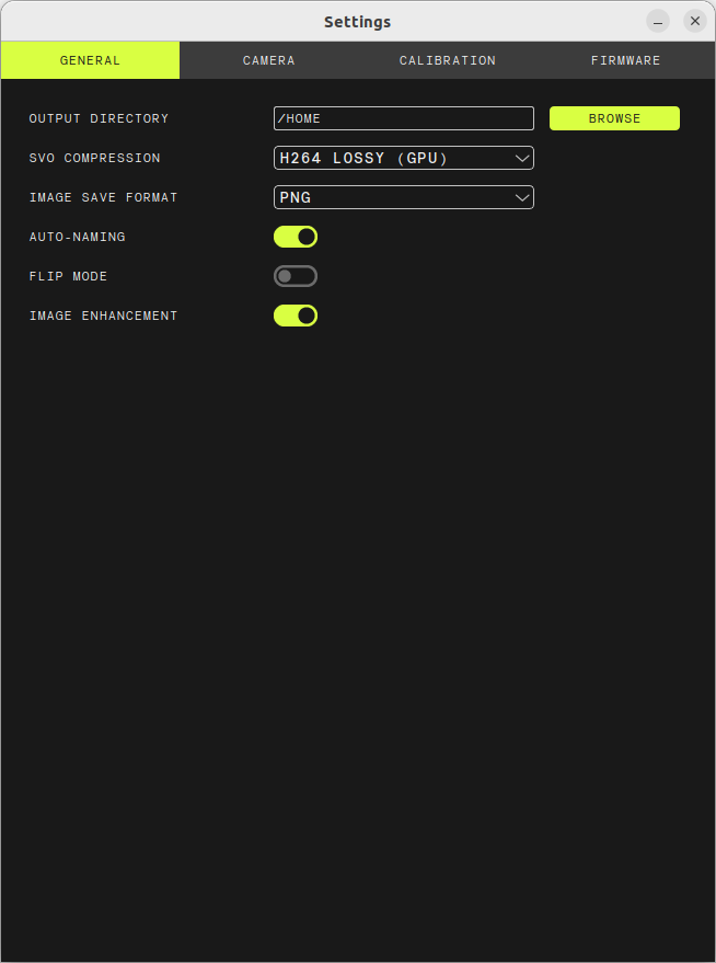

Application settings
In the Application Settings tab, you can configure the following options:
  • SVO and Screenshot Folder: The folder where SVO files and screenshots will be saved.
  • SVO Compression: The compression level for SVO files. Higher compression reduces file size but may affect image quality.
  • Image Save Format: The format for saving screenshots (PNG, JPEG, or BMP).
  • Auto Naming: Enable or disable automatic naming of SVO files and screenshots according to the current date and time.
  • Flip Mode: Enable or disable the flip mode for the video feed. This can be useful if the camera is mounted upside down or in a different orientation.
  • Image Enhancement: Enable or disable image enhancement features such as denoising and color correction.

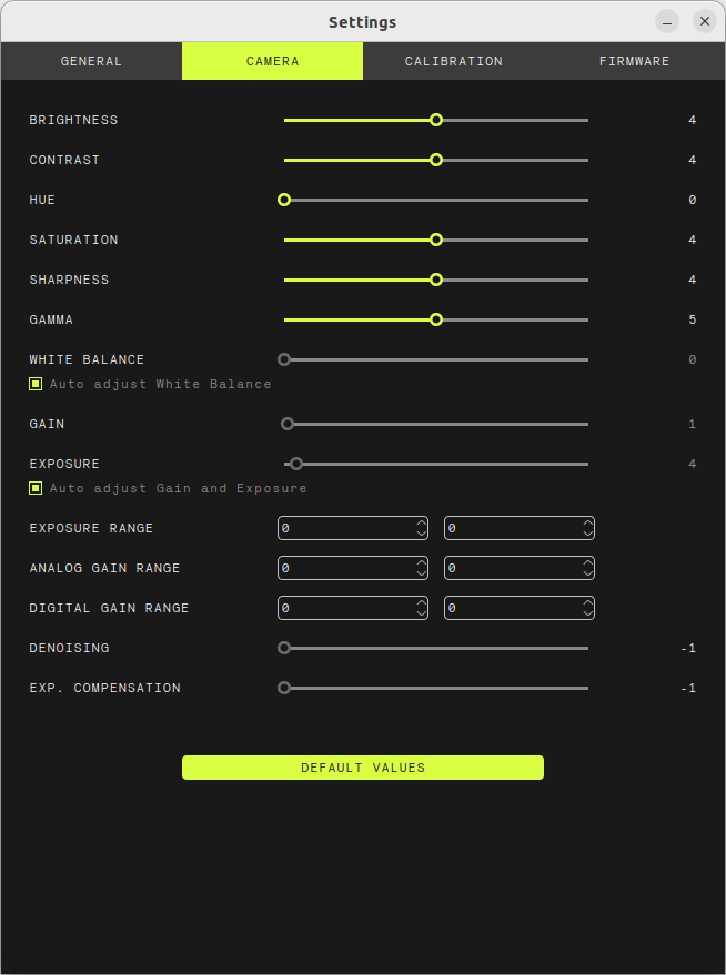

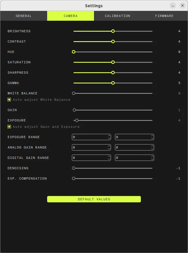

Camera settings
In the Camera Settings tab, you can control the camera parameters, including:
  • Brightness: Adjust the brightness of the video feed.
  • Contrast: Adjust the contrast of the video feed.
  • Saturation: Adjust the saturation of the video feed.
  • Hue: Adjust the hue of the video feed.
  • Gain: Adjust the gain of the video feed.
  • White Balance: Adjust the white balance of the video feed.
  • Exposure: Adjust the exposure of the video feed.
  • Sharpness: Adjust the sharpness of the video feed.
  • Gamma: Adjust the gamma of the video feed.
  • Auto Exposure: Enable or disable automatic exposure adjustment.
  • Auto White Balance: Enable or disable automatic white balance adjustment.
  • Exposure Range: Adjust the exposure range of the video feed.
  • Analog Gain Range: Adjust the analog gain range of the video feed.
  • Digital Gain Range: Adjust the digital gain range of the video feed.
  • Denoising: Adjust the denoising filter strength.
  • Exposure Compensation: Adjust the exposure compensation for the video feed.
These settings allow you to fine-tune the camera parameters to achieve the desired video quality and performance. You can adjust these parameters in real-time while the camera is streaming live or network streams.
Some of these parameters may not be available for all camera models or video modes. The available parameters depend on the camera model and its capabilities.
Click on the DEFAULT VALUES button to reset the camera parameters to their default values.
For the ZED X One 4K, ZED Explorer also lets you enable the HDR mode. Since ZED SDK 5.5.1, the HDR option is shown only when the camera and the resolution support HDR (HD1200 or QHDPLUS), and selecting a resolution that does not support HDR clears the setting.

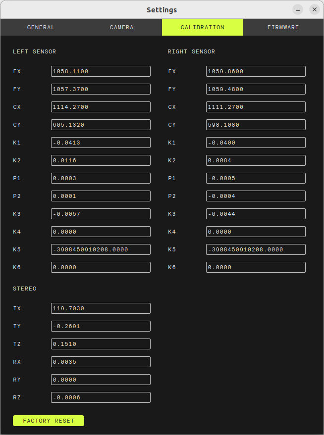

Calibration parameters
In the Calibration Parameters tab, you can view the raw calibration parameters of the camera. These parameters are used for 3D reconstruction and depth estimation. A description of the meaning of each parameter is provided in ZED SDK documentation. The tab also shows the focal length in millimeters (ZED SDK 5.0 and later).
You can click the FACTORY RESET button to reset the calibration parameters to the factory settings. This will overwrite any custom calibration you may have applied using the ZED Calibration tool.
The calibration parameters shown in this tab are the raw, unrectified values used internally by the ZED SDK for image rectification. When you access camera parameters through the ZED SDK in your applications, you will typically see “rectified” values, which may differ from those displayed here. For a detailed explanation of these differences, see this article.

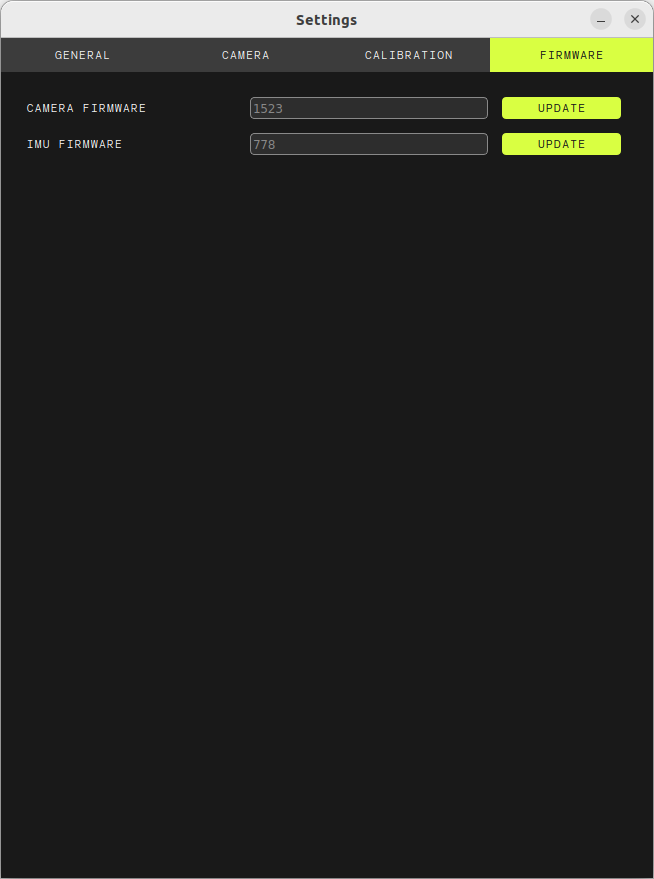

Firmware update
In the Firmware Update tab, you can check for firmware updates for your ZED camera and update it if a new version is available. The firmware is the software that runs on the camera hardware and controls its functionality.
Not all the ZED cameras support firmware updates. If your camera does not support firmware updates, this tab will be disabled.
