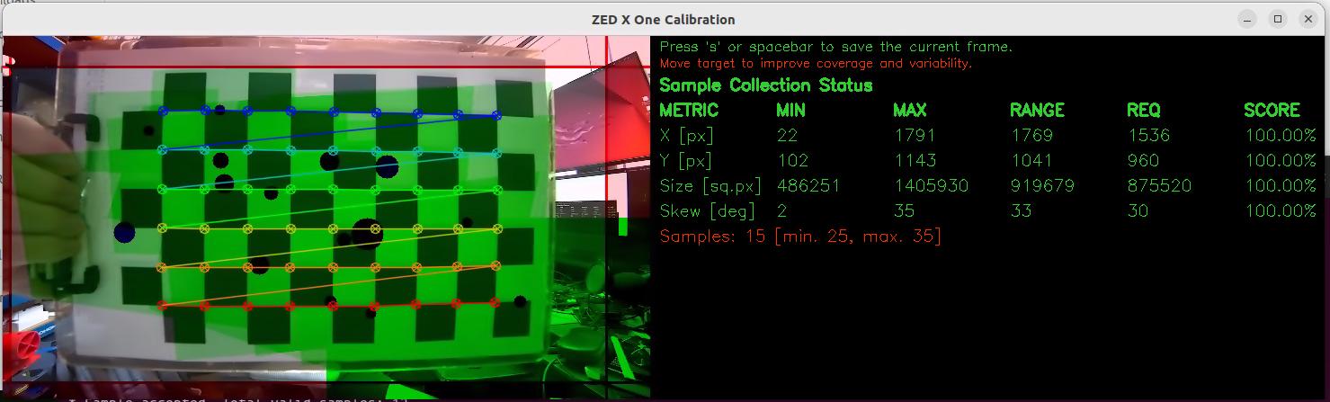

The Monocular Calibration Process
The monocular calibration follows the same two-phase approach as the stereo calibration:
  1. Data Acquisition: Move the checkerboard in front of the camera to capture diverse views. Press the Spacebar or the S key to save a frame when the board is fully visible and sharp. The tool enforces quality checks (sharpness, sample diversity) and shows real-time X/Y coverage, size range, and skew scores.
  2. Calibration Computation: Once sufficient data is collected (all metrics at 100% with the minimum number of samples, or the maximum sample count reached), the tool computes the calibration and saves two output files:

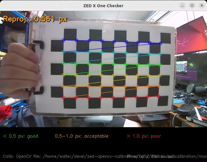

Monocular Calibration Checker
The Monocular Calibration Checker validates an existing monocular calibration by measuring the reprojection error in real time. Point the ZED X One at a checkerboard and the tool continuously detects the corners, projects 3D object points back onto the image using the active calibration, and displays the RMS reprojection error overlaid on the live feed.
The error is color-coded for instant feedback:
  • Green: below 0.5 px (good)
  • Orange: 0.5–1.0 px (acceptable)
  • Red: above 1.0 px (poor, recalibration recommended)

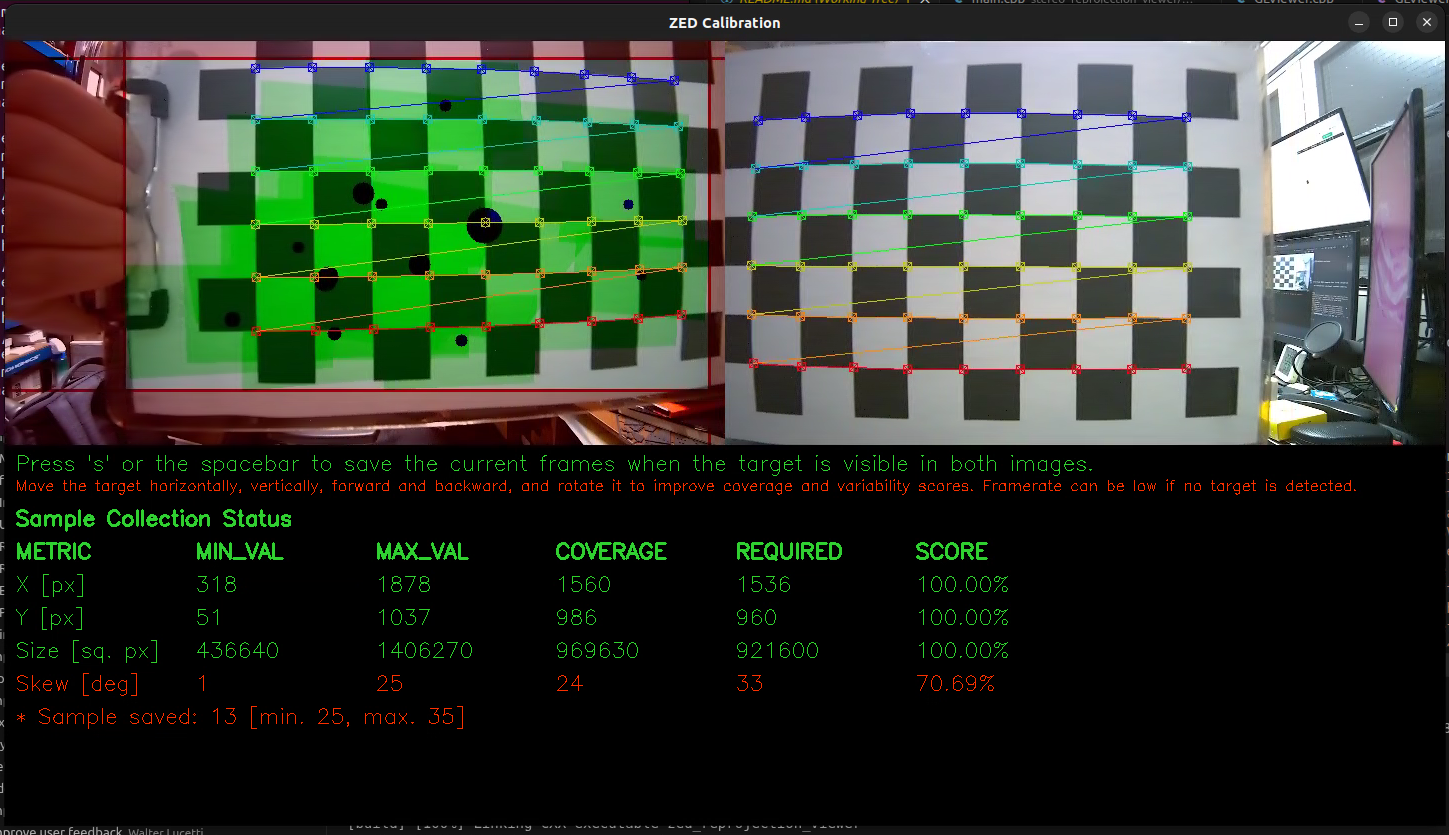

The Stereo Calibration Process
The calibration process consists of two main phases:
  1. Data Acquisition: Move the checkerboard in front of the camera(s) to capture diverse views. The tool provides real-time feedback on the quality of the captured data.
  2. Calibration Computation: Once sufficient data is collected, the tool computes the calibration parameters and saves them to two files.
During the Data Acquisition phase, the tool provides real-time feedback on the quality of the captured data regarding XY coverage, distance variation, and skewness.
When the checkerboard is placed in a position that you want to capture, press the Spacebar or the S key to capture the images.
  • If the checkerboard is detected in both images, and the captured data is different enough from the previously captured images, the data is accepted, and the quality indicators are updated.
  • If the data is not accepted, a message is displayed in the GUI output indicating the reason (e.g., checkerboard not detected, insufficient variation, etc.).
The blue dots that appear on the left image indicate the center of each checkerboard that has been detected and accepted so far. The size of the dots indicates the relative size of the checkerboard in the image (bigger dots mean closer to the camera).
In order to collect good calibration data, ensure that:
  • The checkerboard is always fully visible in both left and right images. Corners detected in both images are highlighted with colored visual markers.
  • The checkerboard moves over a wide area of the image frame. “Green” polygons appear on the left image to indicate the covered areas. When one of the 4 zones of the left image becomes fully green, the coverage requirement is met for that part of the image.
  • Red areas on the side of the left frame indicate zones that are not yet covered by the checkerboard. Try to make them as small as possible.
  • The checkerboard is moved closer and farther from the camera to ensure depth variation. At least one image covering almost the full left frame is required.
  • The checkerboard is tilted and rotated to provide different angles.
The “X”, “Y”, “Size”, and “Skew” percentages indicate the quality of the collected data for each criterion.
For X and Y, the minimum and maximum values correspond to the minimum and maximum position of the corner of the checkerboard closest to the image border. The COVERAGE indicates the size of the horizontal and vertical area covered by the checkerboard corners in the left image. The higher the coverage, the more the image is covered.
For Size, the minimum and maximum values correspond to the smallest and largest size of the checkerboard in the left image. The COVERAGE indicates the range of sizes of the checkerboard in the collected samples. A higher coverage means that the checkerboard was captured at a wider range of distances from the camera.
For Skew, the minimum and maximum values correspond to the minimum and maximum skewness angle of the checkerboard in the left image. The COVERAGE indicates the range of skew angles of the checkerboard in the collected samples. A higher coverage means that the checkerboard was captured at a wider range of angles. A value of 0° means the checkerboard is perfectly fronto-parallel to the camera; a theoretical maximum of 90° means the checkerboard is seen edge-on. Normally, the maximum achievable skew is around 40°.
If you cannot reach 100% for one of the metrics, ensure that it is as high as possible, and move the checkerboard to different positions to maximize the coverage by acquiring the maximum number of samples.
Here are some tips to improve each metric:
  • To raise the “X” and “Y” metrics, move the checkerboard to the edges and corners of the left image while keeping it fully visible in the right frame.
  • To raise the “Size” metric, move the checkerboard closer and farther from the camera. You must acquire at least one image where the checkerboard is covering almost the full left image and one where it is smaller and corners are barely detected [see the image below].
  • To raise the “Skew” metric, rotate the checkerboard at different angles. It is easier to obtain different skew values if the checkerboard is closer to the camera and rotated around the vertical and horizontal axes simultaneously.
The “Calibrate” process will automatically start when either of these conditions is met:
  • All metrics reach 100% and the minimum number of samples is collected.
  • The maximum number of samples is reached (even if not all metrics reach 100%).
For each metric, the GUI shows the following information in a table:
  • MIN_VAL: Minimum value stored in all the samples collected so far.
  • MAX_VAL: Maximum value stored in all the samples collected so far.
  • COVERAGE: The difference between the MIN_VAL and MAX_VAL, representing the range of variation in the collected samples.
  • REQUIRED: The minimum required value for the COVERAGE to consider the metric as satisfied.
  • SCORE: The percentage score for the metric, calculated as (COVERAGE / REQUIRED) * 100%.

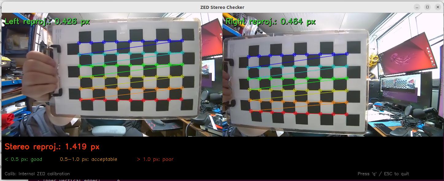

Good calibration results typically yield a reprojection error below 0.5 pixels for each calibration step.
If any reprojection error is too high, the calibration is not accurate enough and should be redone. Before recalibrating, verify the following:
  • The checkerboard is perfectly flat and securely mounted.
  • The checkerboard is well-lit with even, stable lighting.
  • Camera lenses are clean and free of smudges or dust.

Stereo Calibration Checker
The Stereo Calibration Checker validates an existing stereo calibration by measuring three reprojection errors in real time. Point the stereo camera at a checkerboard and the tool continuously detects corners in both images, then reports:
  • Left reproj.: RMS reprojection error on the left image (tests the left camera intrinsics).
  • Right reproj.: RMS reprojection error on the right image (tests the right camera intrinsics).
  • Stereo reproj.: Combined RMS error using the stereo constraint: the board pose from the left image is propagated via the calibrated rotation and translation to predict the right-image corners. This specifically tests the extrinsic calibration (R, T).
All three errors are color-coded and displayed live on the images:
