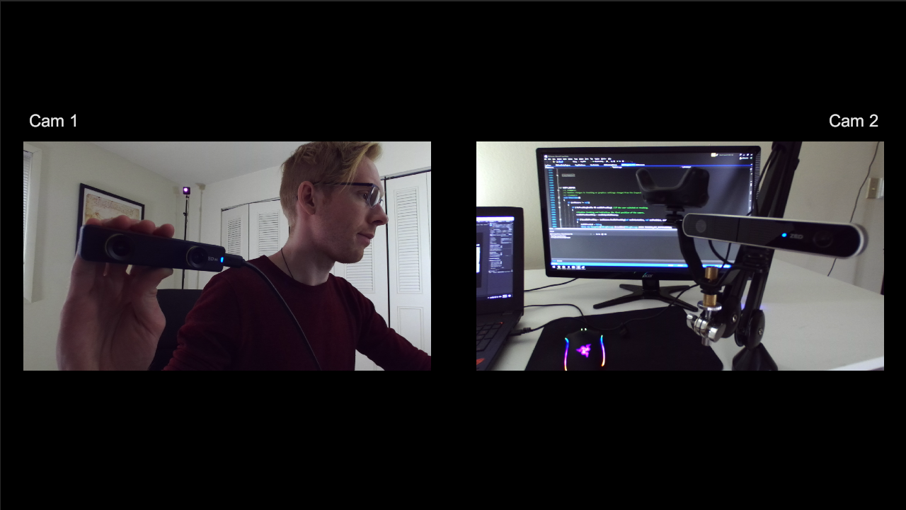

In this tutorial, you’ll learn how to enable mixed-reality capture with up to four ZED or ZED Mini cameras on a single computer at the same time.

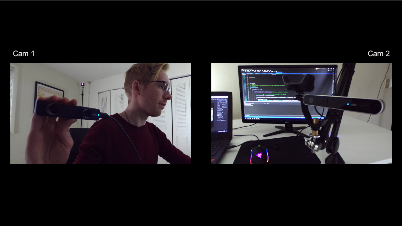

We’ll start with a scene displaying the output of two ZED cameras side by side. Then, we’ll set up a “streamer-style” scene like the video above, with AR passthrough showing in most of the image and a 3rd person view in the corner.

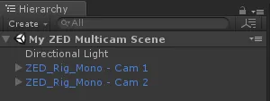

  • Click and drag two ZED_Rig_Mono prefabs into your scene
  • Rename the prefabs to ZED_Rig_Mono - Cam 1 and ZED_Rig_Mono - Cam 2

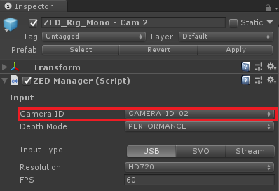

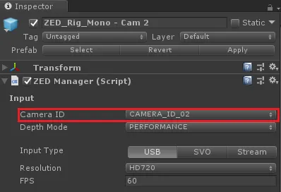

  • Select the second ZED rig and set its Camera ID value to CAMERA_ID_02
The Camera ID value tells the camera which ZED it should connect to. The number assigned to each ZED is defined by Windows, and the index of its USB connection to your motherboard. That means you’ll likely have to run the app to know which camera corresponds to which number, but once you find out, those numbers should stay the same if you leave the cameras plugged in to the same slots.
It’s important to know that only one ZEDManager can be connected to a ZED at the same time. Therefore, if multiple camera rigs have their Camera ID set to the same value, all but the first one will fail.

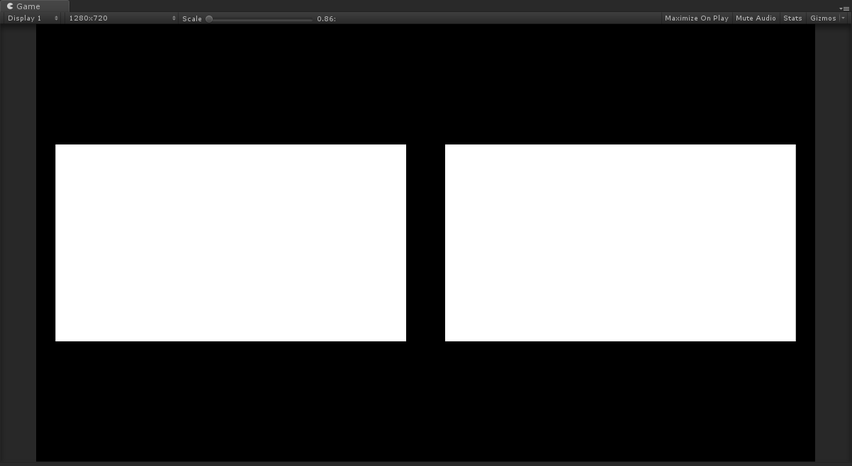

If you run the scene right now, you will only see video from one ZED in the Game view. Both ZEDs would be drawing, but the second one completely covers the first. We’ll set up a UI for handling this using a script included with the plugin.

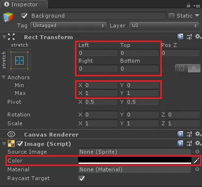

  • Right-click the Canvas and add a UI -> Image

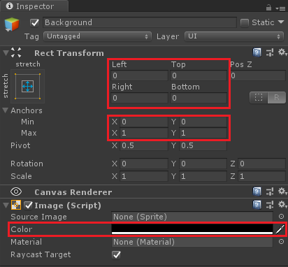

  • Click the new image and rename it “Background”
  • In its Inspector, set the Left, Right, Top and Bottom values in its RectTransform to 0
  • Under Anchors, set both Min values to 0 and both Max values to 1
  • In the Image component, set the color to black

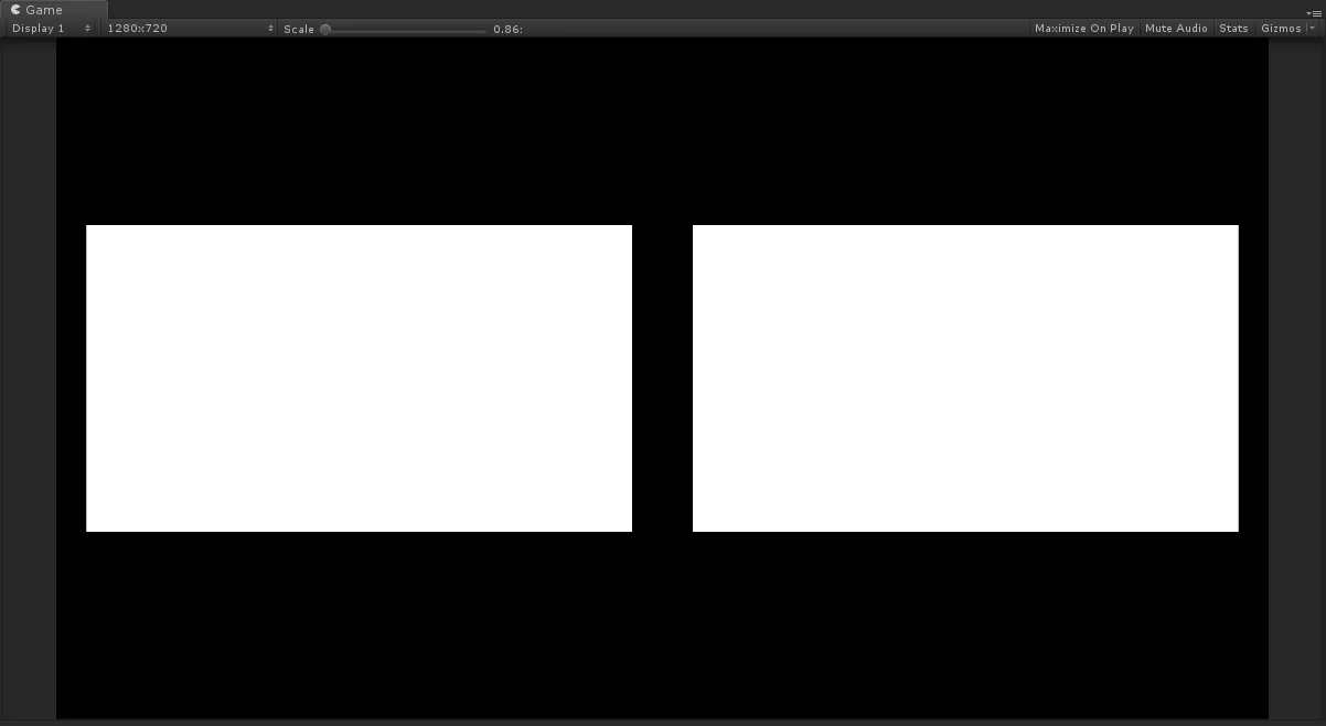

  • Right-click the Canvas object and add two UI -> RawImage objects
  • Rename the first RawImage to Camera 1 Image and the second to Camera 2 Image
  • In the RectTransform of both RawImages, set the Left, Right, Top and Bottom values to 0
  • Set Camera 1 Image’s Anchor values to Min X = 0.025, Max X = 0.475, Min Y = 0.275, Max Y = 0.725
  • Set Camera 2 Image’s Anchor values to Min X = 0.525, Max X = 0.975, Min Y = 0.275, Max Y = 0.725
You’ve likely guessed that these new white boxes will each show a different ZED’s output. We’ll use a simple script from the Multicam sample (import it from the Package Manager) to achieve this.

Run the scene.
If one camera refuses to connect, try changing the USB port. See our bandwidth troubleshooting guide if problems persist.

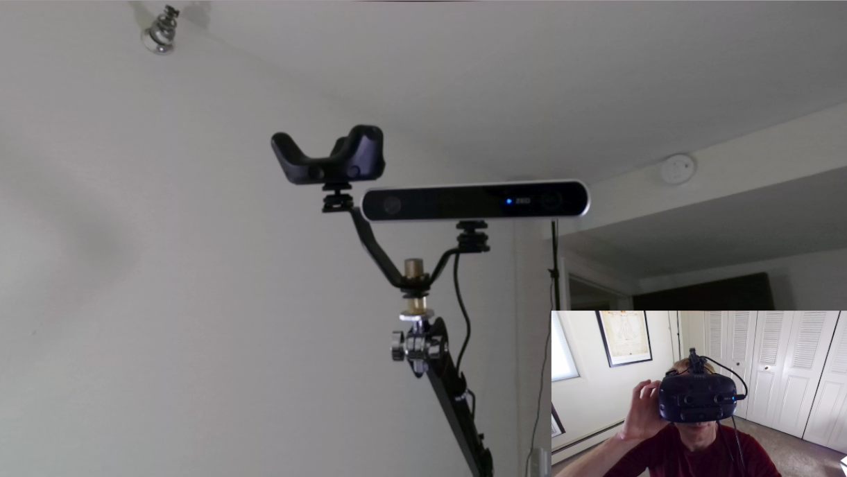

If you run the scene, you should see the same output as before in the Game view. But if you put on the headset, you’ll see the AR passthrough images like normal. All that’s left to do is rearrange the UI.
  • Set Camera 1 Image’s Anchors values to X Min = 0, X Max = 1, Y Min = 0, Y Max = 1
  • Delete Background as it’s now covered up by Camera 1 Image
  • Select Camera 2 Image
  • In the Inspector, set Camera 2 Image’s Anchors values to X Min = 0.65, X Max = 1, Y Min = 0, Y Max = 0.35
Run the scene. Your view should look like this:

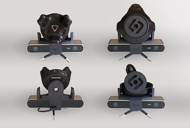

The simplest and most accurate way of tracking the cameras is with SteamVR and tracked objects. We’ll attach a Vive controller, Vive Tracker or Rift Touch Controller to each ZED camera and calibrate them. A ZED Mini attached to a tracked headset does not need a tracker, nor does it need to be calibrated.
We cover the steps to add Vive Trackers to ZED Cameras in detail in our Green Screen VR Capture tutorial. Here we provide a short version.

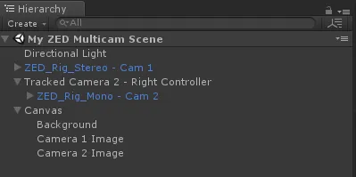

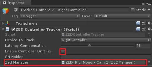

  • Create an empty GameObject in the scene for each ZED camera not attached to a VR headset, and rename it something descriptive (eg. Tracked Camera 2 - Right Controller)
  • Attach a ZEDControllerTracker component to each such GameObject
  • Set its DeviceToTrack setting to the type of object you wish to track
  • Uncheck Enable Controller Drift Fix as this is only for using controllers with AR pass-through and can cause tracking problems
  • Drag and drop the ZED_Rig_Mono object of the ZED it should track to its ZED Manager field, setting that field to the rig’s ZEDManager component
  • With the ZED_Rig_Mono object selected, uncheck Enable Tracking in the Inspector
  • Drag and drop that same ZED_Rig_Mono object again over that new GameObject in the Hierarchy, making it a child of it
