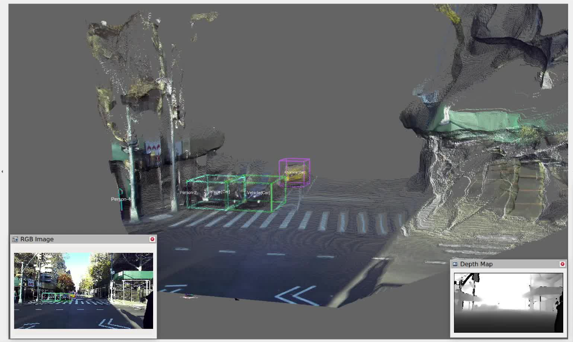

Object Detection results in RViz 2

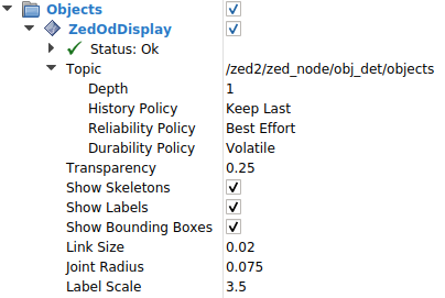

To visualize the results of the Object Detection processing in RViz 2, the ZedOdDisplay plugin is required. The plugin is available in the zed-ros2-examples GitHub repository and can be installed following the online instructions.
The source code of the plugin is a valid example of how to process the data of the topics of type zed_msgs/ObjectsStamped.
Parameters:
  • Topic: Selects the object detection topic to visualize from the list of available topics in the combo box.
  • Depth: The depth of the incoming message queue.
  • History policy: Set the QoS history policy. Keep Last is suggested for performance and compatibility.
  • Reliability Policy: Set the QoS reliability policy. Best Effort is suggested for performance and compatibility.
  • Durability Policy: Set the QoS durability policy. Volatile is suggested for compatibility.
  • Transparency: the transparency level of the structures composing the detected objects.
  • Show skeleton: Not used.
  • Show Labels: enable/disable the visualization of the object label.
  • Show Bounding Boxes: enable/disable the visualization of the bounding boxes of the detected objects.
  • Link Size: the size of the bounding boxes’ corner lines.
  • Joint Radius: the radius of the spheres placed on the corners of the bounding boxes.
  • Label Scale: the scale of the label of the object.
