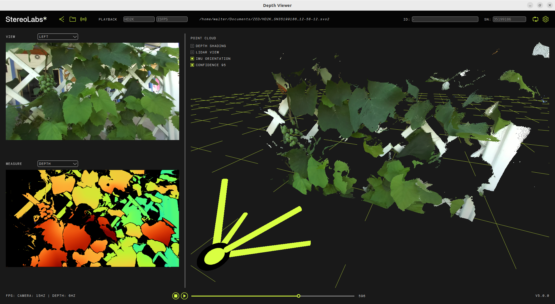

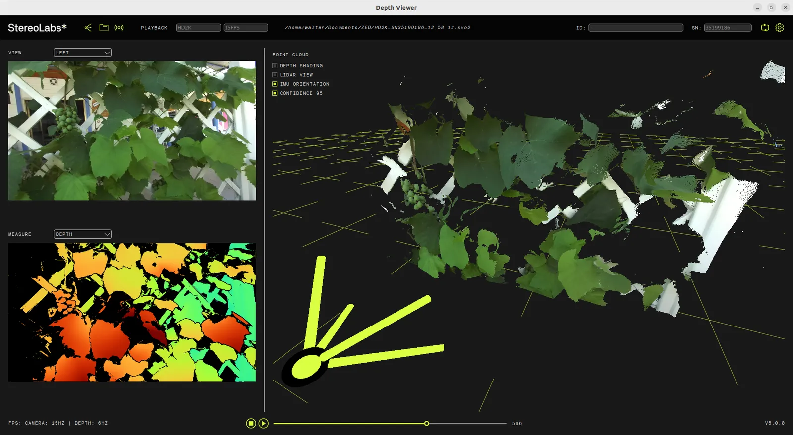

Visualize the data
The interface of ZED Depth Viewer is divided into three main sections:

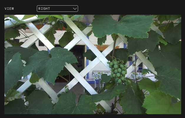

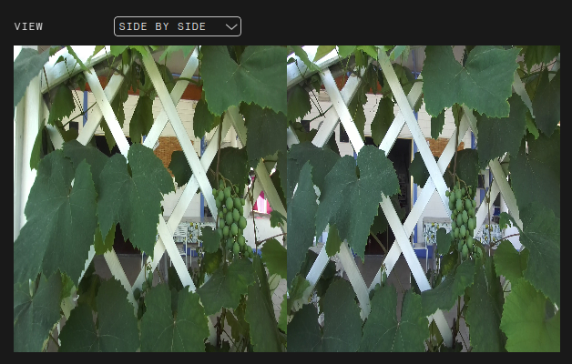

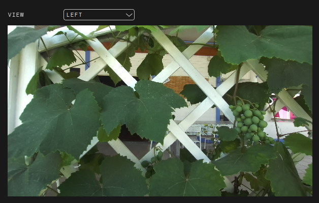

  • Color Video Feed: Displays the color video feed, allowing you to select between the left, right, or synchronized stereo side-by-side data.
LeftRightSide by Side

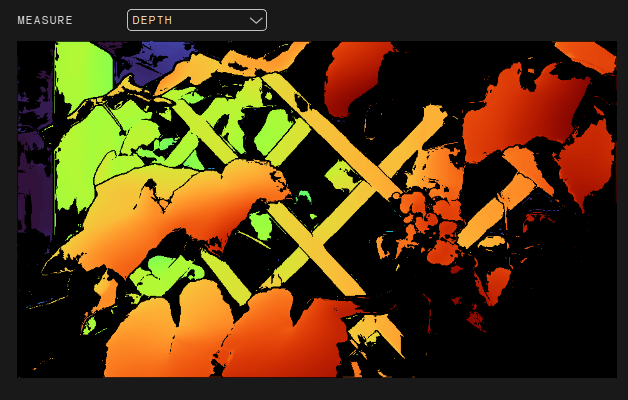

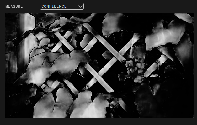

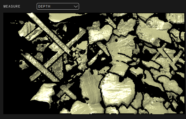

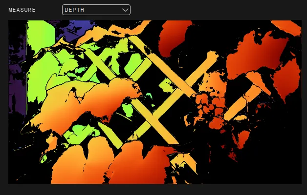

  • Depth Feed: Displays the depth map or the confidence map, depending on the selected mode.
Depth MapConfidence Map

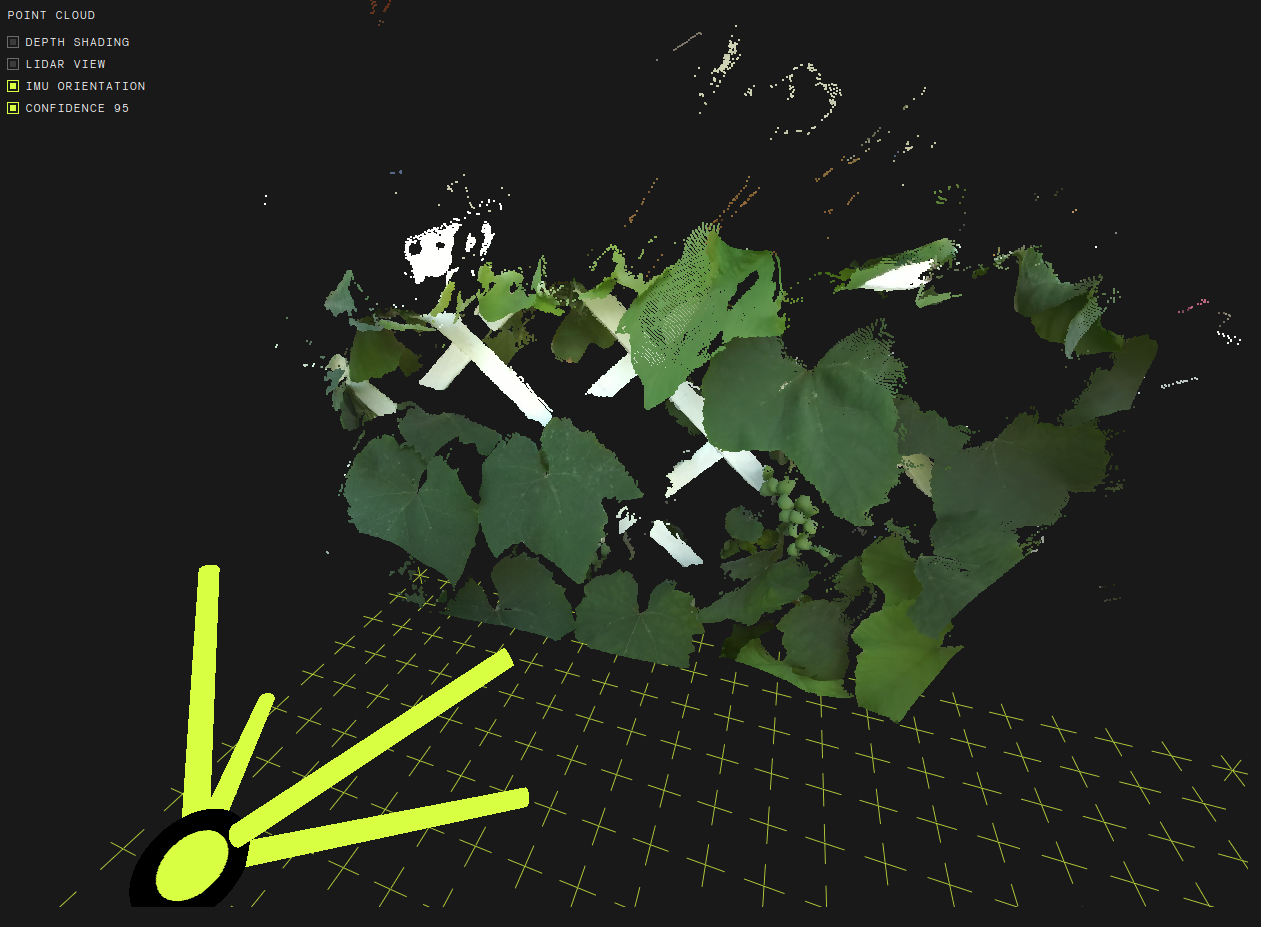

  • 3D Data Feed: Displays the point cloud generated from the stereo data.
    • You can rotate the camera view by clicking the left button and dragging the mouse in the 3D view.
    • You can zoom in and out by scrolling the mouse wheel.
    • You can pan the view by clicking the right button and dragging the mouse in the 3D view.
    • Since ZED SDK 5.6, each point is drawn at the size of the surface it covers, so surfaces stay closed when zooming in. The Point Size setting scales the points.
    • The view also slowly turns on its own, so the depth of the scene shows even when nothing moves. The rotation pauses while you drag the view. Turn it off with Auto Orbit in the point cloud options or with the D key; the choice is kept for the next launch.
By toggling the options at the top left of the interface, you can:
  • Enable/Disable the Depth Shading: toggle the depth shading effect on the depth map. image
  • Enable/Disable the Lidar View: transform the point cloud into a Lidar-like view, where points are colored based on their depth value.
  • Enable/Disable the gravity alignment: align the point cloud to the gravity vector using the IMU data from the camera. This is useful for applications that require a consistent orientation of the point cloud.
  • Quickly toggle between Confidence level 95 and 100: Allows you to quickly remove noisy points by filtering measures with lower confidence values.

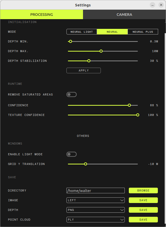

Configure the Application and Camera
Configure the application
In the Application Settings tab, you can configure the following options:
  • Depth Initialization: Depth settings to be tuned before opening the camera. Every modification will require a camera restart by clicking the APPLY button.
    • Depth Mode: Select the depth mode (NEURAL_LIGHT, NEURAL, NEURAL_PLUS, and NEURAL_MAX since ZED SDK 5.6) to adjust the depth quality and processing speed.
    • Depth Min.: Set the minimum depth range for depth processing.
    • Depth Max.: Set the maximum depth range for depth processing.
    • Depth Stabilization: Set the strength of the depth stabilization filter. Lower values result in less smooth but more reactive depth maps; higher values result in smoother depth maps that may appear blurred in dynamic scenes.
    • Depth Precision: Select the precision of the NEURAL depth modes (sl::InitParameters::depth_precision). INT8 trades a small amount of accuracy for a faster depth runtime and a lower memory footprint; FP16 remains the default. Available since ZED SDK 5.5 for NEURAL, and since ZED SDK 5.6 for NEURAL_LIGHT, NEURAL_PLUS and NEURAL_MAX.
    • On Jetson, select the processor that runs the NEURAL_LIGHT depth: GPU, DLA or PVA (experimental, see Depth Compute Device). A processor that cannot be used is greyed out. Available since ZED SDK 5.6.
  • Depth Runtime: Depth settings that can be modified while the camera is open.
    • Remove Saturated Areas: Enable or disable the removal of color image saturated areas in the depth map.
    • Confidence Threshold: Set the confidence threshold for depth data. Higher values result in more reliable depth data but may reduce the effective range.
    • Texture Confidence: Enable or disable texture confidence for depth processing.
  • Other settings:
    • Enable Light Mode: Switch the application window to light mode for better visibility in bright environments.
    • Grid Y Translation: Adjust the Y translation of the reference grid in the point cloud view.
  • Region of Interest (ROI): Draw a Region of Interest on the image. The mask is saved and can be loaded later by the ZED SDK. Available since ZED SDK 5.0.
  • Data Saving:
    • Directory: Set the directory where captured images, depth maps, and point clouds will be saved.
    • Image: Select the image to be saved (PNG format) between LEFT, RIGHT, SIDE BY SIDE, or DEPTH IMAGE. Click on SAVE to save the current image.
    • Depth: Select the format for saving depth maps (PNG, PFM, or PGM). Click on SAVE to save the current depth map.
    • Point Cloud: Select the format for saving point clouds (PLY, XYZ, PCD, or VTK). Click on SAVE to save the current point cloud.

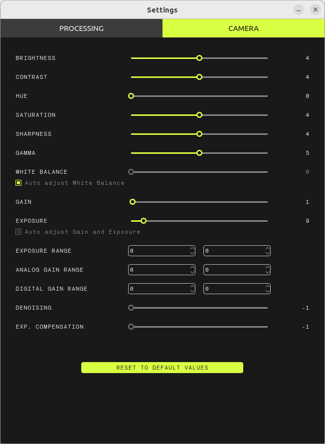

Configure the camera
In the Camera Settings tab, you can control different camera parameters:
  • Contrast: Adjust the contrast of the video feed.
  • Saturation: Adjust the saturation of the video feed.
  • Hue: Adjust the hue of the video feed.
  • Gain: Adjust the gain of the video feed.
  • White Balance: Adjust the white balance of the video feed.
  • Exposure: Adjust the exposure of the video feed.
  • Sharpness: Adjust the sharpness of the video feed.
  • Gamma: Adjust the gamma of the video feed.
  • Auto Exposure: Enable or disable automatic exposure adjustment.
  • Auto White Balance: Enable or disable automatic white balance adjustment.
  • Exposure Range: Adjust the exposure range of the video feed.
  • Analog Gain Range: Adjust the analog gain range of the video feed.
  • Digital Gain Range: Adjust the digital gain range of the video feed.
  • Denoising: Adjust the denoising filter strength.
  • Exposure Compensation: Adjust the exposure compensation for the video feed.
These settings allow you to fine-tune the camera parameters to achieve the desired video quality and performance. You can adjust these parameters in real-time while the camera is streaming live or network streams.
Some of these parameters may not be available for all camera models or video modes. The available parameters depend on the camera model and its capabilities.
Click on the DEFAULT VALUES button to reset the camera parameters to their default values.
