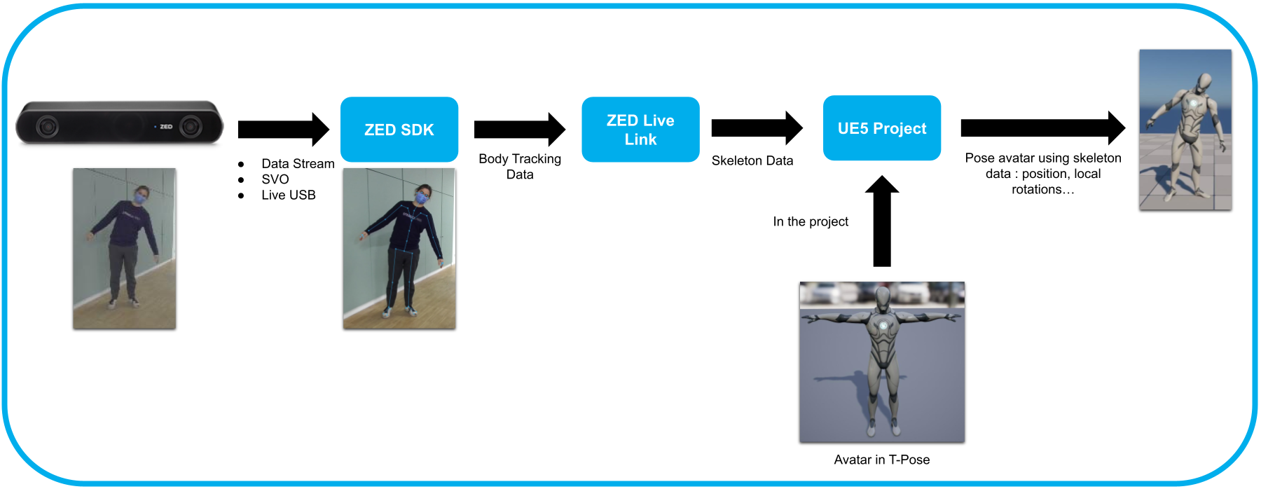

You can have an overview of the solution on the diagram below:
The machine running ZED Live Link will use the ZED SDK, so it should be installed, download it here. The Unreal Project can run on a separate machine (Windows or Linux). The plugin supports Unreal Engine 5.3 or later.
Live Link is a plugin designed to stream animation data coming from external sources to UE. You can get more information about this plugin in the UE5 Live Link doc. Our plugin uses its pipeline to stream skeleton data into UE5.

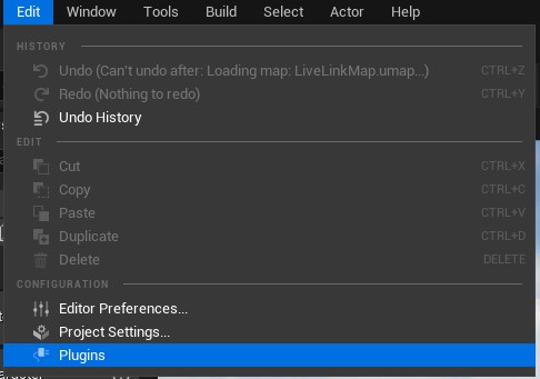

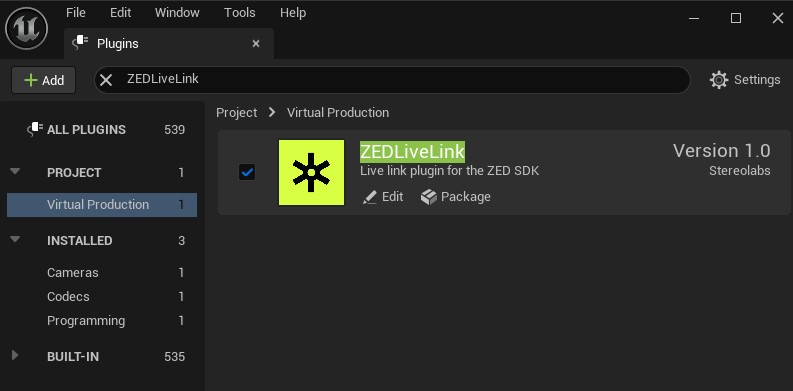

  • Navigate to Edit -> Plugins.
  • Under the Virtual Production section, click Enabled for Live Link, and Yes on the confirmation window, then restart the Editor.

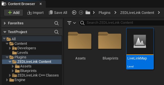

The plugin comes with a pre-set sample map, prepared with the necessary resources. You can use it as it is, or copy it to your project to build upon it.
It’s located at Plugins -> ZEDLiveLink Content -> LiveLinkMap.

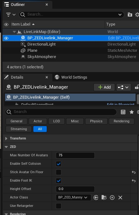

The scene contains a BP_ZEDLivelink_Manager blueprint with some useful settings.
  • Max Number of Avatars: Maximum number of body tracking detections.
  • Enable Self Collision: If true, the avatar will collide with itself, preventing limbs from disappearing into the avatar.
  • Enable Foot IK: Enable foot adjustments to prevent jitter and stick them to the ground when they should not be moving.
  • Height Offset: Manual Z-axis offset for the avatars.
  • Actor Class: The blueprint to use for the avatars.
  • Use Retargeter: Tick this if your avatar’s blueprint uses the UE5 retargeter to animate another model than the default one.
The Use Retargeter checkbox should be ticked only if you’ve put in place an Animation Retargeting system with the actor class passed to Actor Class (see Animate New Avatar). Else, there could be animation problems like avatar not showing or not moving.

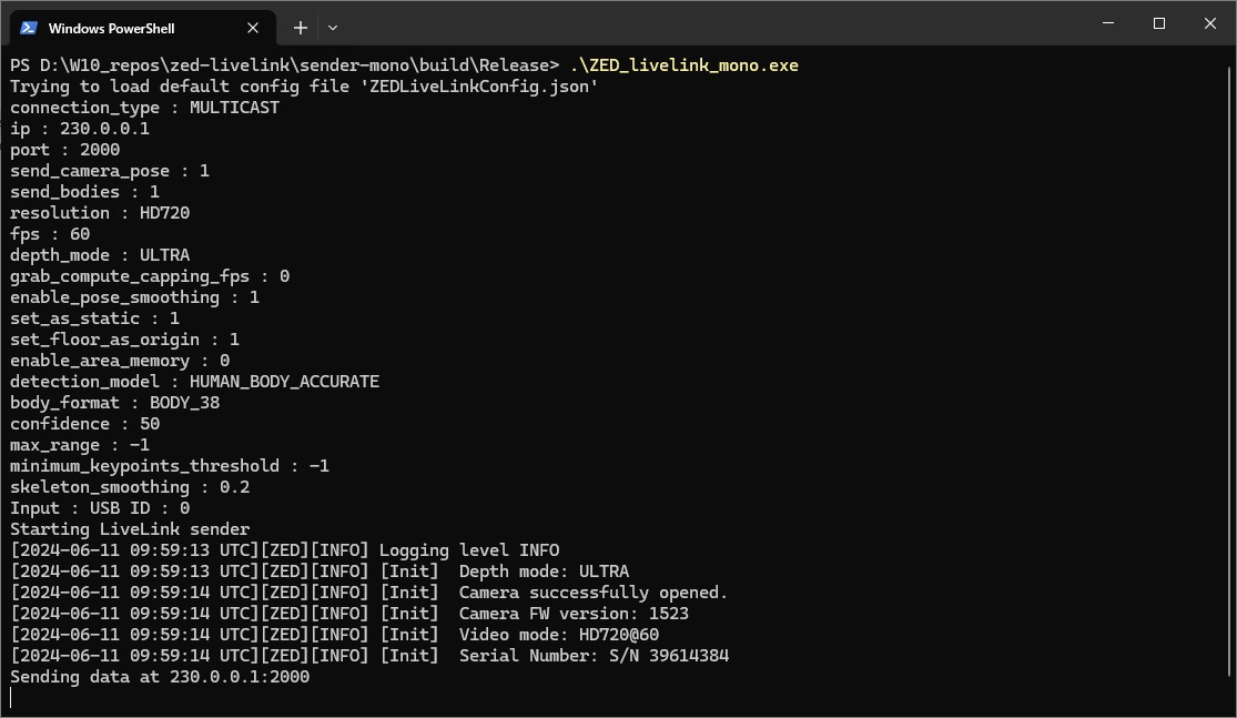

  • Open a terminal in the folder containing the ZED Live Link executable, and run
./ZED_livelink_mono
You can see the connection status and the parameters given in the config file in the terminal.

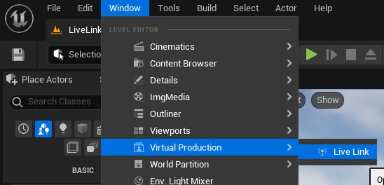

The “LiveLinkMap” level no longer automatically connects to a source at Start. Now, you need to do it manually by selecting a Source in the Live Link window.

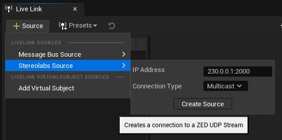

  1. Inside the UE5 Editor, from the Menu Bar under Window -> Virtual Production, select Live Link.
  1. In the Live Link window, click the Source button, then select Stereolabs Source.
  2. Set the IP address of the sender and the type of connection (Unicast or Multicast), then click Create Source.

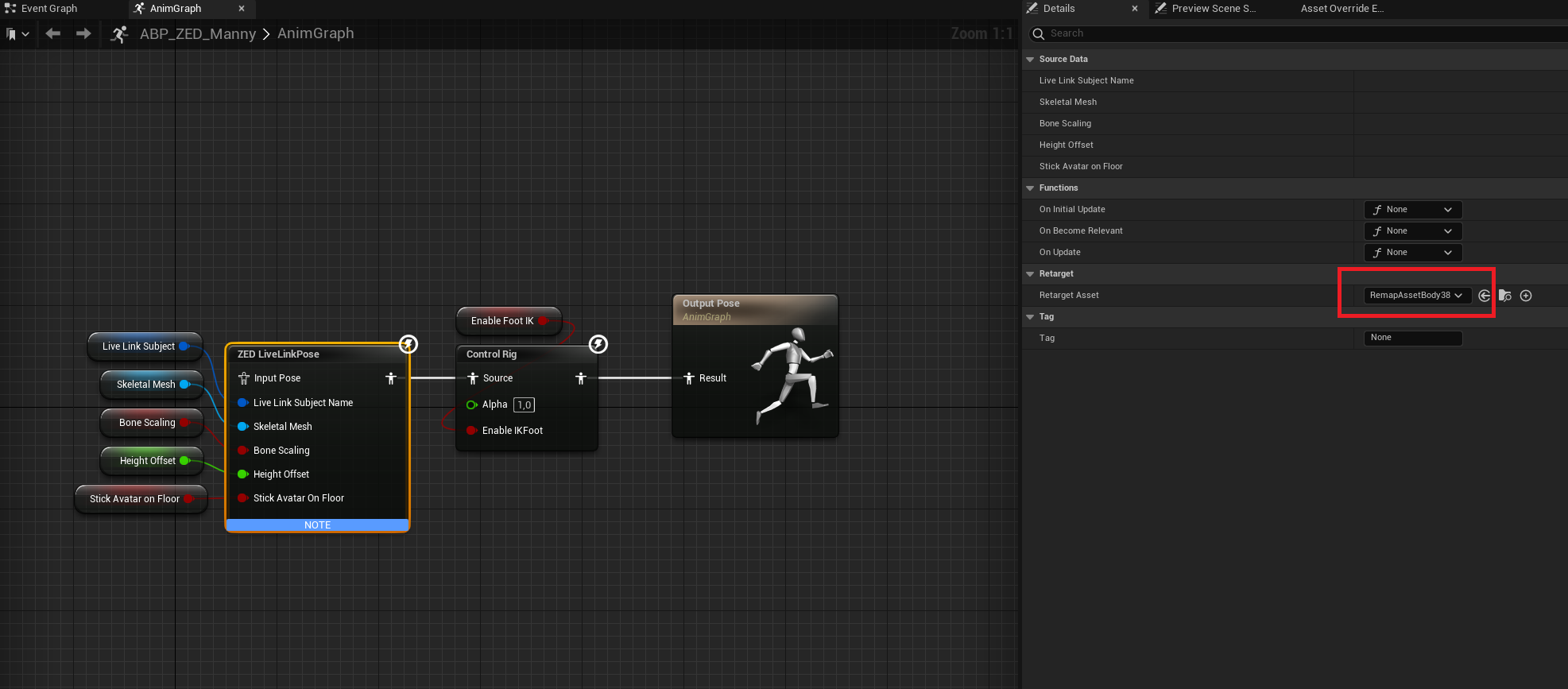

The ZED SDK now has multiple skeleton formats (Body 34 and 38) available for animating a 3D model. You can find more information about the body formats available in the ZED SDK on the Body tracking page. You need to make sure the correct remap asset is selected in the Anim Blueprint of the Actor you are using in your level. Indeed, each body format has its own remap asset (as the name and number of joints are different). The remap asset must be set in the Anim blueprint, in the ZED LiveLinkPose node.
For example, if you are using the Body format Body_38, open the ABP_ZED_Manny anim blueprint, select the ZED LiveLinkPose node, and, in the Details panel, set the Remap Asset field to RemapAssetBody38

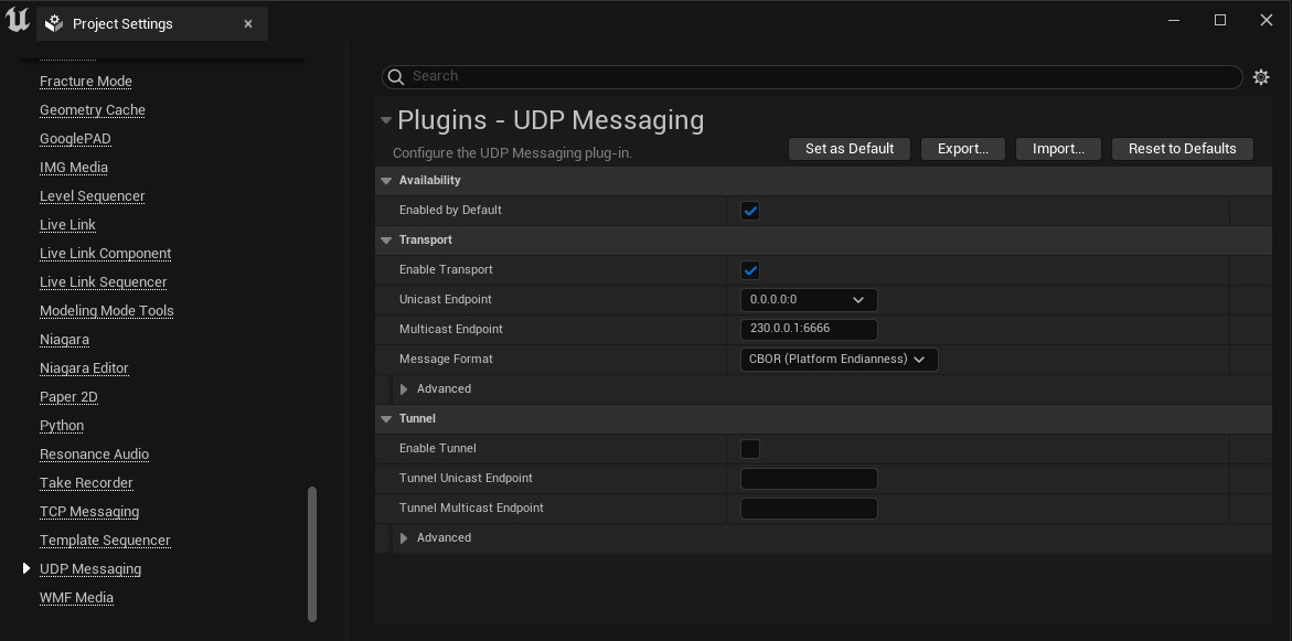

  • Your firewall might block the data stream. If you do not see the ZED Source in the Live Link window, try to disable it.
  • If the ZED Source is not yet detected in Unreal Engine, enable Enable by default in Edit -> Project Settings -> UDP Messaging.
