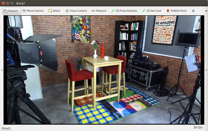

Displaying Images
The ZED node publishes both original and stereo rectified (aligned) left and right images. In RViz, use the image preview mode and select one of the available image topics. The main image topics are listed below:
  • rgb/image_rect_color: Color rectified image (left sensor by default)
  • rgb/camera_info: Color camera calibration data
  • rgb_raw/image_raw_color: Color unrectified image (left sensor by default)
  • rgb_raw/camera_info: Unrectified color camera calibration data
  • right/image_rect_color: Right camera rectified image
  • right/camera_info: Right sensor calibration data
  • right_raw/image_raw_color: Right camera unrectified image
  • right_raw/camera_info: Unrectified right sensor calibration data
  • confidence/confidence_map: Confidence map as a 32-bit floating point image
RGB

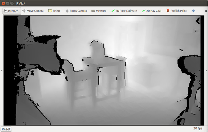

Displaying Depth
The depth map can be displayed in RViz with the following topic:
  • depth/depth_registered: 32-bit depth values in meters. RViz will normalize the depth map to 8-bit and display it as a grayscale depth image.
An OpenNI compatibility mode is available. Set the depth/openni_depth_mode parameter to true in params/common.yaml to get depth in millimeters and in 16-bit precision, and restart the ZED node.
Depth

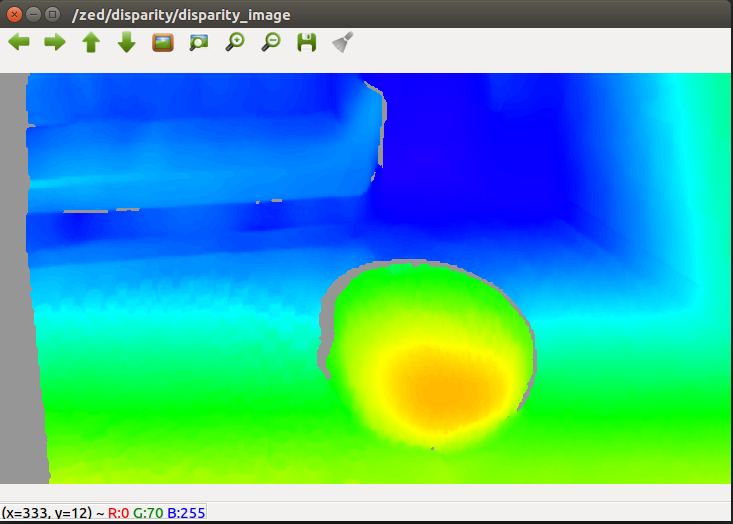

Displaying Disparity
The Disparity Image is available by subscribing to the disparity/disparity_image topic.
Launch the Disparity Viewer to visualize it:
rosrun image_view disparity_view image:=disparity/disparity_image
Disparity

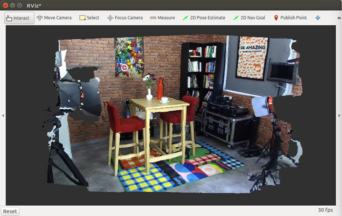

Displaying the Point cloud
A 3D colored point cloud can be displayed in RViz with the point_cloud/cloud_registered topic (for example /zed/zed_node/point_cloud/cloud_registered when using zed.launch).
Add a PointCloud2 display in RViz and select this topic. Note that displaying point clouds slows down RViz, so open a new instance if you want to display other topics.
Point Cloud

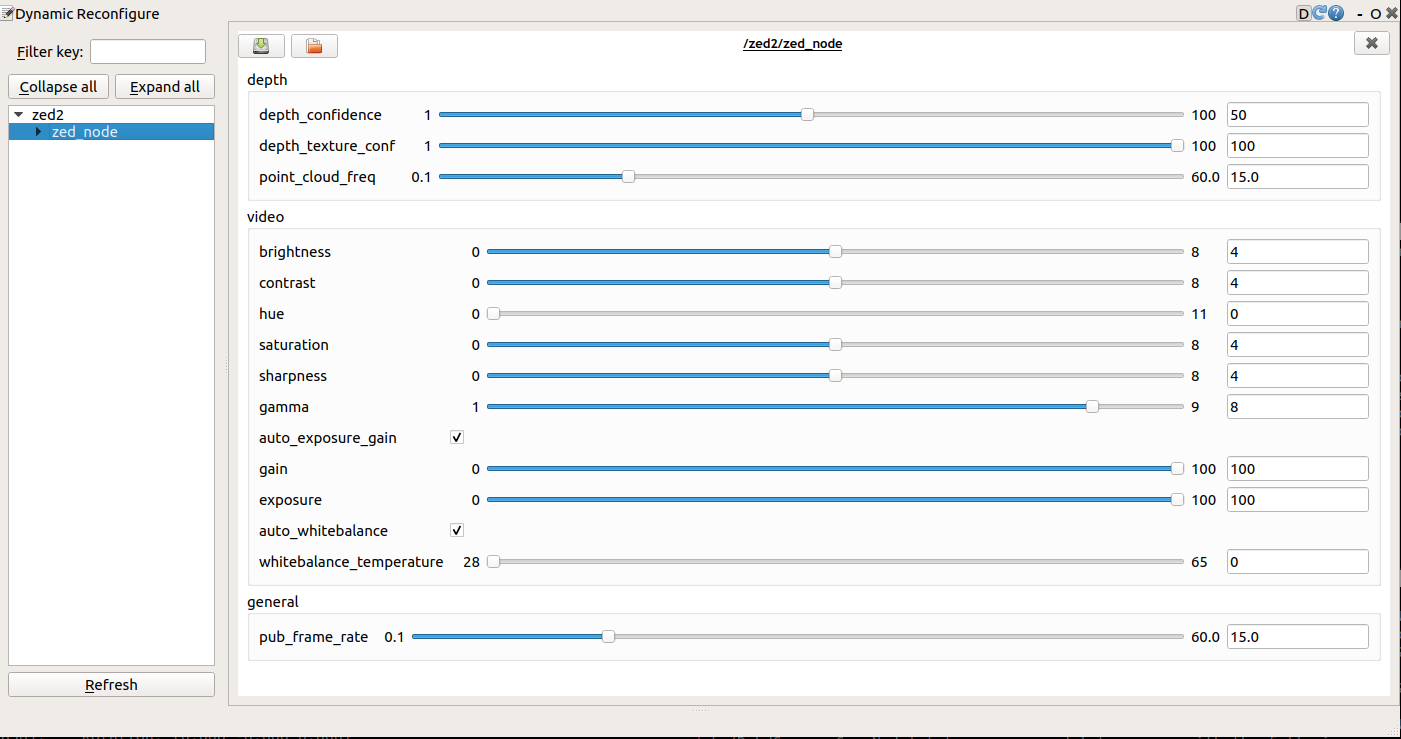

Dynamic reconfigure
You can dynamically change many configuration parameters during the execution of the ZED node.
You can set the parameters using the command dynparam set followed by the node name, e.g. with zed.launch:
rosrun dynamic_reconfigure dynparam set /zed/zed_node depth_confidence 80
or you can use the GUI provided by the rqt stack:
rosrun rqt_reconfigure rqt_reconfigure
The full list of available dynamic parameters is available here.
RQT Reconfigure
