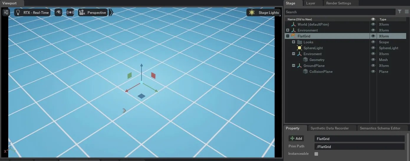

The environment in Isaac Sim consists of a Stage (panel to the right) that holds all of the assets in the USD scene. To have a working simulation with physics, you need to:
- Create a physics scene that enables physics simulation and gravity.
- Add a ground plane that prevents objects from falling infinitely.

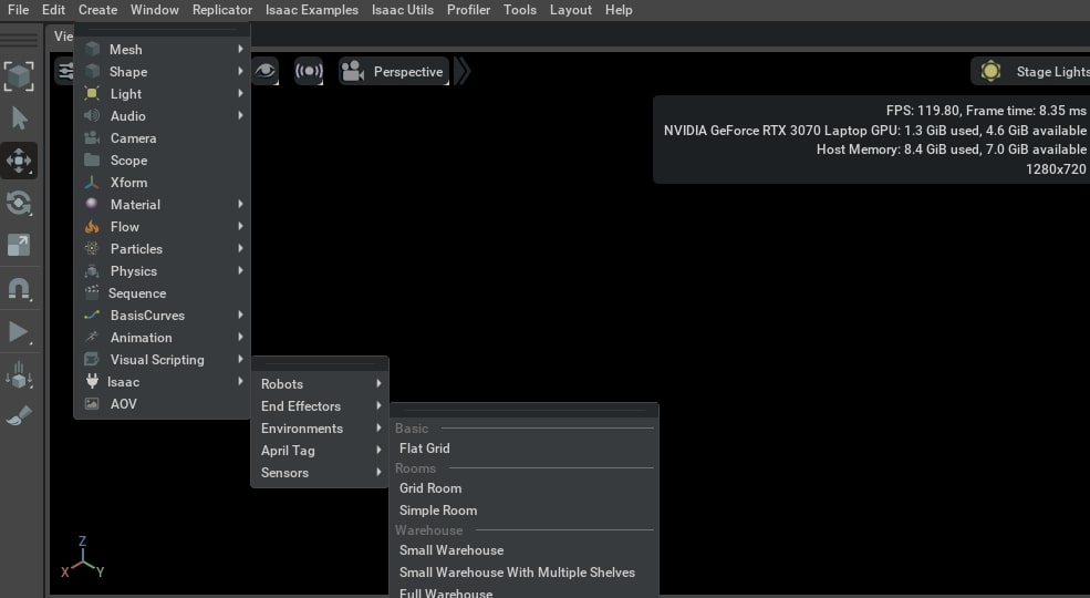

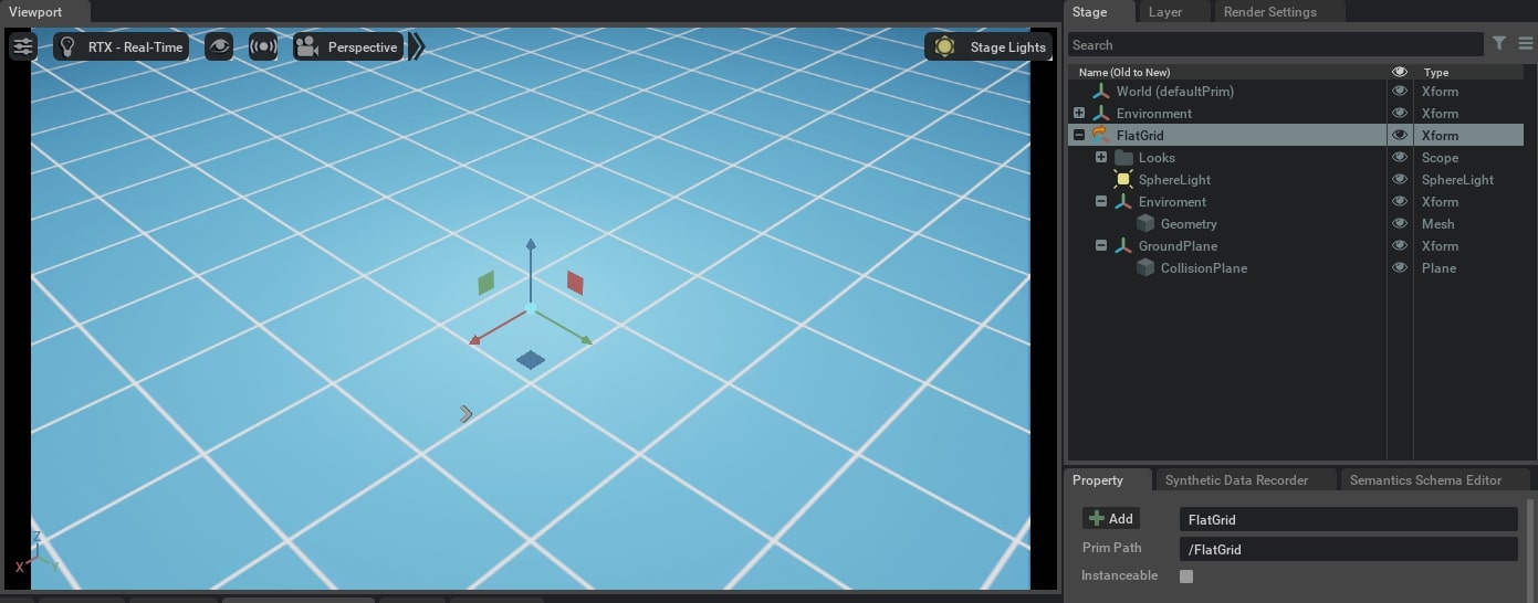

A quick way to explore these things is to use a predefined environment by going to the top menu bar Create -> Isaac -> Environments and choosing the Flat grid as it is the simplest one.
You will notice that the stage has been populated by items with different prims (Prim is short for primitive, the fundamental container object in Omniverse). The window that shows the flat grid is called the Viewport.

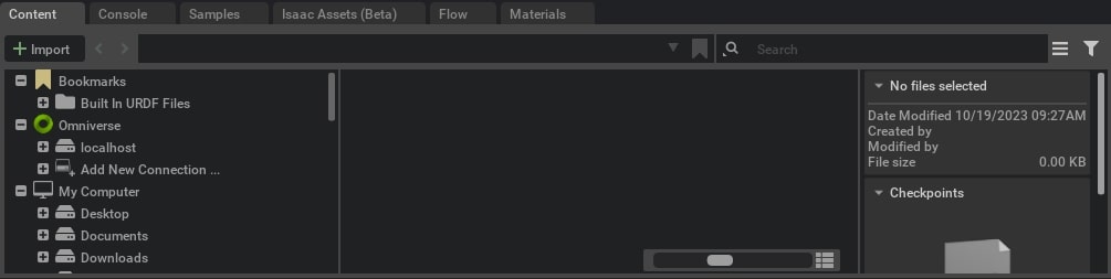

You can use the Content and Isaac Assets panels located at the bottom of the window to add prims to the stage.
The Content tab lets you look for files located on your machine while the Isaac Assets tab shows all of the available assets in Isaac Sim. To add an item simply drag it into your scene or the stage panel.

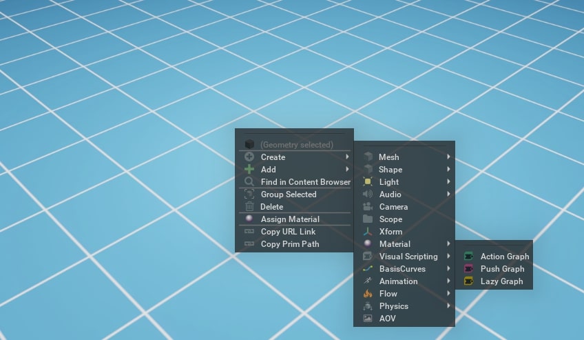

To create an Action graph, right-click anywhere in the viewport and select Create -> Visual Scripting -> Action graph
A new action graph appears in the Stage view, and the related Action Graph panel is now open at the bottom of the screen.

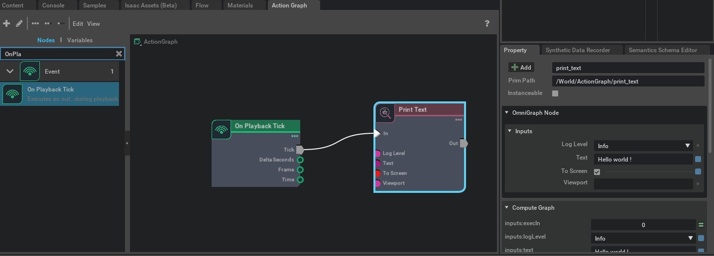

Start typing “OnPlaybackTick” in the search bar on the left side of the panel to find the node. Then drag and drop it into the graph. Do the same for the “Print Text” node.
Connect the Tick of the OnPlaybackTick to the In of the Print Text. Then click on the Print Text node and fill out its properties in the Property panel on the right.
You can experiment with different settings to print on the screen (viewport) or on the Console tab. To execute the graph, simply press play (to trigger a playback tick) and you should see the printed text.
