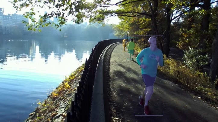

3D Object Detection
The ZED SDK detects all objects present in the images and computes their 3D position and velocity. The distance of the object from the camera is expressed in metric units (ex. meters) and calculated from the back of the left eye of the camera to the scene object.
The SDK also computes a 2D mask that indicates which pixels of the left image belong to the object. From there, the ZED can output the 2D bounding boxes of the objects and accurately compute the 3D bounding boxes with the help of the depth map.
The bounding boxes of the objects can be displayed over the image or the point cloud as depicted in the image above. For more information on how to display the bounding boxes and the object mask, please see our Object Detection sample.

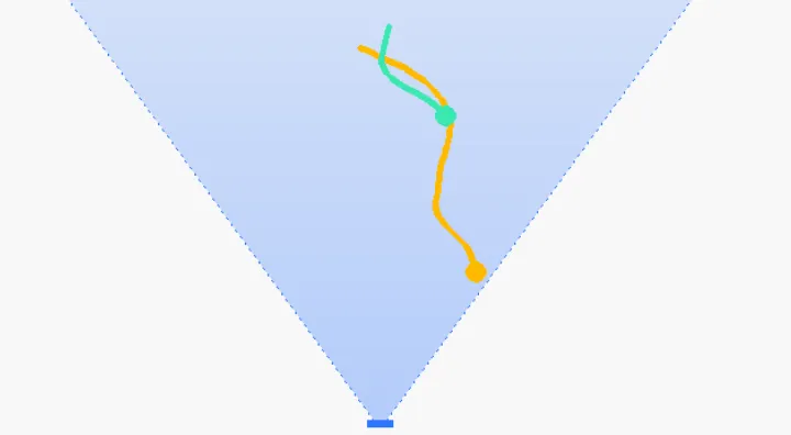

3D Object Tracking
If the positional tracking module is activated, the ZED SDK can track the objects within the environment. This means that the detected object will keep the same ID throughout the sequence, allowing the objects’ paths to be displayed over time. The object detection sample includes a view of these paths, as depicted below:
