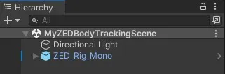

  • Create a new scene and delete the Main Camera
  • In the Project window, go to Packages -> ZED SDK -> Prefabs and drag ZED_Rig_Mono into the Hierarchy

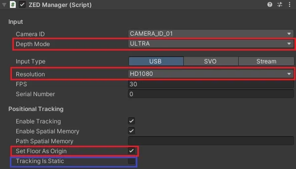

  • Select the new ZED_Rig_Mono in the Hierarchy.
  • In the Positional Tracking section, make sure Set Floor As Origin is checked. This enables floor detection.
  • In the Inspector, set the Resolution to 1080p. This is not required but increases body tracking accuracy
  • Keep a neural Depth Mode (NEURAL is the default). The legacy ULTRA mode is deprecated since ZED SDK 5.0.
  • If your camera is fixed and will not move, enable Tracking Is Static to prevent incorrect drift throughout the scene.

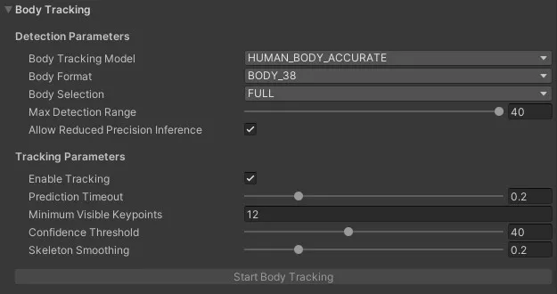

Body Tracking Settings
Scroll down to the Body Tracking section.
Choose the Body Tracking Model you want, depending on your accuracy/performance needs.
Three body formats are available; you can refer to the Body Tracking Documentation.
Multiple settings are available:
  • Body Tracking Model: AI model for detection. You can choose between HUMAN_BODY_FAST (fast, but less accurate), HUMAN_BODY_MEDIUM (less fast, but more accurate), and HUMAN_BODY_ACCURATE (most accurate, but slower) to track people’s poses.
  • Body Format: Body format to use with body tracking. Find more information on the Body Tracking page. Note that you will not be able to animate an avatar out-of-the-box using BODY_18, as our sample uses the fitting’s rotational data, computed for BODY_34 and above.
  • Body Selection: Sets the keypoints that will be given by the ZED SDK. Full: all keypoints of the body format. Upper body: Only the keypoints from the hips up (arms, head, torso).
  • Max Detection Range: Defines an upper depth range for detections (in meters).
  • Allow Reduced Precision Inference: Allows inference to run at a lower precision to improve runtime and memory usage.
  • Enable Tracking: If enabled, the ZED SDK will track bodies between frames, providing more accurate data and giving access to more information, such as velocity.
  • Prediction Timeout: Duration during which the SDK will predict the position of a lost body before its state is switched to SEARCHING.
  • Minimum Visible Keypoints: Sets the minimum number of keypoints needed for the ZED SDK to detect a person.
  • Confidence Threshold: Sets the minimum confidence value for a detected person to be published. Ex: If set to 40, the ZED SDK needs to be at least 40% confident that a detected person exists.
  • Skeleton Smoothing: Amount of smoothing applied at the body fitting phase in the Body Tracking module of the ZED SDK. Bigger values mean more latency and smoother movements, and lower values lead to a crispier animation with less interpolation, which is better for quick movements.
Last is the “Start Body Tracking” button. Normally, the Body Tracking module doesn’t start when the ZED does because it causes a long delay. This button is one of two ways to start the module. The other is via a script, which we’ll be doing here.

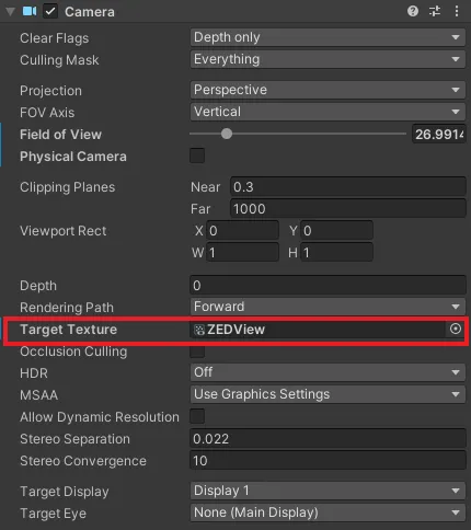

  • In the ZED_Rig_Mono prefab, drag the ZEDView target texture to the Target Texture of the Camera_Left.

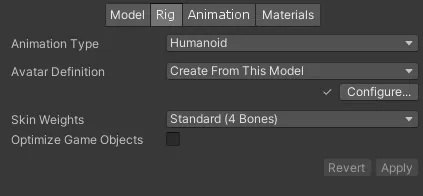

  • Import your model in Unity.
  • In the Rig tab, set the Animation Type to Humanoid and Apply.

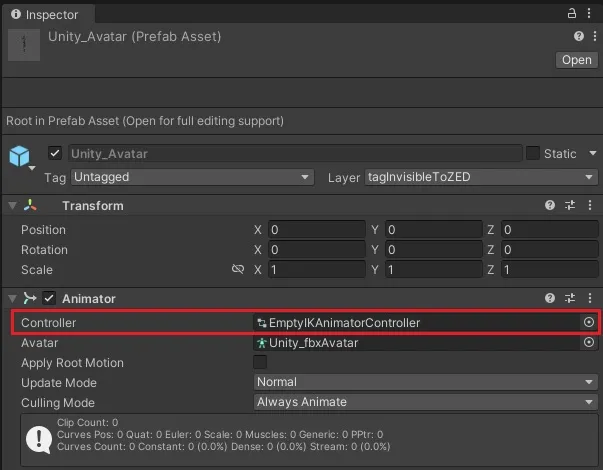

  • Create a prefab of this model and add an Animator component and a ZEDSkeletonAnimator component to it.
  • Add an EmptyIKAnimatorController to the Animator in your prefab. This is an empty AnimatorController with the IK pass enabled. Even if you don’t plan to use the Foot IK features, this is necessary as the animation will be done in the IK pass phase.
  • Set Raycast Detection Layers to tagInvisibleToZED in the IK SETTINGS of the ZEDSkeletonAnimator component. This is used for both the Automatic Offset and the Foot IK.
  • In the ZEDBodyTrackingManager, put your prefab into the Avatar field in the Inspector.

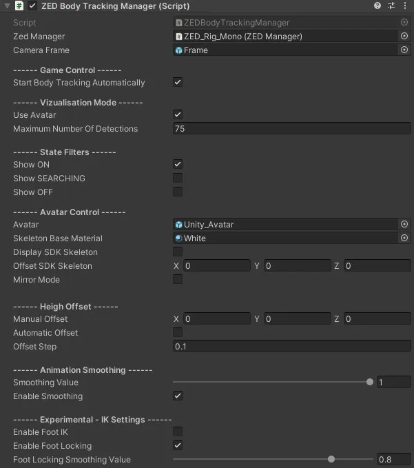

ZED Body Tracking Manager settings
The ZED Body Tracking Manager provides a variety of settings to control the animation of the avatars from the Body Tracking data.
Game Control
  • Start Body Tracking Automatically: Launch the Body Tracking as soon as the ZED is initialized.
Visualization Mode
  • Use Avatar: To display or not the avatar animated with the joints’ rotations of the SDK.
  • Maximum Number Of Detections: Maximum number of detected bodies whose data will be transmitted to the Unity plugin.

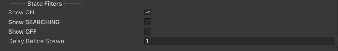

State Filters
  • SHOW ON/SEARCHING/OFF: Filters which detected bodies should be rendered in the scene, depending on their tracking_state.
  • Delay Before Spawn: Delay before making an avatar appear. When a person is detected, a countdown of this much time will be started, and when it ends the tracking_state will be checked. If it passes the filters, the avatar is spawned. Use this setting along with the minimum keypoints and confidence thresholds to reduce popups of avatars in some cases like partial occlusion and subjects at the edges of the ZED’s field of view.
If SHOW OFF is enabled, some NaN values may be given by the body tracking module, so some errors may happen. In general, you will want to leave this off.

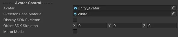

Avatar Control
  • Avatar: Prefab of Avatar to use.
  • Skeleton Base Material: Material that will be applied to the SDK Skeleton render.
  • Display SDK Skeleton: If the “stickman” representation of the body tracking data from the ZED SDK should be rendered or not.
  • Offset SDK Skeleton: Offset to apply to the stickman representation.
  • Mirror Mode: If the body tracking positions and rotations should be mirrored or not.
Height Offset
  • Manual Offset: Fixed offset to apply to all avatars. Ignored if Automatic Offset is enabled.
  • Automatic Offset: If each avatar should be automatically adjusted to have its feet on the ground, and not under or above. This uses raycasting to reposition the root depending on the feet’s distance to the ground.
  • Offset Step: How much the manual offset will be adjusted when using the corresponding keys.
Animation Smoothing
  • Enable Smoothing: Enable or not the animation smoothing. This does not impact the performance of the SDK, it just smooths the avatar at Unity level.
  • Smoothing Value: Value to smooth the avatar’s movements, making the animation update rate independent from the body tracking rate. 0 means no smoothing, so at body tracking FPS, and 1 means the maximum smoothing will be applied.
You might want to check out this setting if your avatar is very slow or not following your movements.

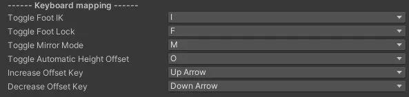

Keyboard mapping
  • These are toggles for the Body Tracking features and key mappings to increase and decrease the manual height offset.

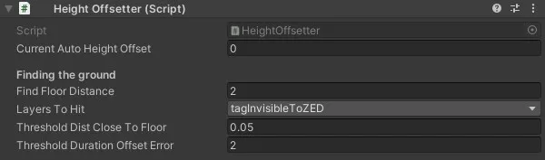

Automatic Offset
The automatic offset is determined by the shortest distance between each foot and the ground so that both feet are above the ground. This offset is recalculated if both feet are not on the ground for a set amount of time.
  • Current Auto Height Offset: Used to check and access the current automatic offset value.
  • Find Floor Distance: Maximum distance from the foot to detect the floor, either above or under it.
  • Threshold Dist Close To Floor: Acceptable distance to the ground to deem the automatic offset correct. Above this value, the automatic offset will be deemed incorrect, but under it, the timer for updating the automatic offset is reset.
  • Threshold Duration Offset Error: Amount of time after which the automatic offset will be updated, if it’s deemed wrong (both feet not on the ground) continuously.

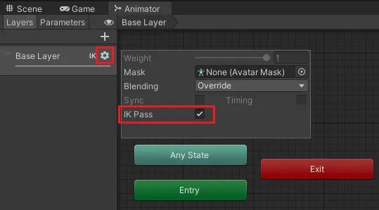

Animator Controller
An empty animator controller with the IK pass enabled must be given to the animator component for the animation to work. One is available at Assets/Samples/ZED SDK/<version>/Body Tracking/Prefabs/Avatar/EmptyIKAnimatorController.controller.

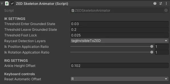

IK Settings
The more the feet get close to the virtual ground, the more the feet IK feature will be applied if it is enabled.
  • Threshold Enter Grounded State: Distance between the sole and the virtual floor under which the IK will be fully applied.
  • Threshold Leave Grounded State: Distance between the sole and the virtual floor under which the IK will begin to apply progressively. Above it, the IK is not applied at all.
  • Threshold Foot Lock: Horizontal radius under which the foot is deemed not moving on the floor. Use this to reduce the jitter and possible foot-sliding effect.
  • Raycast Detection Layers: Layers detected as ground when rays are shot to find the virtual floor.
  • IK Application Ratio: Overrides for the maximum application values of the IK under Threshold Enter Grounded State.
Rig Settings
  • Ankle Height Offset: The rays used to find the automatic height are shot from the “Feet” joints, which are actually the ankles. In order to correctly adjust the avatar’s position, the height difference between the ankle and the sole of the foot must be provided in this property.

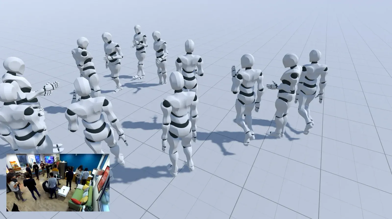

Run the Scene
After a short initialization period, the app will pause for 10-20 seconds as the body tracking module loads.
Once it does, step into the ZED’s view. You should see an Avatar imitating your movements in real-time.
