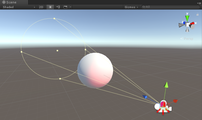

  • Right-click the ZED_Rig prefab object in the Hierarchy panel, and select Light > Spotlight. You should see the spotlight pointing in the same direction as the camera in the Scene window. (If not, adjust the position and rotation so that it is).
  • With the spotlight selected, click on the white box beside Color in the Inspector window. Select a bright and distinct color, like red.
  • Make sure the sphere you added in the last tutorial still has its position set to X = 0, Y = 0 and Z = 2. If you click on the Spotlight again, its “cone” of light should be touching the sphere.

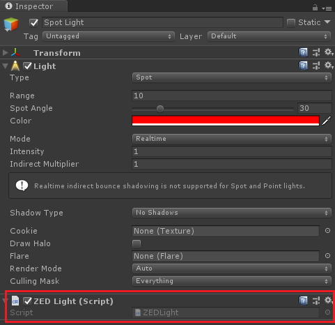

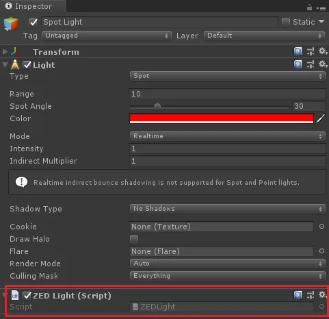

To enable illumination of the real world with virtual lights, attach a script called ZEDLight.cs located in SDK/Helpers/Scripts/Lighting to each light you want to use. A light without a script will only illuminate virtual objects.

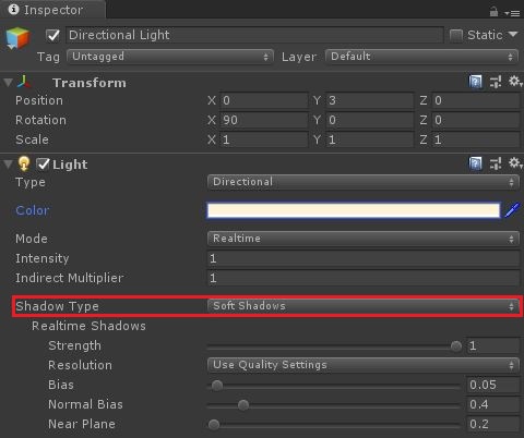

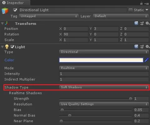

  • Set Shadow Type to Soft Shadows and adjust the Strength value. A value of 0.2 or lower usually works well for most scenes.

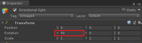

  • Adjust the directional light angle to 90 degrees in the Transform panel. This will project shadows directly under the virtual objects.
