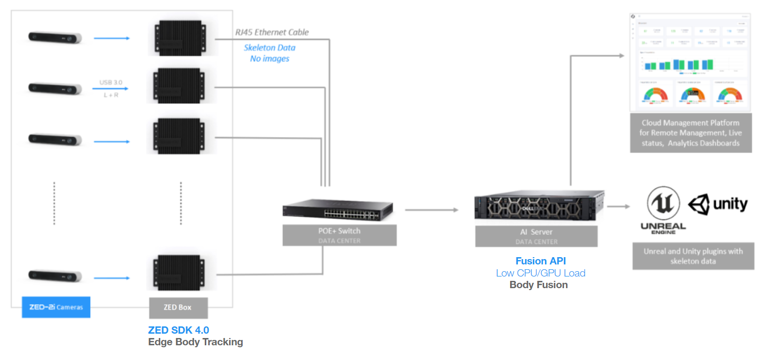

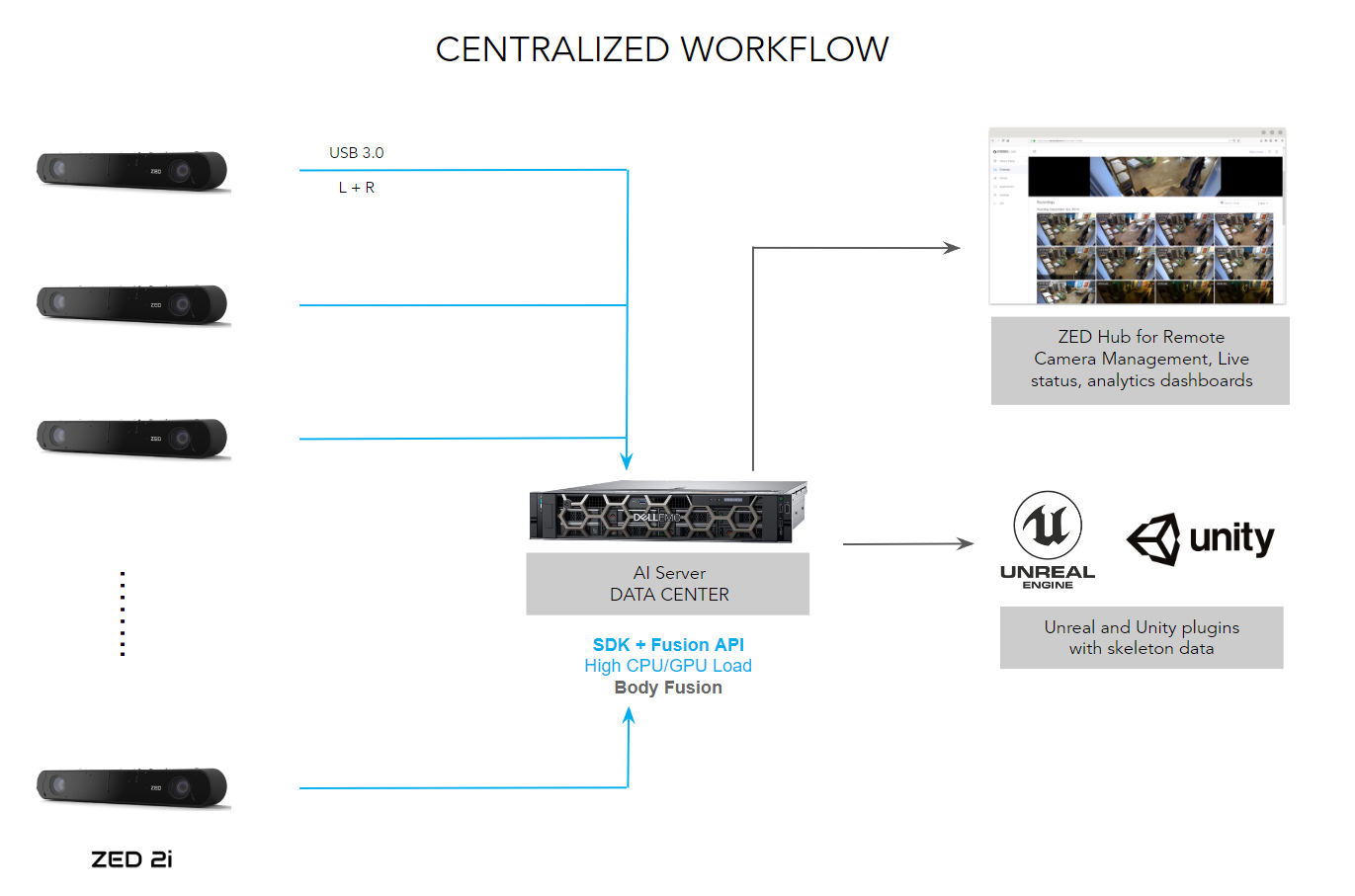

To support most setups, the Fusion API can operate with two different workflows:
LOCALNETWORK
PresentationFully local application, where all ZED cameras are connected to the same host computer which runs the publishers and the subscriber.Network (edge computing) oriented application based on ZED Boxes, where each publisher and the subscriber run on different host machines.

Pros- Low latency
- Efficient shared memory protocol (even for GPU memories)
- Can achieve high FPS with high-end hardware
- Simple setup for development
- High availability (no single point of failure)
- No limitations on the number of publishers
- Large variety of ZED boxes available to fit your computation requirements
- Adapted for large scale scenarios
- Remote monitoring of your system with ZED Hub
Cons- Requires a powerful GPU (large GPU memory) to support the execution of multiple camera instances
- Requires high USB bandwidth to connect all of your cameras
- Can be limited by camera cable length
- Network data transfer introduces a small latency (< 5ms), depending on the network configuration

For a local workflow where all the cameras are connected to the host machine, the code samples provided above are sufficient. However, an extra step is required when the cameras are connected on different machines on the local network.
Setting up a network workflow
Each camera must run a streaming app that will compute all the required data and send it to the fusion server over the local network. This task can be performed with the following code:
