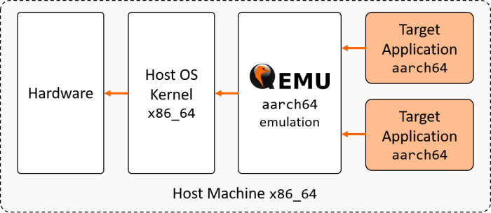

We will use QEMU and Docker to set up our emulated environment. QEMU is an open-source machine emulator and virtualizer. It lets you build ARM CUDA binaries on an x86 machine without a cross-compiler.
First, let’s see what happens (before setting up the emulation) when we try to run a program compiled for a different architecture:
As expected, the instructions are not recognized, because the emulation support is not installed yet. Installing the following packages enables support for aarch64 containers on your x86 workstation:
The installation was successful and the emulation is working. At this point, you can run aarch64 programs on the x86_64 host. However, it is not yet possible to build and run CUDA-accelerated applications under QEMU. To add this capability, you need to use a Linux for Tegra (L4T) base image from the NVIDIA® registry (see the next section for details).
For advanced details on using QEMU with Docker, refer to the multiarch/qemu-user-static repository on GitHub.

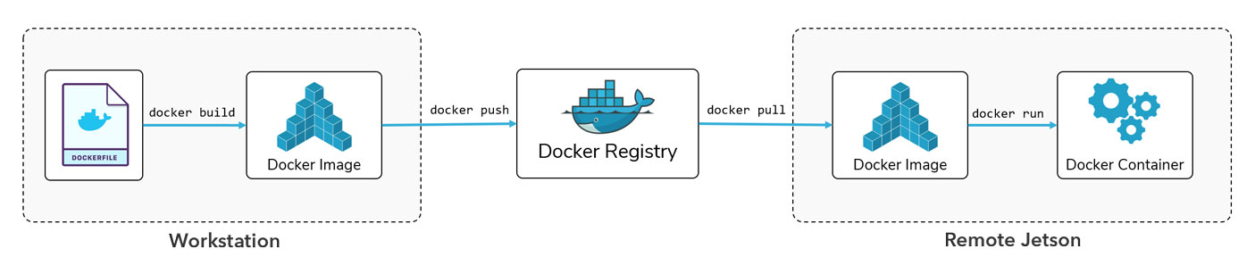

We recommend the workflow above for building and deploying your applications with Docker on NVIDIA® Jetson™. Your source code and Dockerfiles live on your local device (the host machine). The image is built from the Dockerfile on the host and pushed to a Docker registry that makes it accessible from a remote device (the target machine). On the target machine, the image is pulled from the registry and run in a container.
Build a Docker Image on the Host
To build a Docker image on the host machine, you need to:
- Write a Dockerfile for your application (see the Creating a Docker Image for your ZED Application section).
- Run the
docker buildcommand.
Run a Docker Image on the Target
Pull your image from the registry on the target machine, then run it in a container:
If the image has not been pulled previously, docker run will pull it from the registry automatically.
