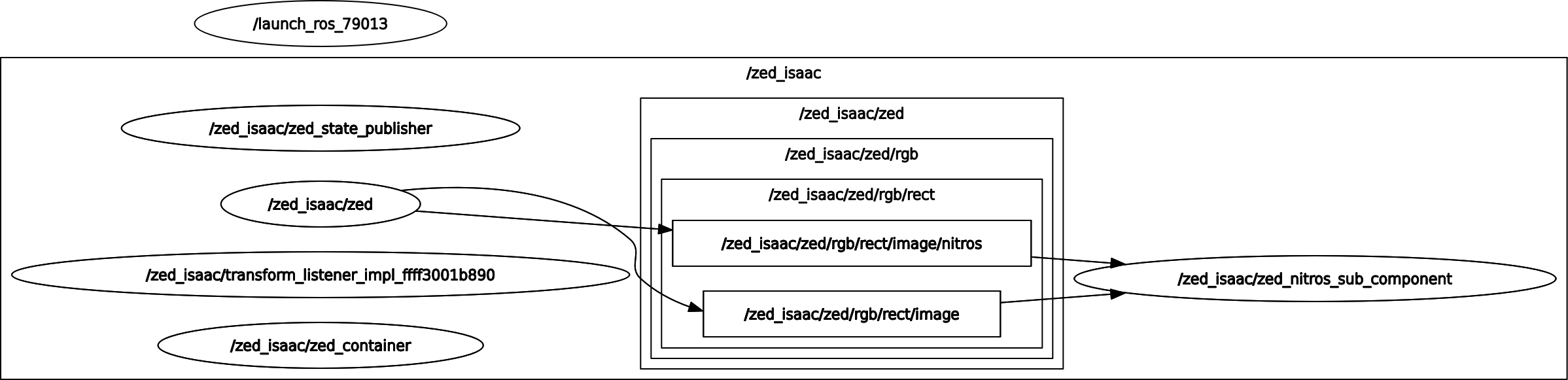

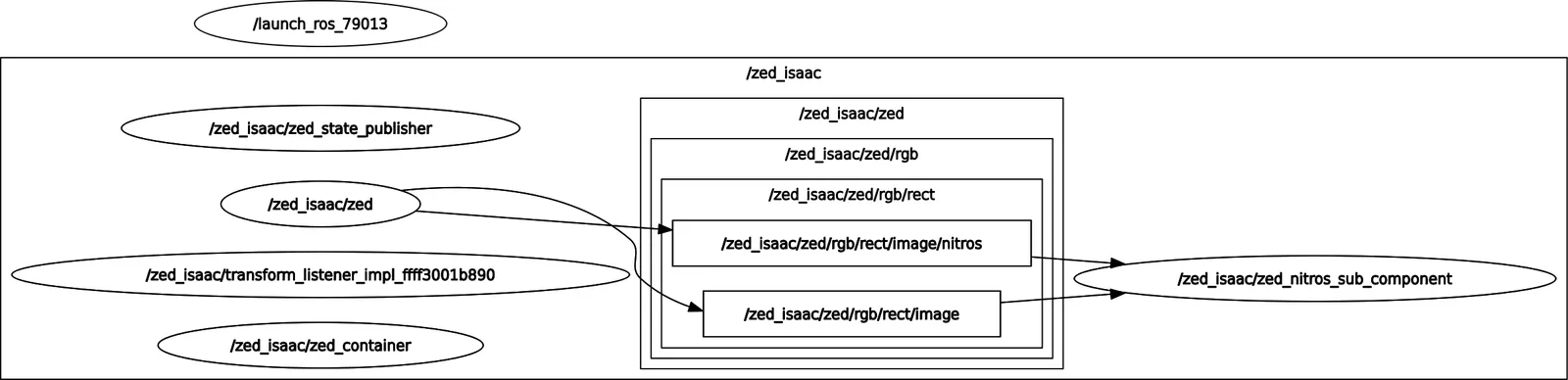

To launch the example, you must first select the topic to subscribe to. The launch file requires you to specify the topic name using the argument topic_name. For example, to subscribe to the image topic, use topic_name:=/zed_isaac/zed/rgb/color/rect/image, or to subscribe to the depth topic, use topic_name:=/zed_isaac/zed/depth/depth_registered.
ros2 launch zed_isaac_ros_nitros_sub zed_nitros_sub_example.launch.py \
camera_model:=<camera_model> \
topic_name:=<topic_name>
For example, to subscribe to the RGB image topic of a ZED X One GS camera:
camera_model:=zedxonegs \
If you list all the topics published by the ZED ROS 2 Wrapper node using the command ros2 topic list, you will see that all the image and depth topics have also a suffix /nitros. You do not need to specify that suffix when subscribing to the topics using NITROS, as the Managed NITROS subscriber automatically subscribes to the NITROS topic when possible. You can confirm this by looking at the ROS 2 Node Graph using the command ros2 run rqt_graph rqt_graph.

[component_container_mt-1] [INFO] [1759761477.867231955] [zed_isaac.zed]: === CLOSING CAMERA ===
If you specified a CSV log file in the parameters, the benchmarking results will be saved to the specified file. If you set it as a filename, without the path, the file will be saved in the ISAAC_ROS_WS directory.
This is an example of the contents of the CSV log file:
BENCHMARK, SAMPLES, UNITS, AVG, MIN, MAX, STDDEV
DDS Subscriber Frequency, 999, Hz, 60.1756, 44.1746, 142.25, 5.62242
DDS Subscriber Latency, 1000, sec, 0.00477946, 0.00396776, 0.00954056, 0.000627538
DDS Subscriber CPU Load, 1000, %, 27.4333, 17.6061, 41.6184, 3.70468
DDS Subscriber GPU Load, 1000, %, 38.6972, 21.52, 54.62, 5.60272
Nitros Subscriber Frequency, 999, Hz, 59.7909, 50.9502, 72.5703, 2.42548
Nitros Subscriber Latency, 1000, sec, 0.000404906, 0.000216722, 0.00192523, 0.000112669
Nitros Subscriber CPU Load, 1000, %, 24.5845, 13.5851, 38.9298, 3.66314
Nitros Subscriber GPU Load, 1000, %, 37.1849, 20.24, 52.66, 5.90766
* DDS Subscriber Latency vs Nitros Subscriber Latency
* Avg: 0.00477946 sec vs 0.000404906 sec
- DDS Subscriber Latency is higher by 0.00437456 sec (1080.39%)
* DDS Subscriber Frequency vs Nitros Subscriber Frequency
* Avg: 60.1756 Hz vs 59.7909 Hz
- DDS Subscriber Frequency is higher by 0.384653 Hz (0.64333%)
* DDS Subscriber CPU Load vs Nitros Subscriber CPU Load
* Avg: 27.4333 % vs 24.5845 %
- DDS Subscriber CPU Load is higher by 2.84885 % (11.588%)
* DDS Subscriber GPU Load vs Nitros Subscriber GPU Load
* Avg: 38.6972 % vs 37.1849 %
- DDS Subscriber GPU Load is higher by 1.5123 % (4.06697%)
The output shows the benchmarking results for both the DDS subscriber and the NITROS subscriber, including the average, minimum, maximum, and standard deviation for each metric. It also includes a comparison of the two subscribers for each metric.
For example, in the output above, we can see that the average latency of the DDS subscriber is 0.00477946 sec, while the average latency of the NITROS subscriber is 0.000404906 sec. This means that the NITROS subscriber has a significantly lower latency than the DDS subscriber: about 92% lower in this case (the DDS latency is 1080.39% higher, as reported in the comparison).
The frame rate of the DDS subscriber is slightly higher than that of the NITROS subscriber, but the difference is minimal (0.64333% higher for DDS). The standard deviation is higher for the DDS subscriber, indicating that the frame rate is more stable with the NITROS subscriber.
