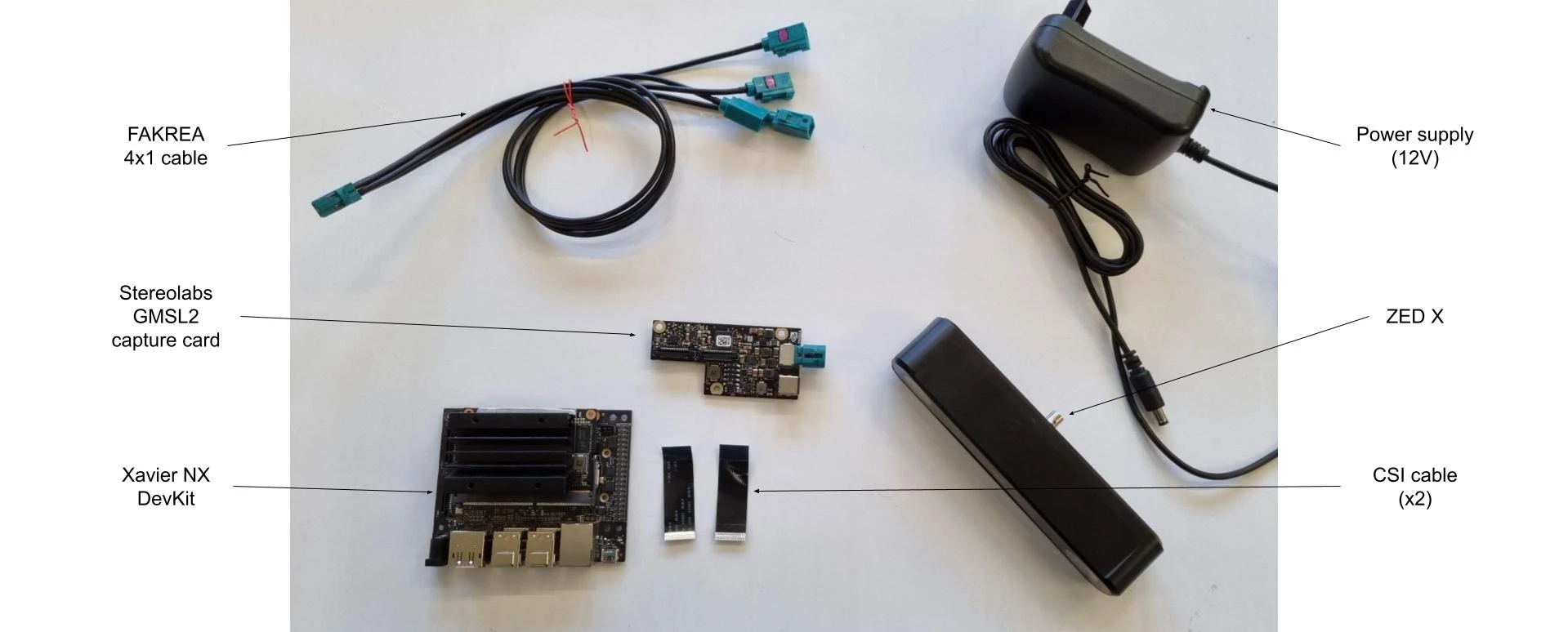

  • 1x NVIDIA® Jetson™ Xavier NX Developer Kit.
  • 1x ZED Link Duo GMSL2 capture card
  • 1x 1-to-4 GMSL2 Fakra Male to Female cable (included in the box)
  • 2x FPC Camera Cable 15-pin 1.0mm (not included)*
  • 9V-19V (min 2W) power input (Barrel Jack 5.5 mm outer diameter, 2.5 mm inner diameter) to power the GMSL2 capture card (not included)

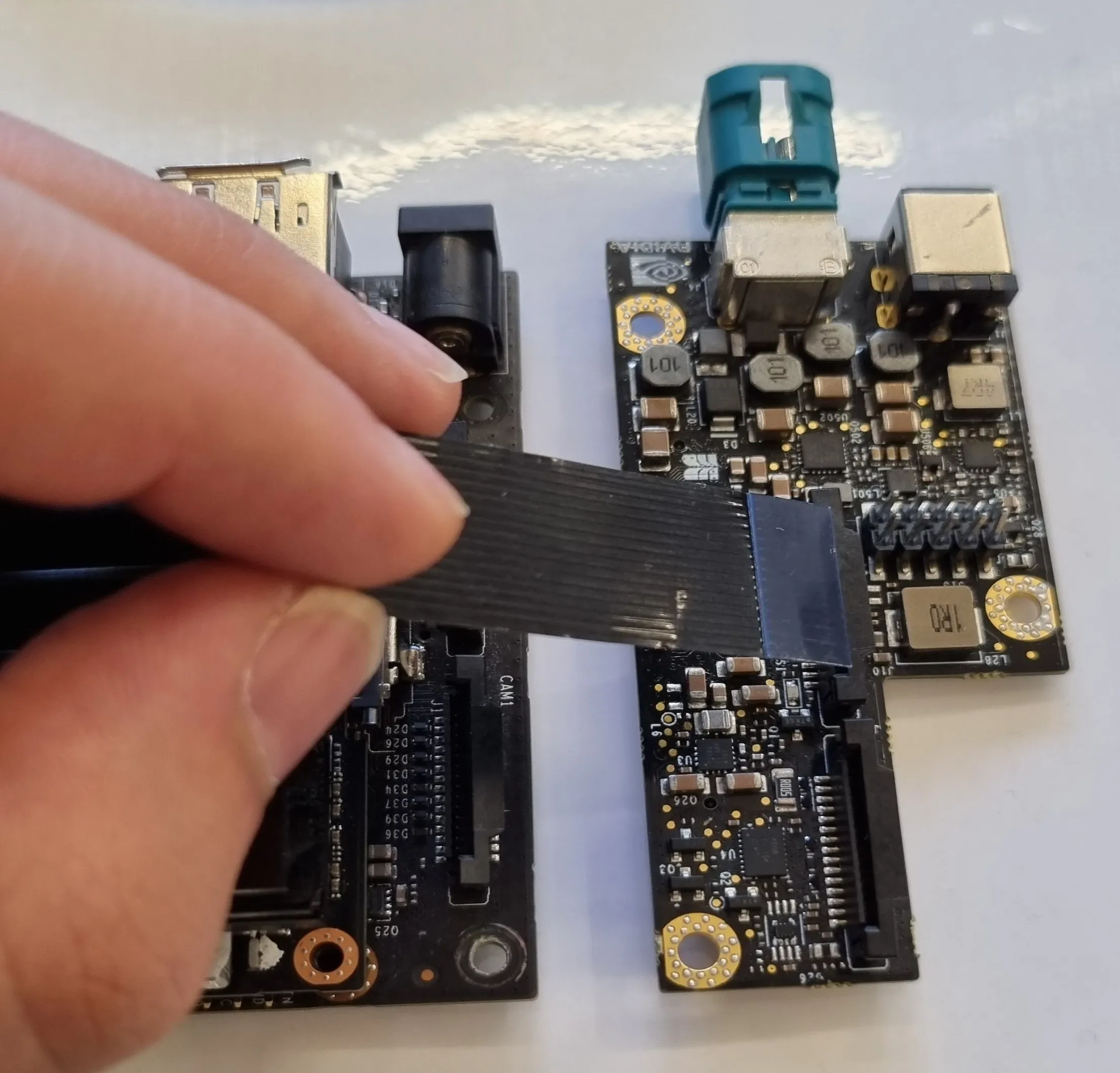

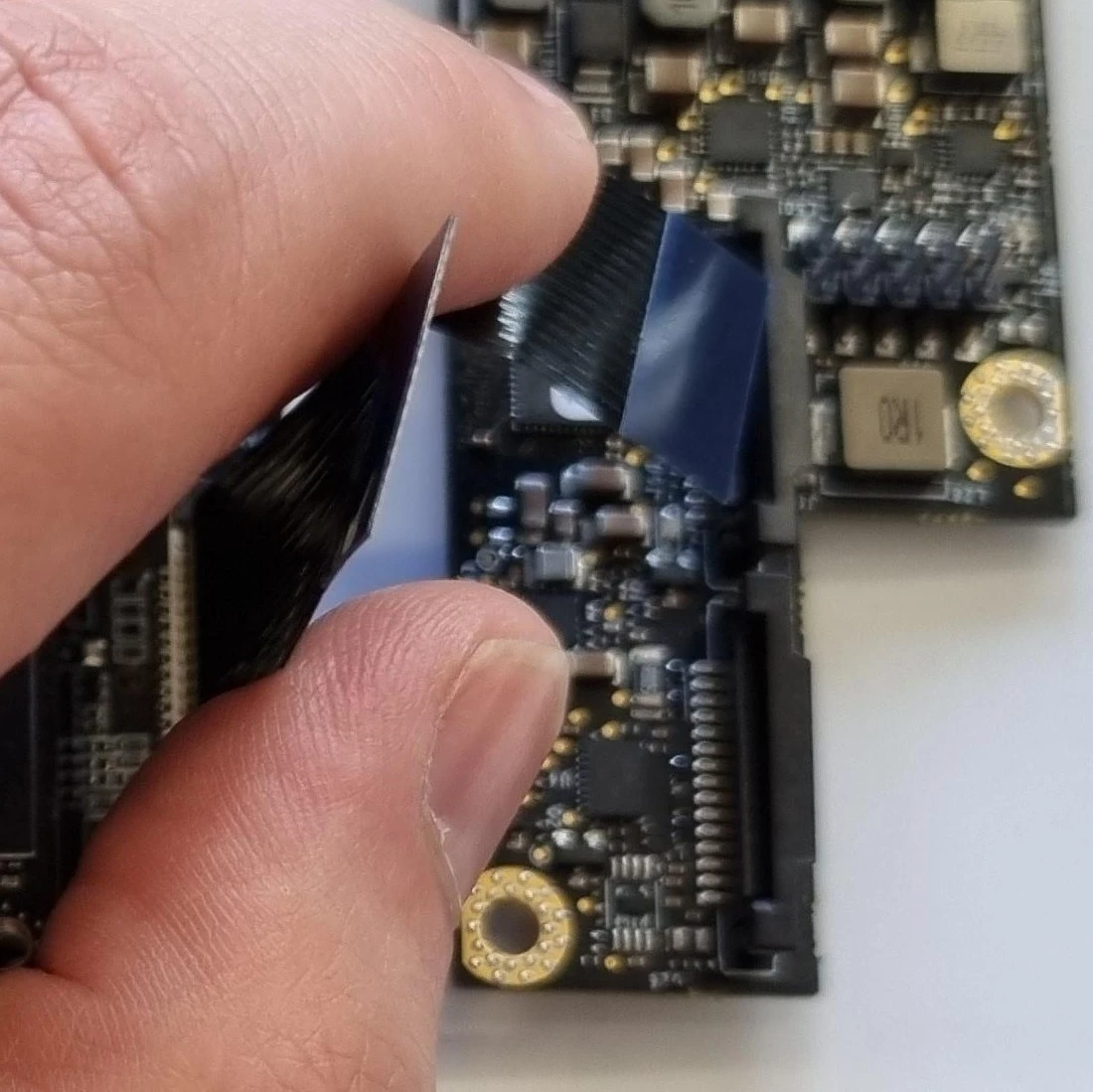

The 15-pin CSI cable must not be mistaken for a DSI cable, where the active pin connection is on the same side. On CSI, the 15 pins are on the opposite side when looking at the flat cable. The cable can be purchased at UCTRONICS.

Connect the CSI cable at each MIPI 15-pin port of the carrier board. Make sure the correct side is plugged in for each port.
Xavier NX capture card cabling
Both MIPI cables must be connected to have access to 2x ZED GMSL2 cameras on the capture card.

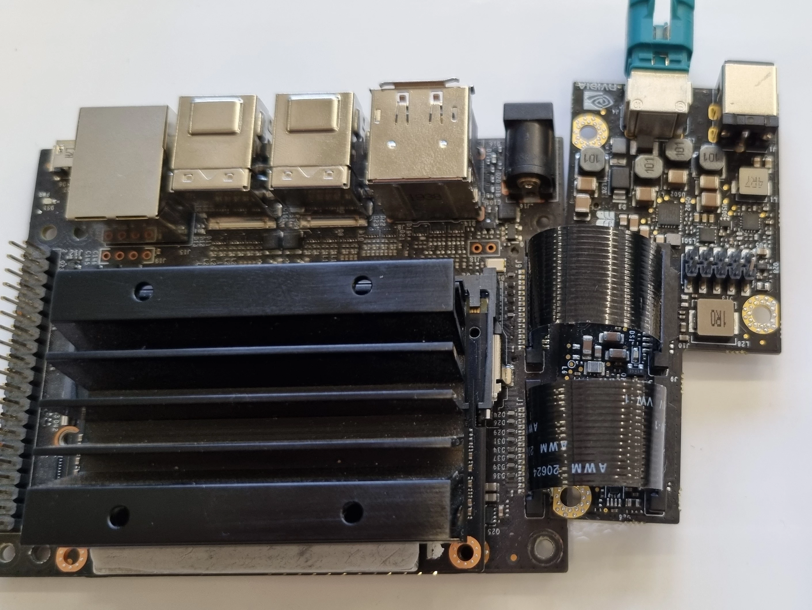

Cabling the Carrier Board
Make sure that J9/CAM0 is connected to the centered MIPI port of the GMSL2 capture card.
J1/CAM1 must be connected to the MIPI port close to the edge.
Xavier NX capture card cabling orientation
Once connected, the setup should look like the following picture:
Xavier NX cabled

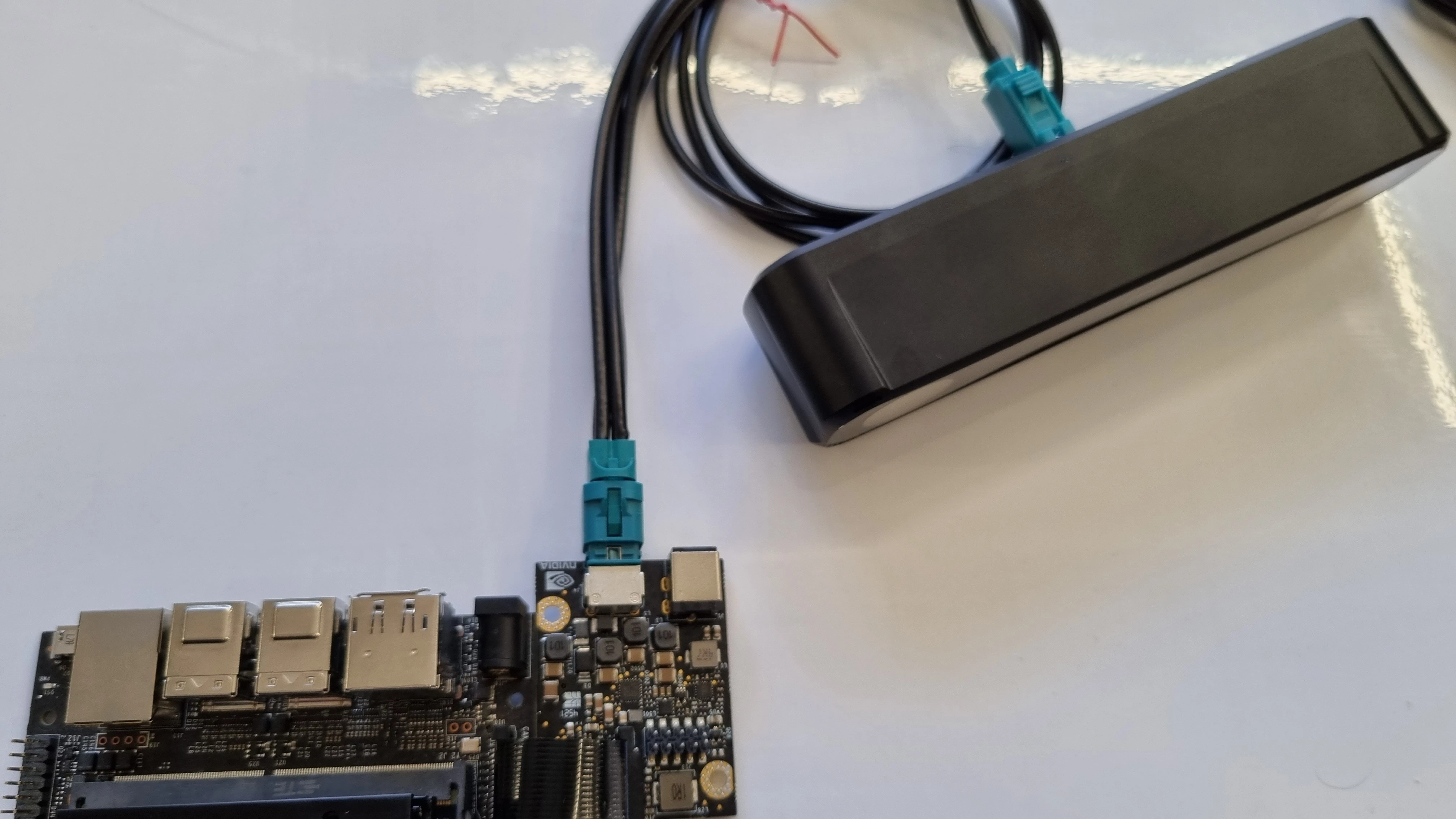

Connect the camera
Connect the GMSL2 Fakra cable female end to your ZED X. When you hear a click, the cable is securely connected to the camera.
ZED X with Fakra cable
Xavier NX plug camera

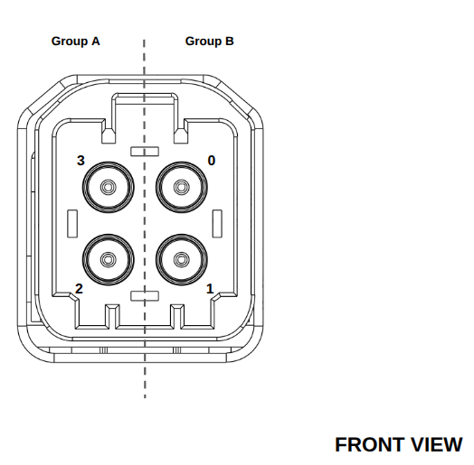

Multi-camera configurations
ZED Link Duo connections
per Group
Max Resolution/FPS
per Group
MonocularZED X One GS
ZED X One S
Up to 2 camerasHD1200@60fps
HD1080@60fps
SVGA@120fps
MonocularZED X One 4k1 camera
only to port #0, #2
4k@15fps
HD1080@60fps
SVGA@60fps
StereoZED X
ZED X Mini
ZED X Nano
1 CameraHD1200@60fps
HD1080@60fps
SVGA@120fps
StereoZED X
ZED X Mini
ZED X Nano
Up to 2 CamerasHD1200@30fps
HD1080@30fps
SVGA@60fps
