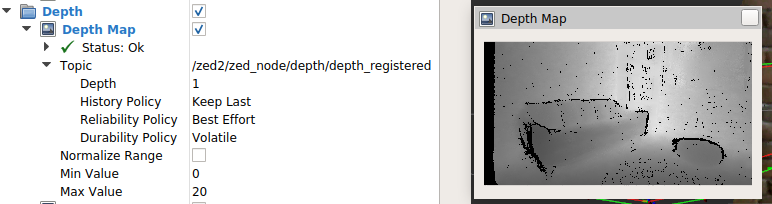

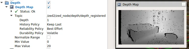

To visualize a depth image, you can use the simple Image plugin since the depth data are published on topics of type sensor_msgs/Image. It differs from a “normal” image in that the data is encoded in 32-bit (floating point) rather than 8-bit.
The parameters are the same as for Image (see the Video tutorial) with three additions:
  • Normalize range: Since a floating point image is not directly rendered, it is converted to an 8-bit grayscale image. Enabling this field means the normalization range is automatically calculated
  • Min value: If Normalize range is unchecked, you can manually set the minimum depth range in meters
  • Max value: If Normalize range is unchecked, you can manually set the maximum depth range in meters
Manually setting the normalization range is useful if you know the maximum value measured for the depth and you want to keep the image scale static.

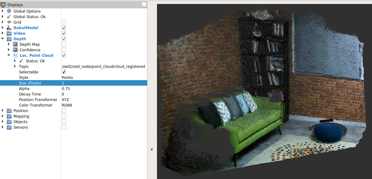

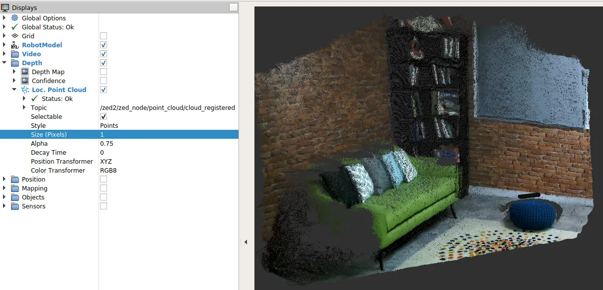

To directly visualize a topic of type sensor_msgs/PointCloud2 you can use the PointCloud2 plugin.
Key parameters:
  • Topic: Selects the topic to visualize from the list of available point cloud messages
  • Depth: The depth of the incoming message queue
  • History policy: Set the QoS history policy. Keep Last is suggested for performance and compatibility
  • Reliability Policy: Set the QoS reliability policy. Best Effort is suggested for performance, Reliable is used for compatibility
  • Durability Policy: Set the QoS durability policy. Volatile is suggested for compatibility
  • Style: The style used to render each point. Use Points and Size=1 to maximize FPS
  • Color transformer: Selects how points are colored. Use RGB8 to match the color image pixels to the corresponding depth pixels. Use Axis color to use a color proportional to the value of the Axis value (e.g. Z to use a color scale proportional to the distance from the floor or X to use a color proportional to the distance from the camera)
If mapping is enabled (see the mapping.mapping_enabled parameter), the PointCloud2 plugin is also used to visualize the fused point cloud produced by the mapping module, by subscribing to the topic /zed/zed_node/mapping/fused_cloud.

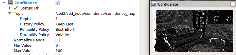

To visualize the Confidence Map as an image, you can use the Image plugin subscribing to the topic ~/confidence/confidence_map.
The confidence map contains the raw ZED SDK confidence values, from 0 (high confidence) to 100 (low confidence). In a grayscale view, the lighter a pixel, the less reliable its corresponding depth value is.
