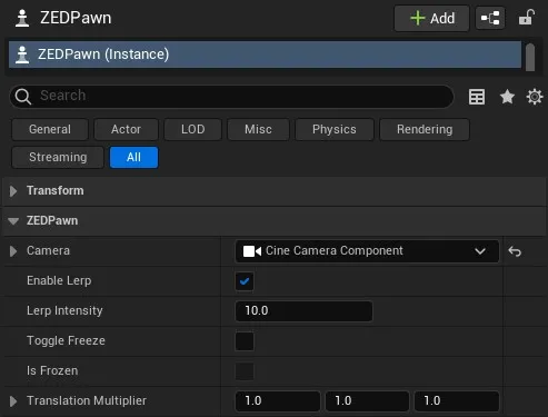

ZEDPawn
The ZEDPawn holds the ZEDCamera actor and has a Cine Camera component.
  • Camera: Edit the Cine Camera component settings: all the intrinsic camera parameters such as the focal length or the aperture, and all the post processing options and other parameters.
  • Enable Lerp: Enable or disable smoothing of the camera movements, to manage jittering vs latency.
  • Lerp Intensity: Intensity of the smoothing. The alpha of the linear interpolation that smooths movements is the duration since the previous frame multiplied by this value, and clamped between 0 and 1.
  • Toggle Freeze: Tick this to freeze the virtual camera in place, allowing you to reposition the real one.
  • Translation Multiplier: The factors that will be applied on the real camera’s translations to calculate the virtual camera’s ones, on each axis.

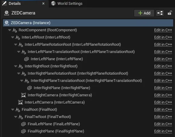

ZEDCamera
The ZEDCamera actor is attached to the ZEDPawn at the start of the scene. It manages mainly three things.

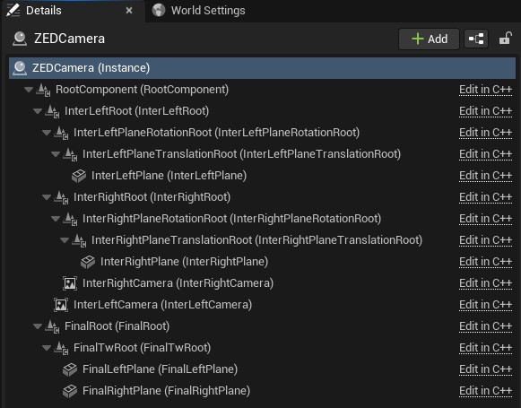

  • Firstly, the rendering cameras and planes where the plugin applies the textures created via the SDK data.

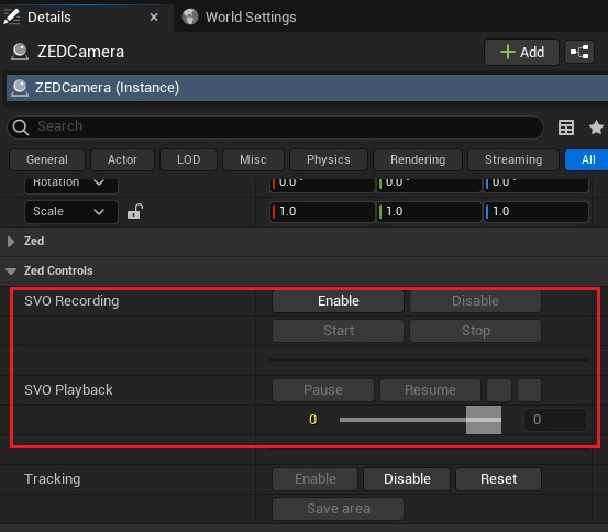

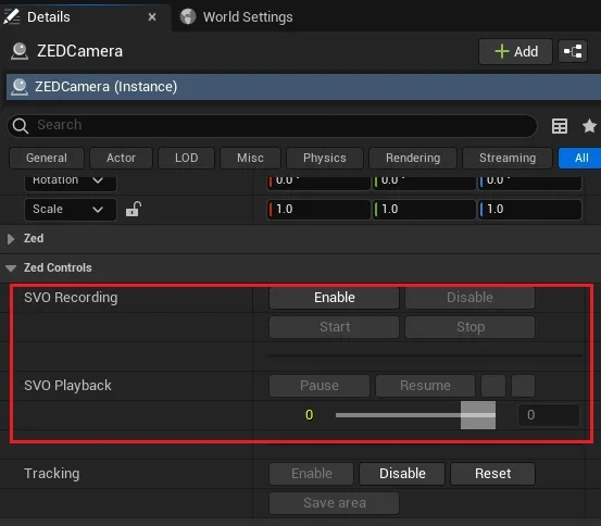

  • Secondly, the potential recording or playback of an SVO file.

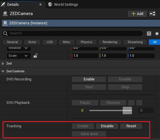

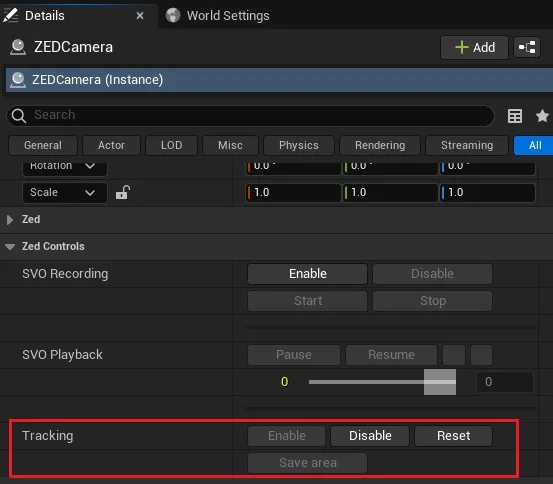

  • Thirdly, the activation and deactivation of the tracking of the camera at runtime.

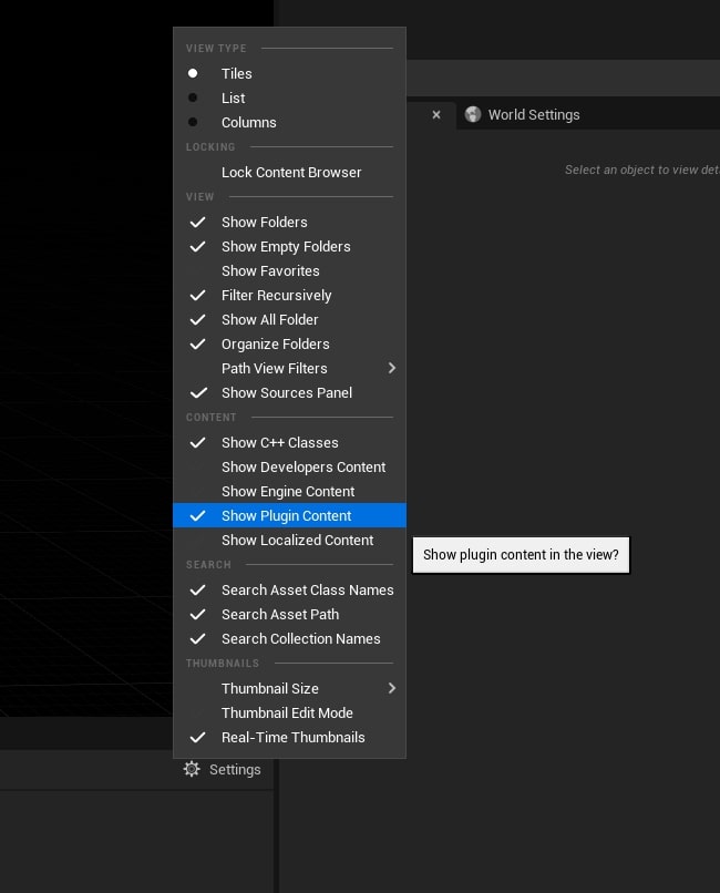

We’ve got to add a Blueprint from the ZED plugin. But by default, Content from plugins is hidden. To fix this, click on View Options at the bottom right of the Content Browser and enable Show Plugin Content.

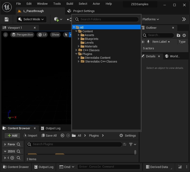

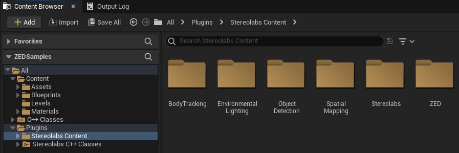

Now click on the folder icon beside Content and click on Stereolabs Content to switch to the plugin’s content folder.
image image
In the Content Browser, go to Plugins -> Stereolabs Content -> ZED -> Blueprints and drag a BP_ZEDCamera into the scene. This is the object that sets up your camera and handles communication with your app.

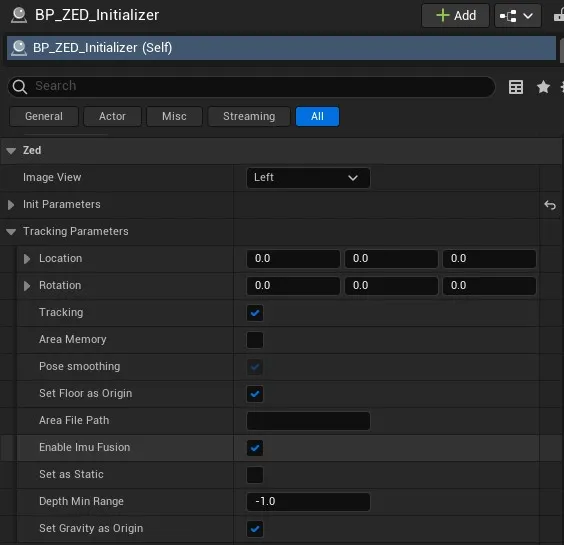

  • Select the BP_ZEDCamera blueprint, and in the ZED section, uncheck the Show Zed Image parameter. This parameter has to be disabled so we can see the 3D scene and not the ZED’s image in fullscreen.
  • Check that the Tracking is enabled in the Tracking Parameters of the BP_ZEDCamera, along with Enable IMU Fusion.
  • Check that Set as Static is disabled, since your camera will move.
  • You can enable Set Floor as Origin to spawn the camera above the world’s origin, at a height matching the height of the real camera. If not, it will spawn at the world’s origin.

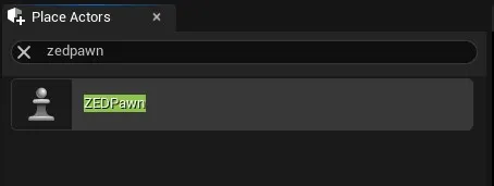

To have better control over where the ZEDCamera will start in the scene, you can also drag a ZEDPawn in it. It can be found either:
  • in the Plugins -> Stereolabs C++ Classes -> ZED -> Public -> Core -> ZEDPawn
  • or in the Place Actors panel.

Movement smoothing
Enable or disable Lerp, and adjust its intensity according to your needs.
Init parameter of camera “FPS” is set to 15 to simulate low framerate. Without linear interpolation, a lot of jittering occurs since the camera sensors are very accurate and each movement is noticeable.
Camera repositioning
Click Toggle Freeze, then reposition your real camera, and click it again to unfreeze and go on moving from another position. The translations and rotations are made in the local space of the camera: moving the camera forward in the real world will move it forward in the virtual scene.
Translation multiplier
The translations of the real camera are multiplied by the Translation Multiplier vector’s values. It can be used to completely lock an axis, or to intensify the translations.
