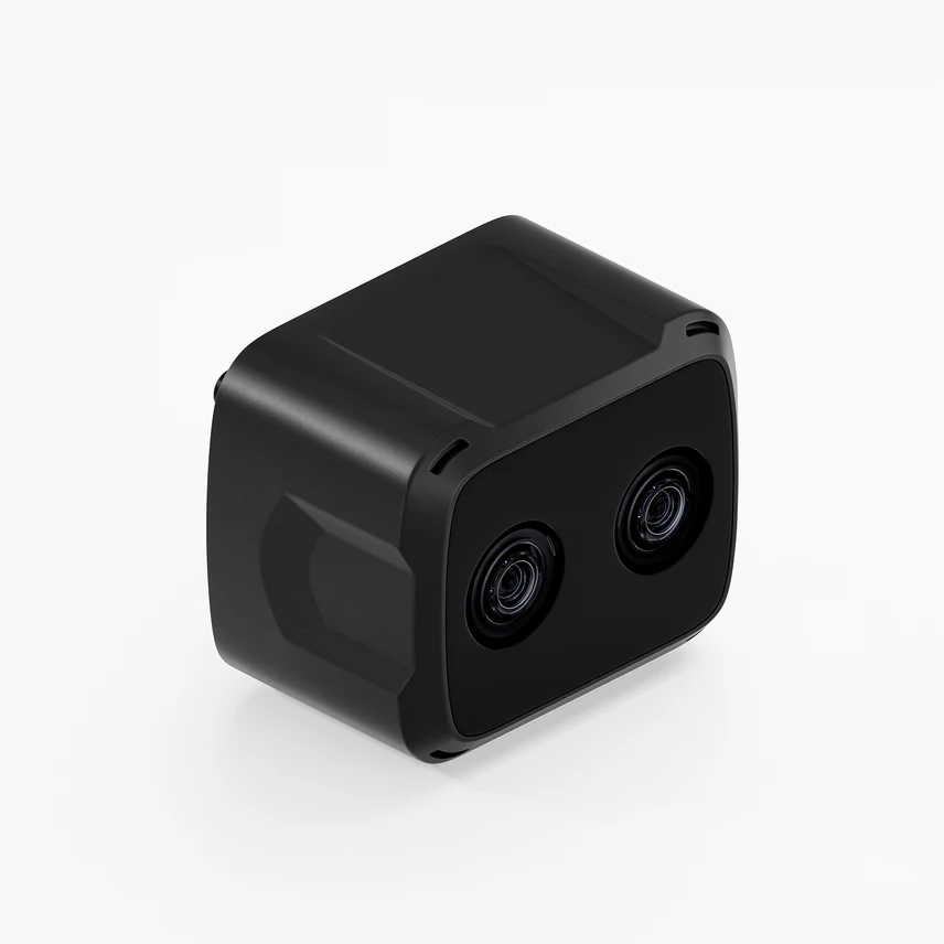

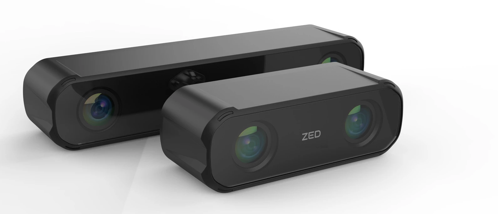

About ZED X, ZED X Mini, and ZED X Nano
The ZED X camera is a professional-grade camera designed specifically for robotic applications in production environments. With its IP67-rated enclosure, global shutter sensors and high-performance IMU, it is built to withstand harsh conditions and provide reliable performance.
Only ZED X and ZED X Mini are IP67 rated. ZED X Nano has no IP rating; it is designed for indoor use.
The camera’s advanced Neural Depth Engine 2 technology produces highly accurate depth maps, even in challenging lighting and untextured environments. Additionally, its secure GMSL2 connection allows for low-latency video transmission without EMI interference, making it ideal for integration into robotics platforms.
ZED X and ZED X MiniZED X Nano
