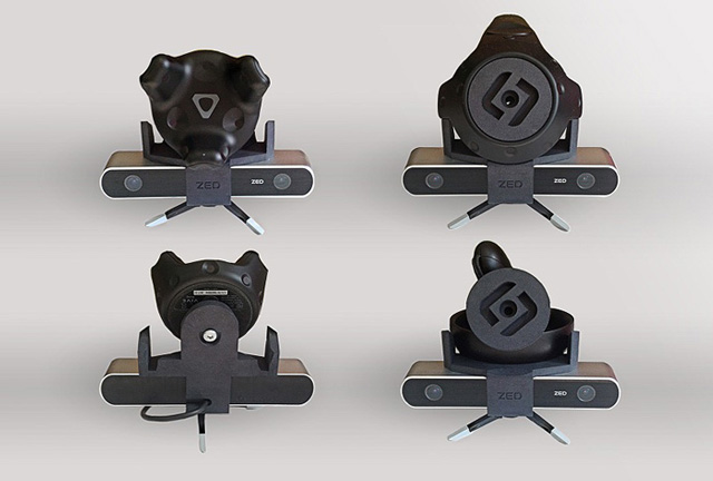

First, you will need to mount a controller/tracker onto the ZED and make sure they are firmly attached. The controller will let you track the ZED in the same space as the HMD and allow you to move the camera while filming. To attach the ZED and controller/tracker from Oculus or Vive, you can 3D print the following mount (download STL, OBJ).
If you don’t have access to a 3D printer, you can attach the devices with clamps, tape, etc. But you must ensure two things: First, that your attachment mechanism doesn’t occlude too many of the controller/tracker’s sensors. Second, your attachment must be firm (no wobbling) or else you will have to recalibrate constantly.

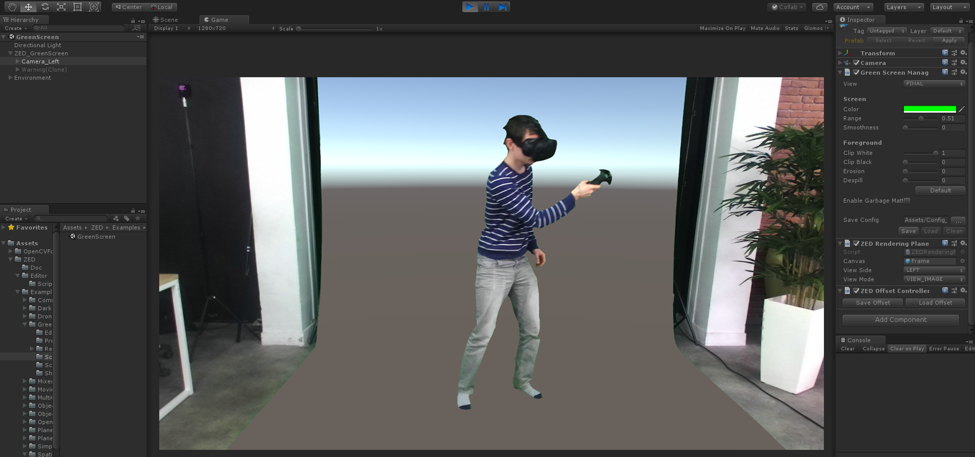

  • In the Project panel, navigate to Assets > Samples > ZED SDK > version > Green Screen > Prefabs. Drag and drop the ZED_GreenScreen.prefab in the Hierarchy view.
  • In the Hierarchy view, select ZED_GreenScreen > Camera_Left.
  • Click on the Play button. Your Unity interface should look like this:

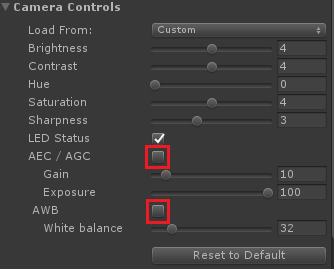

  • After selecting ZED_GreenScreen > Camera_Left, click on the Camera Control button of the Green Screen Manager in the Inspector view.
  • By default, the camera exposure and white balance are adjusted automatically. Auto White Balance tends to add a green tint to the picture when placing the ZED in front of a green screen. Since you’re shooting in a controlled environment with fixed lighting, you can disable the Automatic settings and manually adjust the parameters of the Camera Control panel.
  • Hit Save once you’re happy with your settings, so they can be easily loaded later after restarting Unity.

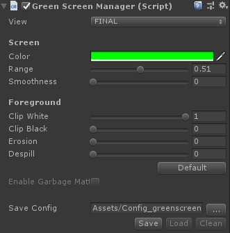

In the Inspector panel, you can adjust your chroma key settings with the Green Screen Manager script. Below are explanations of what each setting does and when to adjust it.
Views

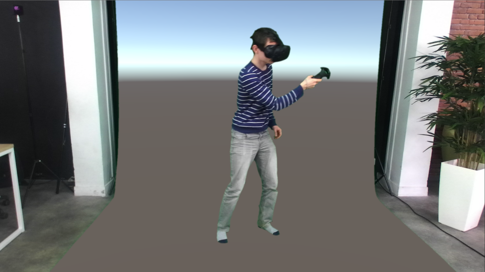

Select the FOREGROUND view to get a better feel for what remains visible in your scene and what doesn’t. This can be useful for setting the critical settings in the next section. Change the view to FINAL to see the result.
Color Range
The Color, Range and Smoothness values are the most important and where you’ll likely spend the most time adjusting. When the script goes through each frame, it will check each pixel’s color to see if it should turn it invisible.
  • If you’re using a background that’s not green, adjust the Color setting to match. Otherwise, adjust the shade of green to better fit the screen’s exact color and your lighting setup.
  • Range indicates how close a color on the spectrum can be to the exact color of your background. You need to add some range because even the highest quality green screen studio has shading to it.
  • Smoothness defines how colors just outside the range get blended in. With zero smoothness, a color just outside the range is completely visible. With more smoothness, it will be partially visible. You’ll get further control over how smoothness affects the image in the next section.
The easiest way to find a good Range and Smoothness is to start the scene, set both values to 0, adjust the Range, then adjust the Smoothness.

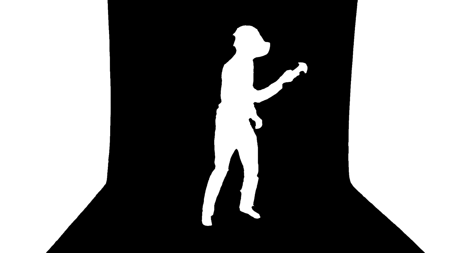

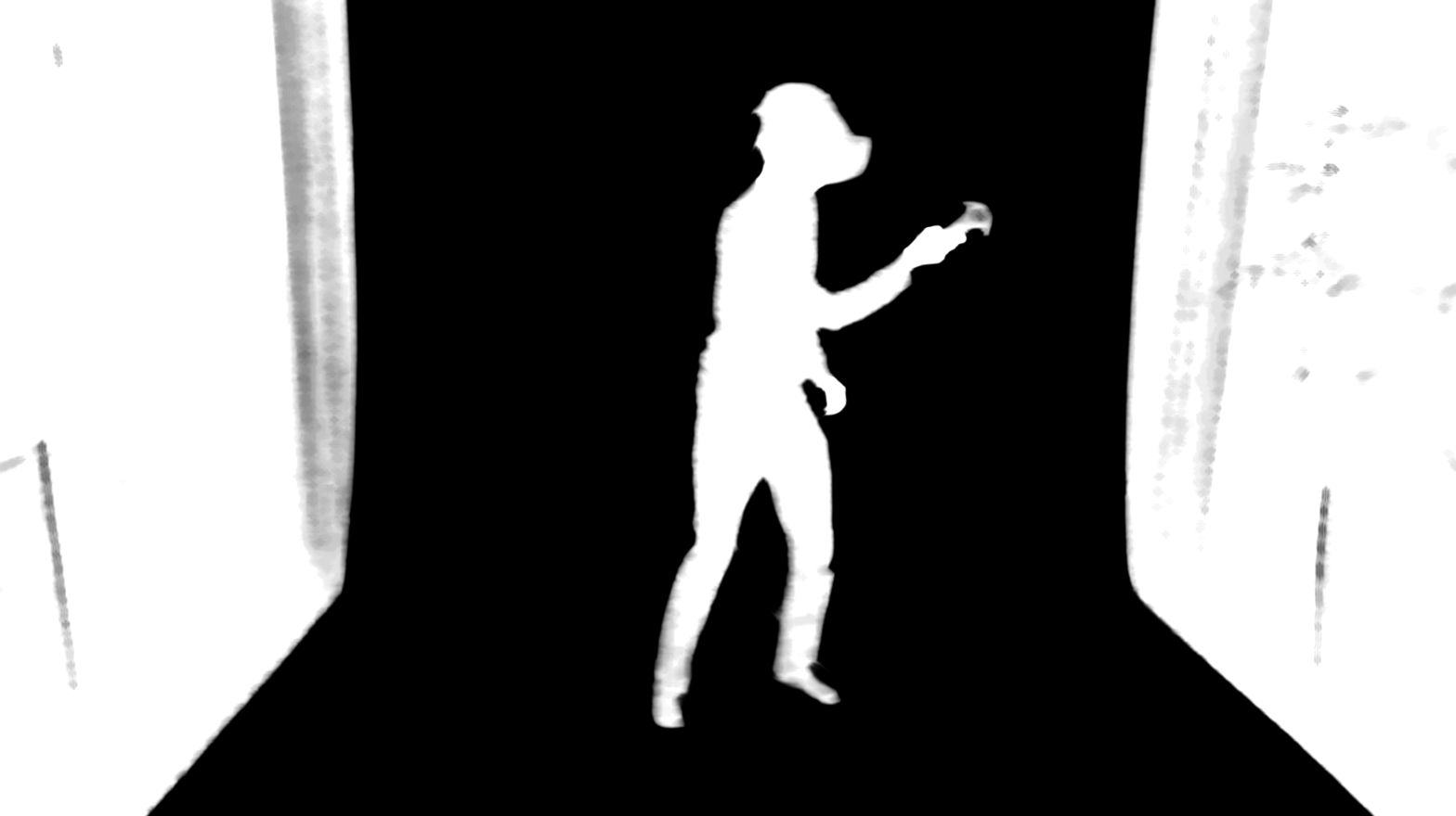

  • Next, refine the edge of the matte with the Erosion, Black Clip, White Clip, Edge Softness and Despill settings. The ALPHA view can be helpful for making these adjustments.
  • The Erosion setting erodes the edges of the matte to remove the remaining green areas.
    Without erosionWith erosion
  • White Clip and Black Clip: Alpha values above the White Clip value will be set to 1 (fully opaque), and alpha values below the Black Clip value will be set to 0 (fully transparent). In other words, White Clip makes nearly opaque pixels fully opaque, and Black Clip does the same for nearly invisible pixels. This helps you remove noise that results from your smoothness setting.

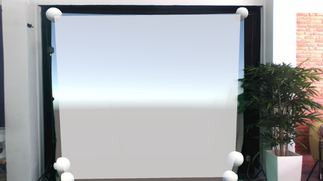

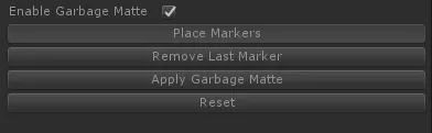

The Garbage matte script lets you extend the virtual world beyond the green screen’s limited size. It allows you to define a region in space and exclude image pixels that do not belong to this region. To use camera tracking with the garbage matte (not needed in this demo, since we use the headset tracking), you need to activate tracking before setting your garbage matte. Tracking can be activated by clicking on the ZED_GreenScreen prefab, and enabling it in the ZED Manager component.
  • Click on Enable Garbage Matte
  • Start your scene.
  • Make sure Place Markers is selected.
  • Define your green screen region by clicking on the image in your Game display window to place your markers. You should see spheres appear at each place you click.
  • Repeat the previous step until the whole green screen area is covered with a white mesh.
  • Click on Apply Garbage Matte to exclude the outside region of the mesh (set to transparent).
  • To save and load markers, use the Save/Load option.
If the area is not covered correctly, use Remove Last Marker to disable the garbage matte and remove the last marker. You can also adjust the position of a specific marker with a right click to select a sphere and a left click on a new position.

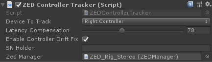

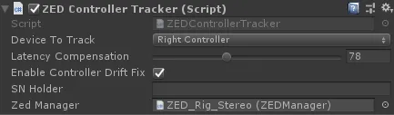

  • Select the ZED_GreenScreen object and add the ZEDControllerTracker script.
  • If the component window in the Inspector only displays a “Load data” button, press it. It should now look like this:
  • Change the Device to Track option to match the object to which you’ve attached your ZED.
  • Drag and drop the ZED_GreenScreen root object into the ZED Manager field. This will help the plugin determine not to use latency compensation designed for controllers on the ZED, which can cause unwanted movements when tracking the ZED itself.
  • Lastly, select the ZED_GreenScreen object, and add a ZEDOffsetController component. This will move the virtual ZED to match the tracked object found in the calibration file we’re about to create.
