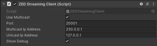

  • Check that the Port and Multicast IP Address variables of the ZED Streaming Client script on the Fusion Manager prefab are set to the same values as in the main.cpp set previously.

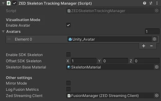

These are located on the ZED Body Tracking Manager script in the Fusion Manager prefab.
  • Enable Avatar: controls the visibility of the 3D avatar.
  • Avatars: Array of 3D avatars randomly chosen when detecting a new person.
    • All Unity Humanoid avatars should be compatible, provided they are made into a prefab with a ZEDSkeletonAnimator component attached.
  • Display SDK Skeleton: controls the visibility of the stickman view of the SDK keypoints. Whereas the 3D avatar is animated using local rotations derived from the keypoints, this shows the actual positions of the keypoints detected by the SDK.
For a complete description of the settings, please refer to the ZED Plugin for Unity’s Body Tracking section.
