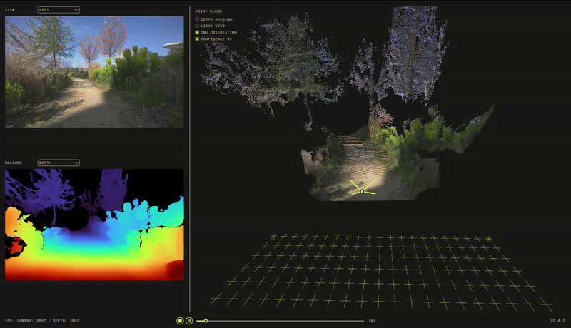

NEURAL
The NEURAL depth mode uses AI-powered disparity estimation to deliver a strong balance of depth accuracy and processing speed. It is ideal for applications that require reliable depth perception without sacrificing real-time performance.
Like every NEURAL depth mode, NEURAL supports INT8 inference precision, which trades a small amount of accuracy for faster, lower-memory depth computation. See Depth Precision.

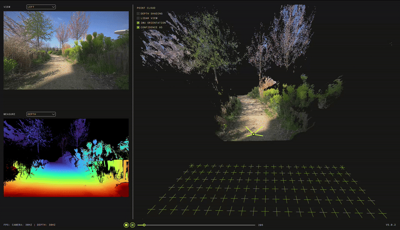

NEURAL LIGHT
The NEURAL_LIGHT depth mode provides AI-powered disparity estimation optimized for speed and efficiency. It enables real-time depth sensing with lower computational load, making it ideal for multi-camera setups and applications where fast processing is prioritized over maximum depth accuracy.

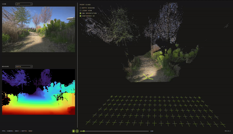

NEURAL PLUS
The NEURAL_PLUS depth mode provides high depth accuracy and detail at a cost that embedded devices can still run; only NEURAL_MAX is more accurate. It is designed for applications that demand high precision and robustness, such as advanced robotics, inspection, and 3D reconstruction. While it requires more computational resources and delivers lower frame rates than NEURAL_LIGHT and NEURAL, NEURAL_PLUS excels in challenging environments and when capturing fine object details is critical.
