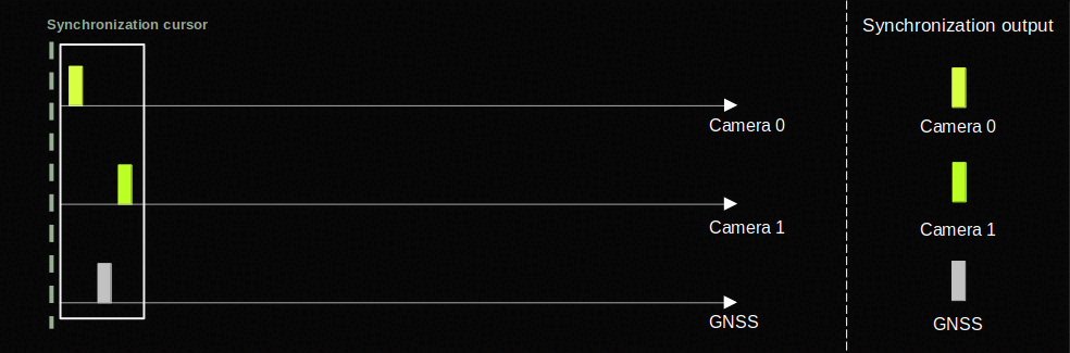

To understand how data synchronization works, let’s consider a toy example with two ZED cameras and an external GNSS. In the following example, each data is represented by a color bar aligned on its timestamp.

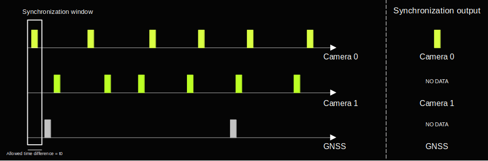

The first step of data synchronization involves matching data with closely related timestamps. In other words, data can be synchronized if it has a small timestamp difference. The allowed time difference between synchronized data can be viewed as a synchronization window. Small allowed timestamp differences lead to small synchronization windows, whereas large allowed timestamp differences lead to large synchronization windows. The following schematic illustrates how the size of synchronization windows will influence the synchronization output.
The synchronization window size is chosen once and remains fixed for the rest of the data synchronization. Data is considered synchronized when it falls in the same synchronization window. Once the data is synchronized, it is removed from the synchronization pipeline and returned to fusion. The synchronization cursor is then advanced to synchronize the next set of data.

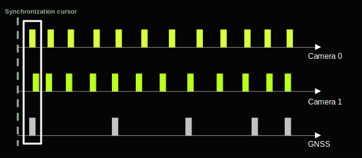

In the current version, the synchronization window size is determined by the camera’s declared FPS. For instance, if the camera is set at 30 FPS, the synchronization window size will be 33 milliseconds. Similarly, if the camera is set at 60 FPS, the synchronization window size will be 16 milliseconds, and so on. You can adjust the camera’s desired FPS using the camera_fps attribute within the InitParameters.
The diagram below illustrates the synchronization process once the window size has been correctly set.

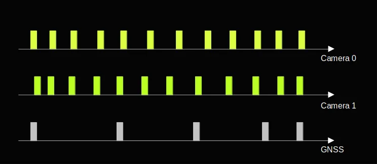

Data drop issue
The aforementioned example operates under the assumption that ZED camera data is reliably accessible at every synchronization trigger. Yet, in networked operational setups, network-related problems can arise, resulting in data drops. To mitigate this challenge, a timeout mechanism has been implemented for the camera’s data source. This mechanism allows the exclusion of a camera source if no data is received during a defined number of synchronization periods. Subsequently, data from the timed-out source will be re-included once it becomes accessible again. The following diagram illustrates this concept:
In the present version, the synchronization timeout can be customized using the timeout_period_number attribute within the InitFusionParameters class.
