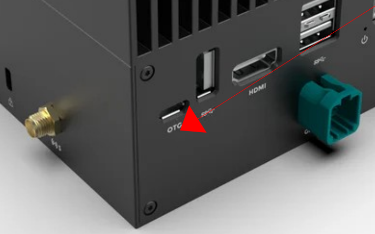

  • Connect a Micro USB cable from your host computer to the Micro USB2.0 - OTG port.
    Do not connect the cable before the device is powered on, otherwise the ZED Box Orin will boot in Recovery Mode.

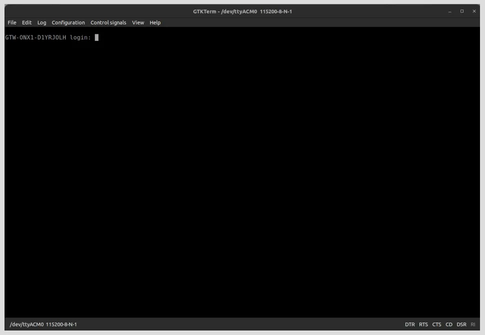

  • Launch gtkterm from the terminal with the appropriate device path (usually /dev/ttyACM0):
    sudo gtkterm -p /dev/ttyACM0

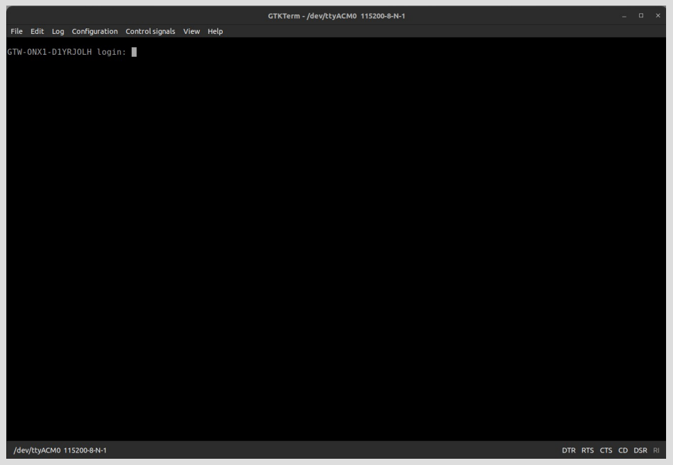

  • If the cable is connected just after the device is powered on, the terminal will display the boot messages as the device starts up. When the boot is complete, you will see a login prompt.
    If the cable is connected when the boot procedure is completed, the terminal will not display any boot messages; you may need to press Enter a couple of times to see the login prompt.

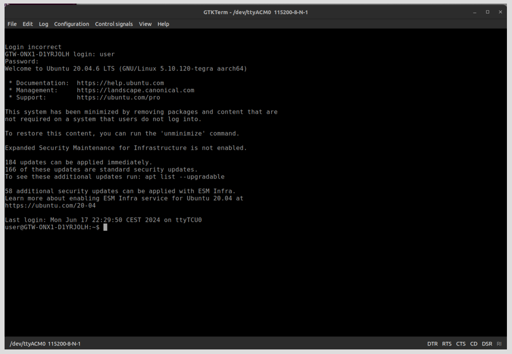

  • Log in with your credentials (default credentials: user/admin)
  • You can now execute commands on the device via the Serial Console in the same way as you would via SSH.
