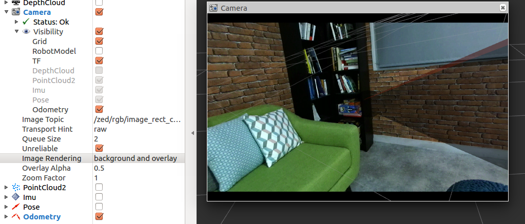

Camera
The Camera plugin allows you to visualize an image from a topic of type sensor_msgs/Image. It acts as if the source of the image is placed on its virtual frame and renders all virtual objects in front of it.
RViz
Key parameters:
  • Image topic: Selects the image topic to visualize from the list of available images in the combo box
  • Transport hint: Selects the type of compression from the list. Using a compressed image allows reducing the required bandwidth if the image is transmitted to another machine over the ROS network
  • Queue size: The size of the message queue. Use a lower value to reduce latency
  • Unreliable: Enables using the UDP network protocol instead of the default TCP protocol in order to reduce latency
By expanding Visibility, you can select/deselect what will be visible in the camera view. Only active plugins can be selected.

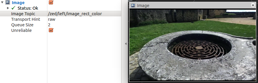

The Image plugin allows you to visualize an image from a topic of type sensor_msgs/Image.
RViz
Key parameters:
